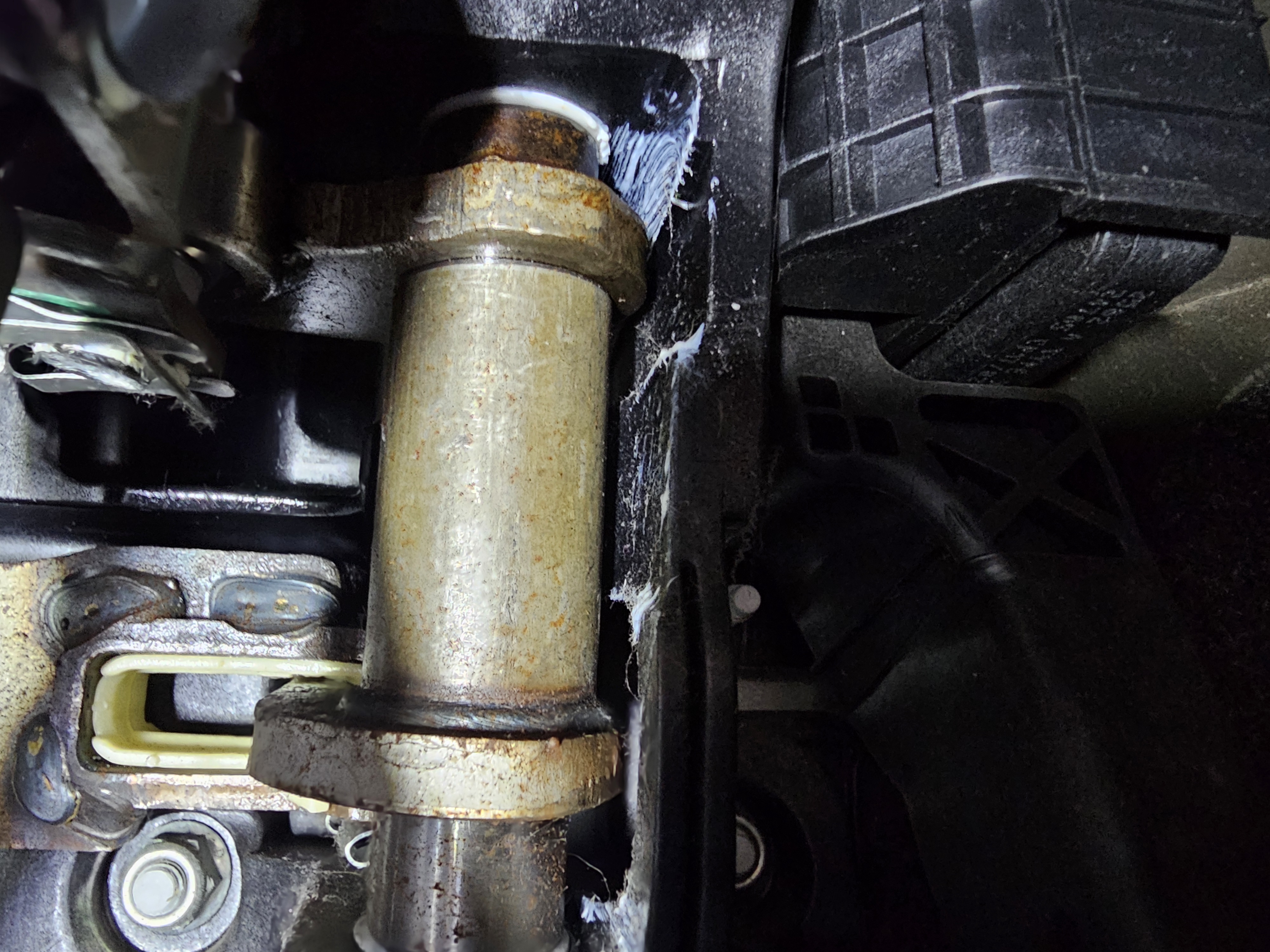

Is this hole at the base of the brake pedal supposed to be open or does it need a grommet?

To the left of the steering column lower universal joint, and beyond the end of the console trim panel, there is a vertical black rectangular bit of plastic which is the cover to the pollen filter housing (Fiat's idea of a very funny joke at the RHD vehicle maintainer's expense). Pre 2012 it clips in (lift up and pull out towards the steering column), 2012 and on it should be held by two quite hard to get 5.5mm hex-head screws (one right next to the steering column, on further up on the rear edge). At least that's what should be there, but if the cover has come loose or is missing you'll certainly get a draft up the trouser leg....
