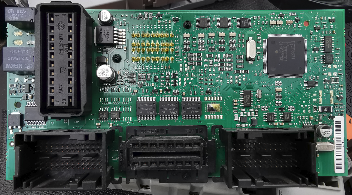

The nowadays vehicles, from the electronic point of view, are computers on wheels. FYI, this is how the BCM in my 2011 Ducato looks like in the inside:
The middle port on the bottom is the OBD2 port. So, this is what is behind the cab's fusebox.
