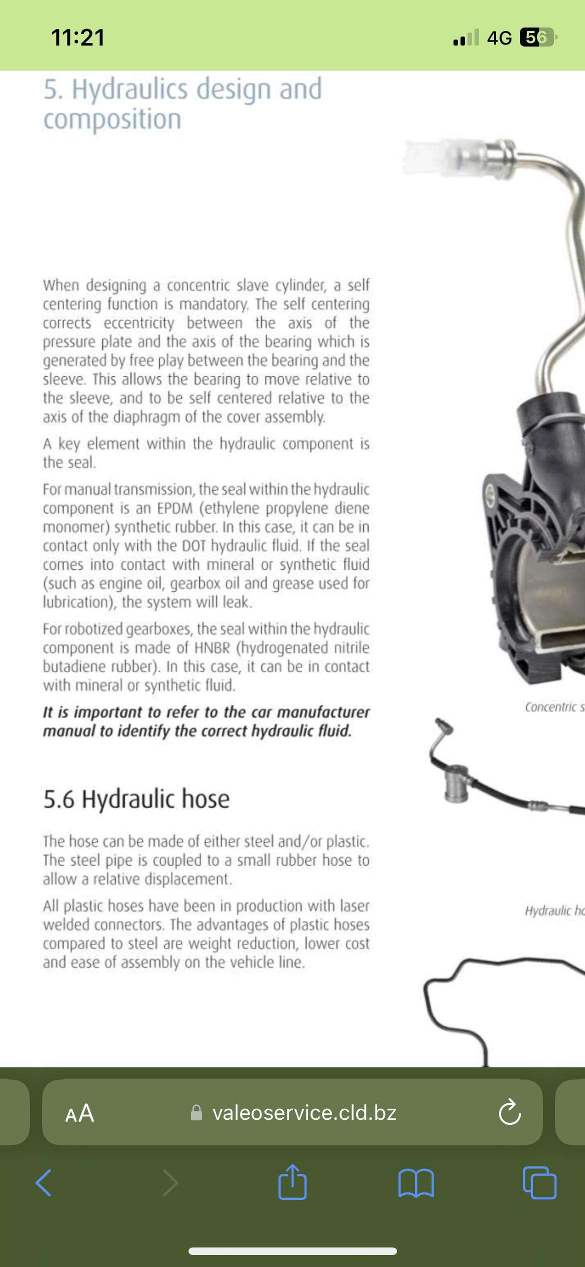

Which from the spiel implies that it's the same cylinder for both applications, but with a different material sealing ring for the two variants ?. I strongly suspect that Valeo do not make sealing rings, and that they bought them in from a specialist seal manufacturer.
So, is it that simple that the correct seal needs to be identified and fitted, and then the problem is solved ?
Yes, it’s the solution.

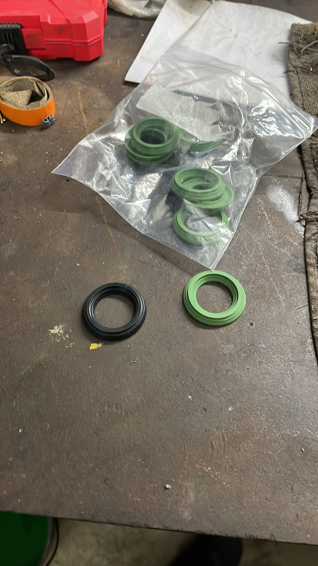

I am in the process of contacting a hydraulic seal manufacturer to make it for me, in HNBR Quality.
I send the photo and the dimension and i come back to this post 👍.
OK, so have you found the right gasket?
yes, I take the seal which is in the CSC for the manual version of the stilo abarth, it is exactly the same as the selespeed, except the composition of the seal. The company that manufactures the seal told me that it was OK for them, no problem making this type of seal. They contact me the middle of next week to tell me the price, knowing that they have to make a 3D plan on the computer to create the joint.. I hope not to get too expensive..
please can you tell us the dimensions of the gasket, internal and external diameter, thicknesses, etc., thank you
hello guys, I have good news, I received the famous seals, and they are mounted on csc other than valeo, because the design is different between other brands and valeo, but the purpose is there same and the csc of other brands are therefore less expensive than the Valeo brand, so everything is beneficial. I was able to repair my stilo which had been broken for 3 months because of a leaking csc. Now it works perfectly. I'm giving you the photos of the seals, but for the dimensions on the other hand, it's complicated, because the seal manufacturer made a 3D plan to be able to manufacture it. I only have dimensions that I measured with my caliper, much less precise than with the manufacturer.

All in all well done, and a good engineered fix. I note the 'green' materiel which I guess is the same as that used in Aircon O rings etc in place of standard black rubber ones.
At the end of the day you have a working car and some spares to sell if you wanted, all for a price probably less than that which a garage would charge for just taking the gearbox out and putting it back in without doing any more.
Noting that an original Selespeed CSC would be expected to do 'n' years and 'x' 000's of miles, I do hope that yours will do the same. It would be interesting for you to report back after a time to confirm the life of the part.
