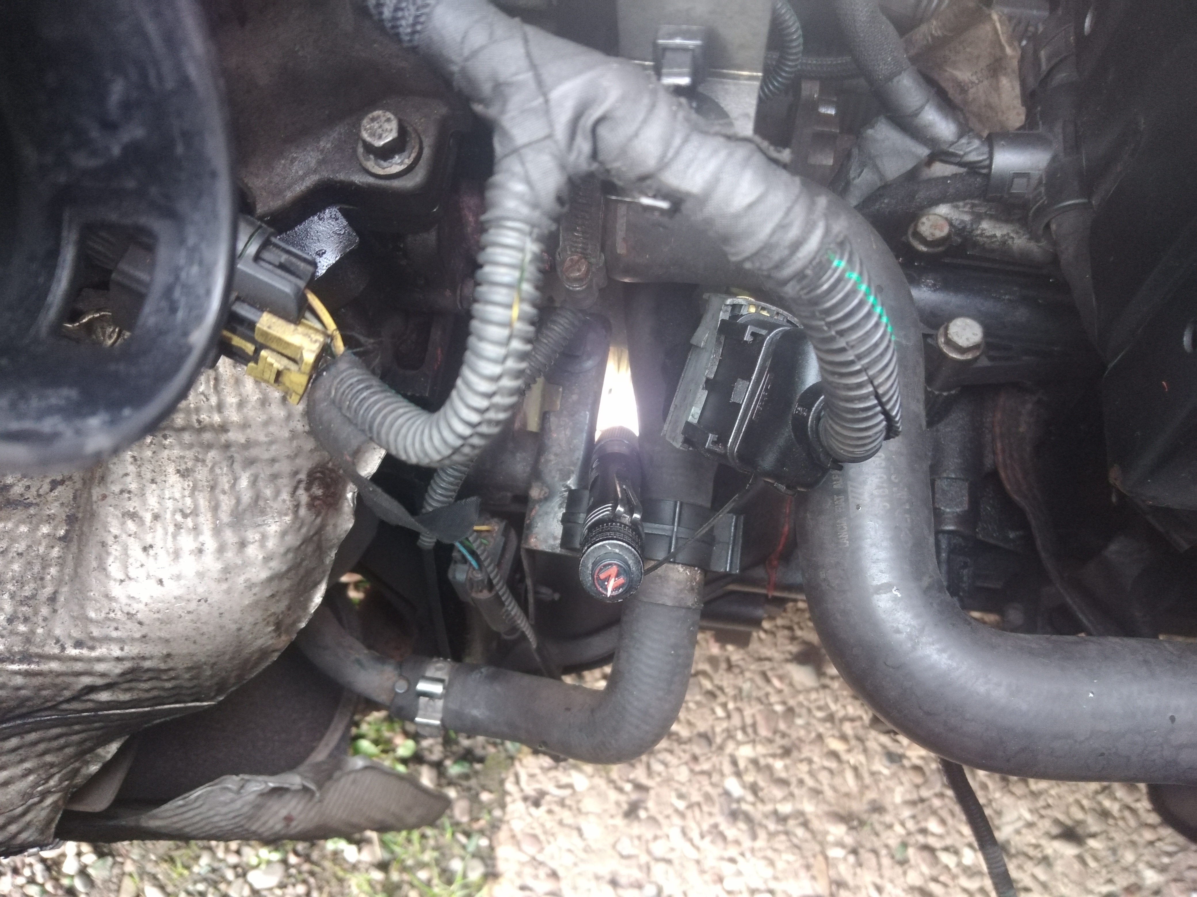

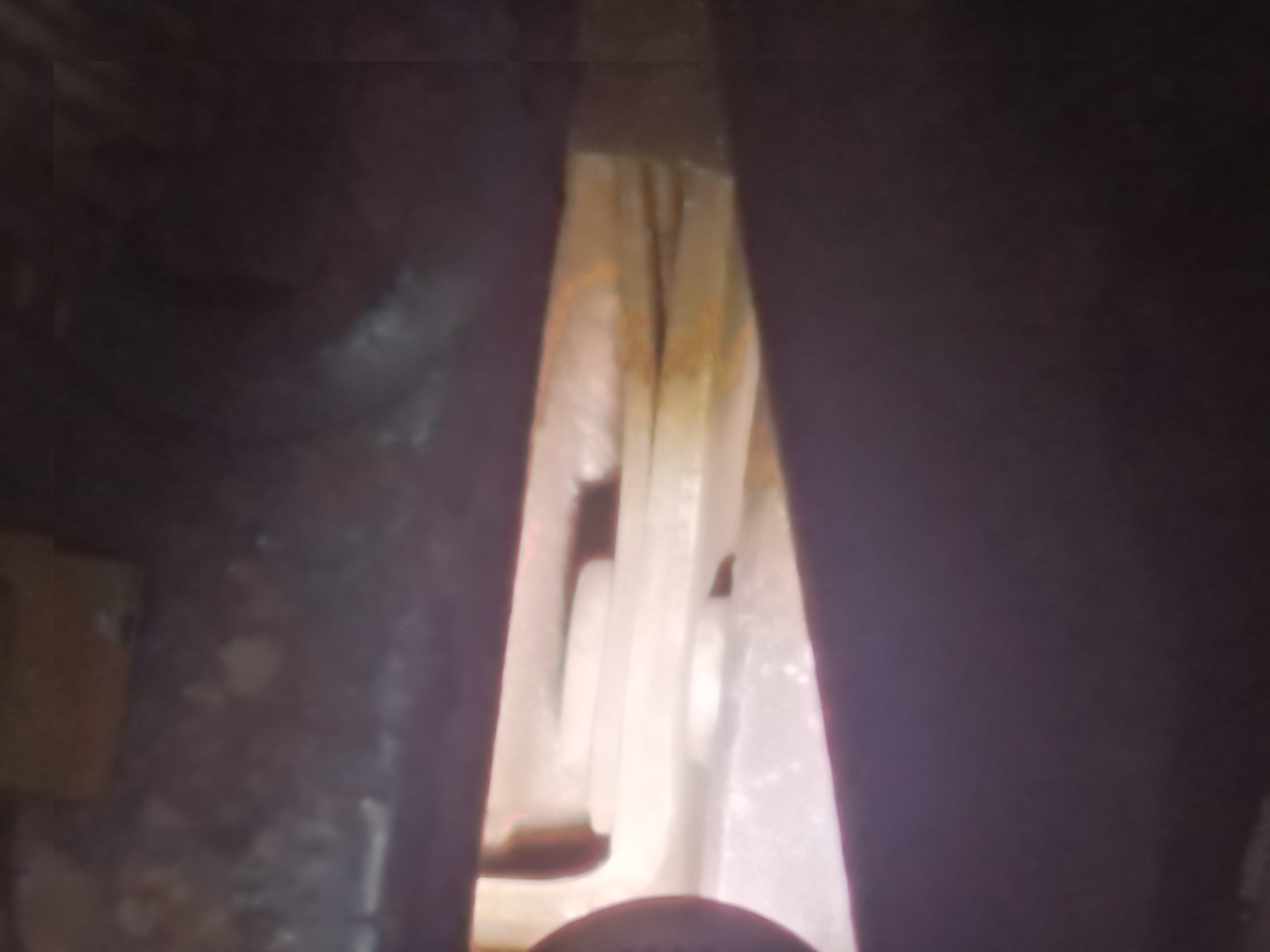

I'd start by checking in here
You can see the clutch pressure plate here, should be dry and red/dust, not black and oily
Engine not running of course, feel the inside is it oily
You don't have to remove anything, unless it's got a plastic cover fitted, none of my three Pandas have, but it will be hidden under pipes or wires
Take less than a minute to check, hopefully you can move straight on to the next check
