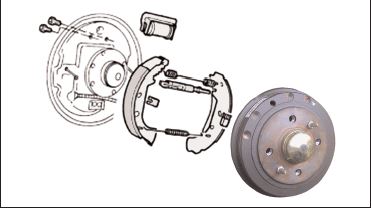

For the adjusters I don't think mine has them on the drums. But if someone could tell me what it looks like I would be greatful as I've never had a car with drums like the punto
I was going to direct you to the link to the Haynes manual at the top of the sticky section but unless I'm going blind the braking section is omitted. Anyroad the adjuster is about the size of a pen and sits under the cylinder betweeen the top of the two shoes, I'd say if you poked around in the guides section you would find a good picture.

On mine,the Adjuster is more or less hidden,
on the spline part you adjust there is a metal flap covering it,
if no adjuster,then how wouid this be meant to be set up,
icarnt see adjusting the cable taking the slack out of it or push the shoes out
to the required distance,
when you put the drums back on did they go on with ease or was there contact
with the drum and shoes?
they went on with slight contact. I just don't get it ive had it completely apart and cant find any adjuster on it. like in the photo its just a metal plate between the two shoes. maybe im missing something. could it be on the shoe its self.

Thank you Oldham mine is a 2001 but after inspecting the shoes again I found the auto adjuster never seen them on shoes before at first I thought they looked fine as the shoes had plenty of pad left intact they looked new but when I took them off and looked at the teeth on the auto adjuster they were blunt no teeth left just metal fragments.
So I have changed the shoes and drums and now have no noise at all just very smooth braking and 100% better braking power.
