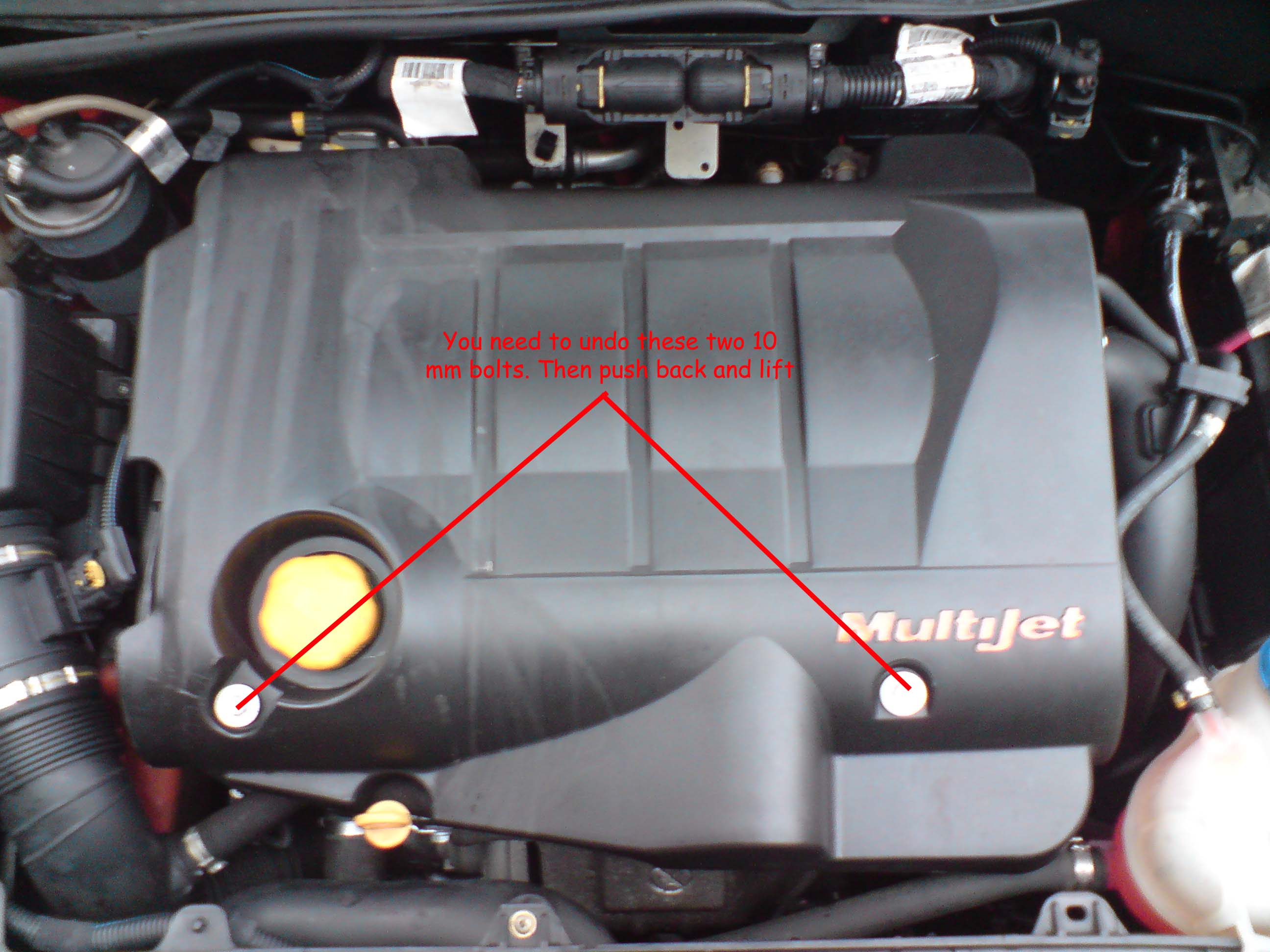

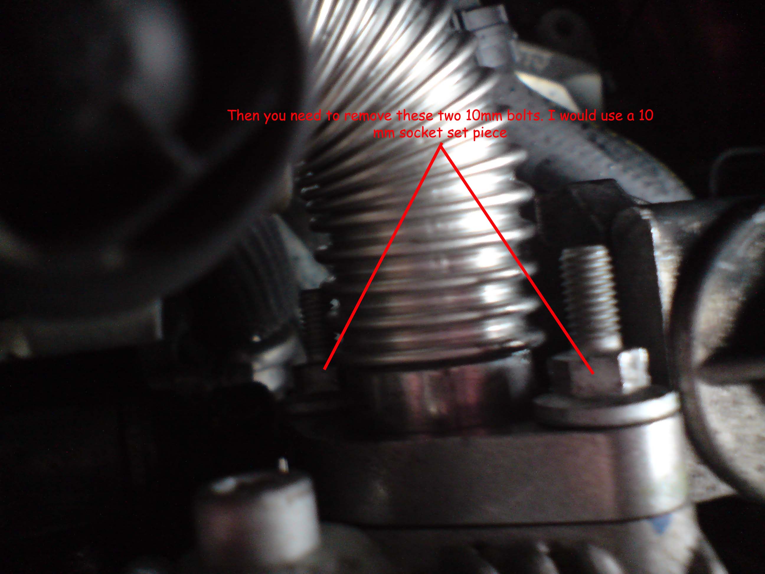

First things first is to remove the engine cover by the two 10mm bolts at the bottom. Then on to removing the 90 degree corragated pipe, first I would slacken the two 10mm hex bolts, then the two 10mm bolts (easier to use the socket set). Once slackened becareful of the metal seals at each end of the pipe. Once removed the pipe should easy come away, then your left with the removal of the EGR valve itself. On the left is a cable, remove this by slackening the yellow clip then pull off. Then you will see two gold coloured bolt heads and there is a third underneath the bolt on the left, undo these three with a 13mm spanner, they are quite long so dont worry about these falling out. Then you will notice a bracket that holds the valve to the manifold come loose whilst removing the bolts. Remove that with the three bolts. Then the EGR valve will stand on its own being held by another pipe below it. I removed this pipe too. If you follow this pipe down you will see it being held by a single 5mm bolt with a support bracket, undo this and the pipe will come free. The pipe will need a good clean, mine was clogged up.
