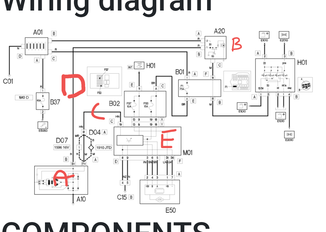

You will not get battery flicker due to bushes on most fiats(500, panda, doblo and so on)
The battery light light is computer controlled by the body computer, not like old bulb types except for a few emotions on older petrol vans
It only come on when the D+ falls below approx 5.5V and the ECU detects a crank signal over 750 rpm
In most case, even when it's not charging, the light stays off until the battery is very flat, usually just before it cuts out as you hit the brakes and draw more current, loosing the 5V reference to the sensors, power to the BSI first and ECU shortly afterwards
A alternator
B starter
E body computer (BSI)
As of yet we don't know if
There is a break D
There is a break in C
If the BSI is sending the exciting current down C to the alternator during cranking
The battery light are a good rough indication of a grounding fault, should stay on as soon as the ignition is turned on, and should stay on while cranking, until the engine starts, if you turn the ignition off and back on and the battery light is off for a few seconds then block has gone hot above 5.5V, useful if you are sitting broken down without any tools, but the previous voltage drop test is better if you have access to a multimeter
A alternator
B starter
There is a break D
