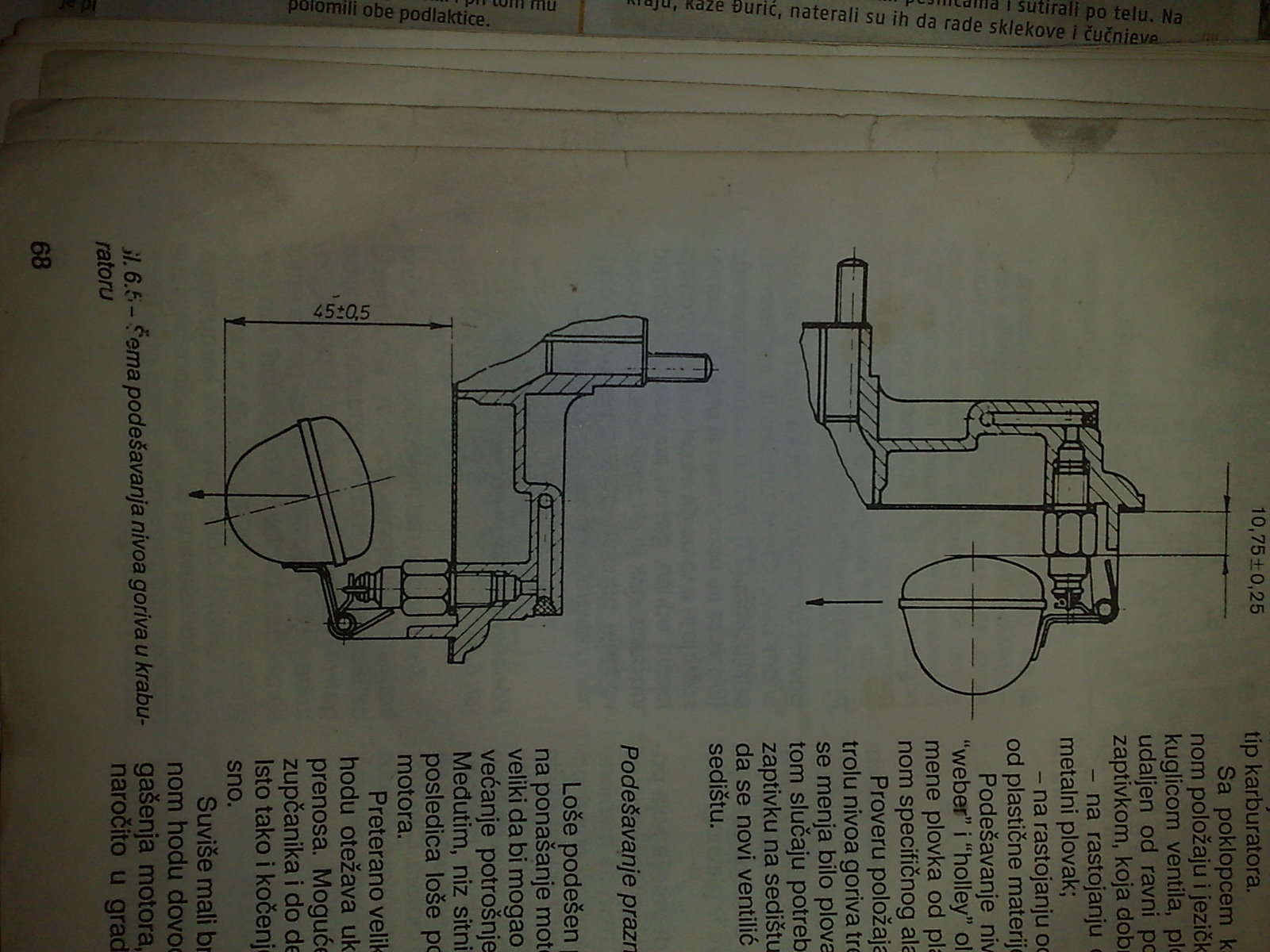

Hi Ice, here is pictures of IPM32 Carb *(licenced by Weber, produced here in Serbia). Ill try to translate position of your interest, just ask which number of position is of your interest...

Ice, just few recommendations from my experience:
Bad carb, first have to be disassembled fully, all vents have to be taken of, and all gaskets have to be removed carefully to prevent any damage. Then disassembled body of carb, with all brass valves, gaskets, springs and moving parts removed, have to be cooked for one hour in some old pot filled with water and sodium bicarbonate. That will remove any dirt’s and particles, oil etc, from carb-body and calibrated holes and tunnels in carb. Then you have to clean valves and valves-holes. Do that with copper wire, backhouse, copper is softer than brass, so you can prevent any damage to calibrated dimensions of the valve hole. (Valves is produced from brass, and if you clean it with steel wire, or similar which is harder than brass, you will damage vents and possibly increase calibrated dimensions. Be special patient with gaskets, because gaskets are very gently and easy to crack. You can use acetone (lackier removal for lady nails) - but do not contact acetone with any rubber or cartoon gaskets on carb, to avoid damage. Dry everything after cooking and before assemble.
Check the brass or plastic pontoon, to be without any damage and holes, because he has to float in exactly position, not too-low level (in that case pontoon will allow to much fuel to carb- keep the needle vent open) and not to float too high (in that case he will close fuel supply in main chamber too early). You have dimensions of pontoon position on pictures.
Check that injection pump-membrane is without damage. Check main mixture vent (small tube with lot of holes) is clean. Also check any gasket for the main body, because they have to prevent any air income between montage place - if so, you will have failure air, and can’t precisely make adjustments.
