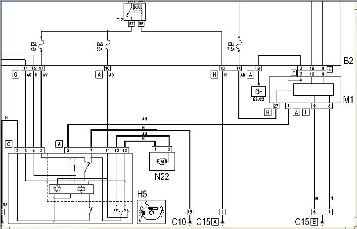

If you disconnect the feed from the body computer to the column wiper switch then it should turn off the rear wiper and only when you select reverse.
Pin 1 on connector A on the body computer to pin 3 on connector A on the wiper switch.
Whether it will go into a sulk if you do that I don't know:)

If you want something more permanent then you could try putting a switch in the line I mentioned earlier from the body computer to the wiper switch then you can decide whether it works automatically or not without affecting it's normal operation
N22 is the rear wiper motor
Try to locate the wire going from body computer connector A pin 1 to wiper switch connector A pin 3 as this line sends the signal for automatic operation of the rear wiper
