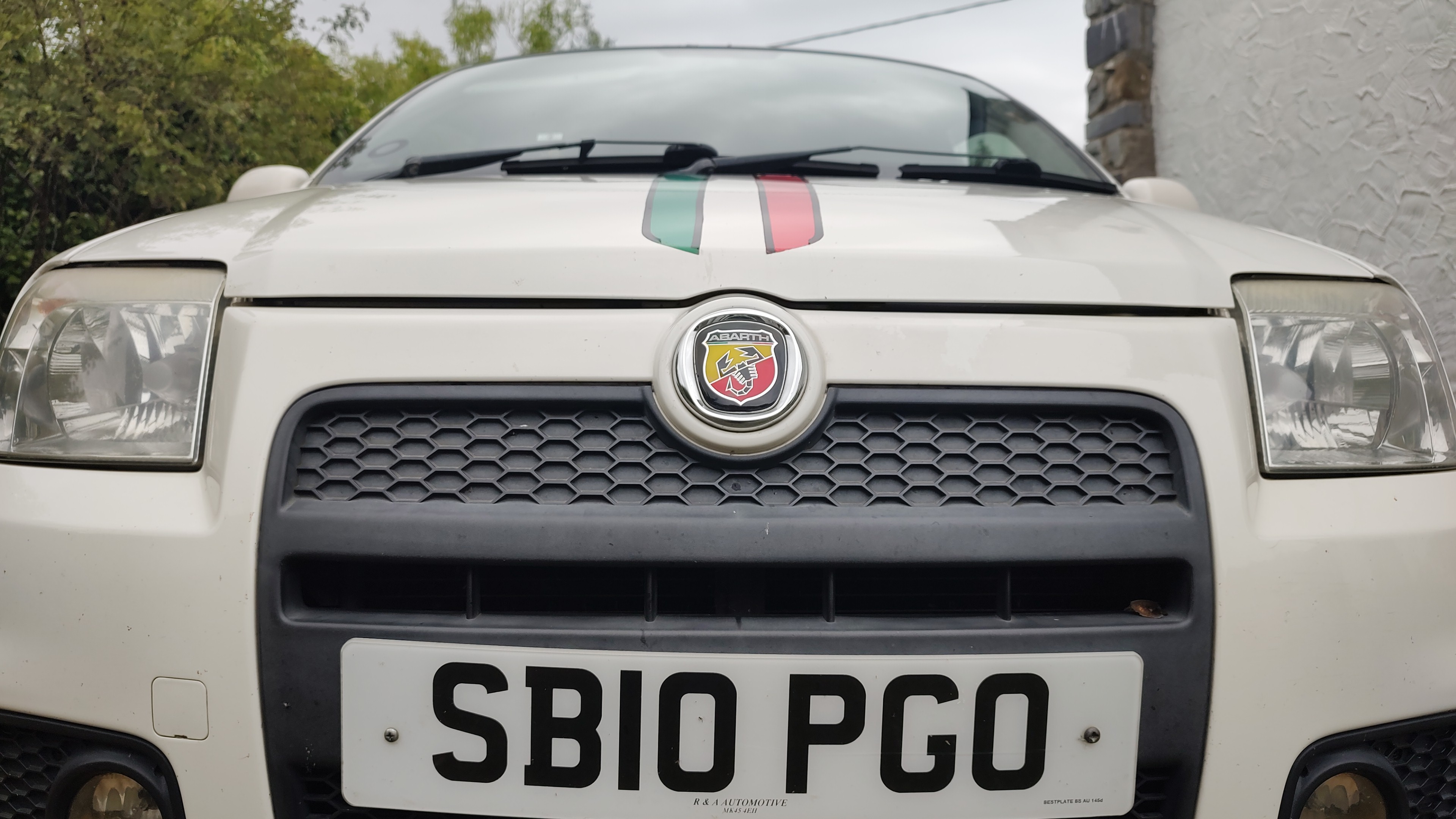

I have an early Fiat Panda 100HP that came with the old blue Fiat emblem, but I think in 2009, Fiat changed the logo to the current red emblem on the 100HP. Is it possible for me to change the emblems on the front and rear? If yes where and what size do I get for both as I'm confused?

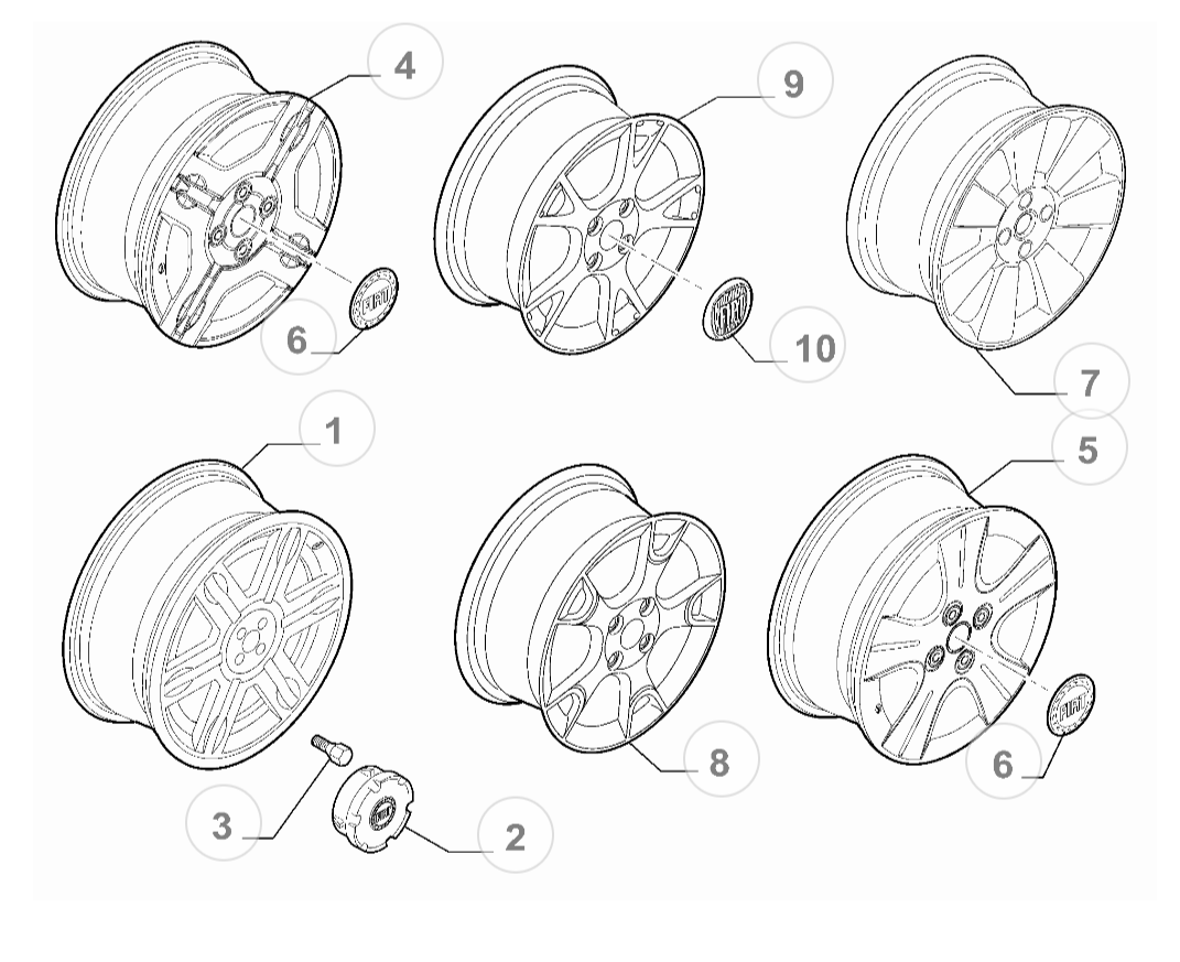

There's at least 4 different styles of wheel ornaments/centre caps on the 100HP
Two types are completely different part 2,6 in the photo below
I don't know if 6 and 10 are swappable
