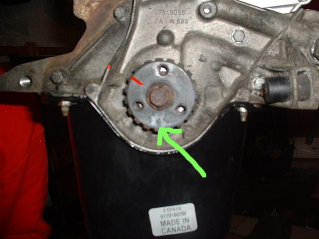

Thanks Arc, you say the aux sprocket has an indentation and should line up with a similar identation on the crak pulley. Are they supposed to be in the same position (as in a clock face) or pointing towards one another?
I've reassembled the alternator pulley on the crank sprocket after i'd aligned the timing marks (i tried to make a similar mark on the alternator pulley, should i align the crank timing mark 1st or is there a way of doing it AFTER the alternator pulley has been re-attached?
allign the crank first.
the marks on the aux pulley (ive made the assumption you were calling the altenator pulley the aux puelly here) line up at the same posistion as the mark on the crank pulley. the alternator pulley has an indent on it, where as the crank pulley has a raised bit - so the only way it can really fit is in the correct place, but it is easy to put it in the wrong place if ur not wathcing!
Ahhh, no sorry, if you look at the haynes manual, the aux pulley/sprocket is the small sprocket in between the cam sprocket and crank sprocket, almost opposite the tensioner.
I'll call the crank sprocket, the toothed sprocket, on the crank that the timing belt goes around and the alternator pulley, that attaches to the crank sprocket. So i align the crank sprocket up correctly with the engine mark, then the indentation (small 'nick') on the alternator pulley with the same mark as on the crank sprocket (say 10 o'clock). The cam sprocket at half nine ish (ignore the flywheel) and the aux pulley ??????

I'll call the crank sprocket, the toothed sprocket, on the crank that the timing belt goes around.The alternator pulley, that attaches to the crank sprocket. So i align the crank sprocket up correctly with the engine mark, then the indentation (small 'nick') on the alternator pulley with the same mark as on the crank sprocket (say 10 o'clock). The cam sprocket at half nine ish (ignore the flywheel) and the aux pulley ??????

The little indentation ('nick') in the alternator pulley, does that sit at the same angle as the timing mark on the crank sprocket (10 o'clock ish)

The indentation on the alternator pulley sits on the tiny raised part of the crank sprocket. Ive circled it in green on the attached photo.

With the crank and cam pulleys alligned properly, and with the alternator pulley on and in the correct place - it should start up.

Woo Hoo !!!!! I took off the alternator pulley, and noticed i'd put that on inccorectly, also i'd mis-aligned the crankshaft pulley !!! After i'd ligned up the sprockets to the correct timing marks it took me well over half an hour to get the timing belt on correctly, but hey, 1st turn of the key and she fired. It's the 1st time i've done a cartwheel since leaving school, my neighbours thing i've lost it !!
