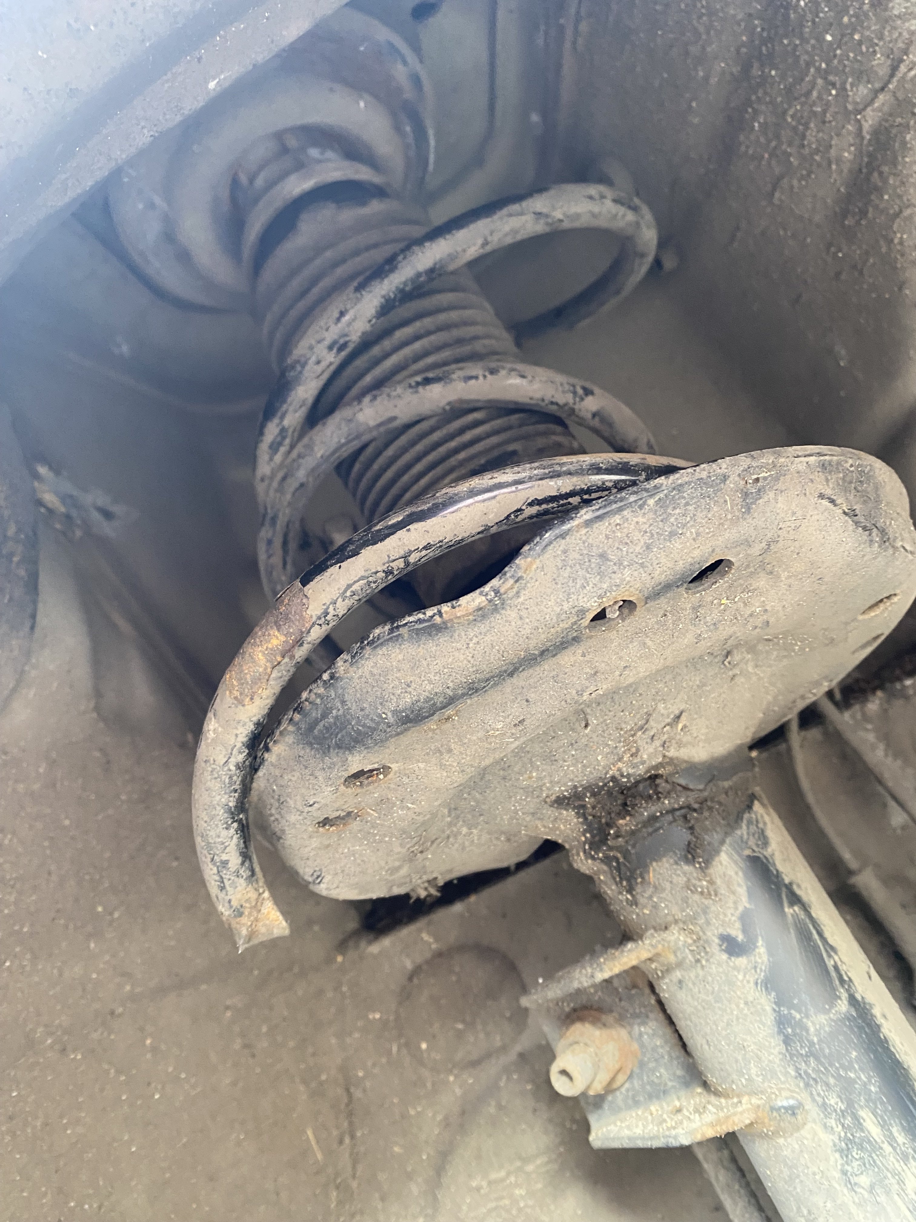

I just took a family member to the train station about a mile away and began hearing clunking noises coming from the front right as I approached the station. I limped back home and the clunking got much worse. Jacked up the car and found the front right suspension spring broken. I can get it replaced but just had a few questions - should you always replace both front springs and will I have damaged the shocks or any other component driving it for a mile and a half? The front shocks are fairly new. Also, should you pay a bit more for premium springs?

Some say you should do in pairs, but I've done just one in the past without issue, I bought Monroe but it's snapped at 6 years old, there's some on Ebay for £22 delivered that's what I'm going with.
Mines snapped at mo but I still drive it where its broken isn't a huge issue, you cannot drive yours at all.
Shock should be ok

Thanks for the reply. I just tried to remove the strut but got stuck on the first stage - removing the top hat bolts. Seem to be rusted on despite the shocks being replaced recently. I’ve tried removing the bolt with an Allen key/box spanner combination but it seems stuck on. Do you have any tips on how to remove as a DIY’er?

I used an electric nut spinner..
Saves A LOT of grief 😉

Thats gone fine style, check the back of the tyre they can damage the side wall,
replace that one and see how it sits on the road and drives.
Can’t replace. Can’t get the top plate bolt off despite the shock absorbers being relatively new. Got to get a mobile mechanic in. I’m tempted to tell this mechanic not to tighten them too hard in case I need to get them off again in the near future.
I’ve now replaced rear shocks, front shocks, lower front arms and now a front spring has gone. I can’t remember having a car that required so much work on the front suspension. I guess it’s a city car that requires a full suspension overhaul at around 50k miles.
