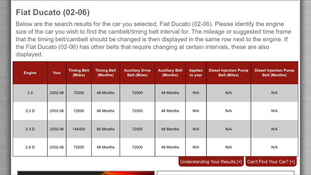

Also what is the recommended replacement intervals for cam belts on this engine with my usage?
