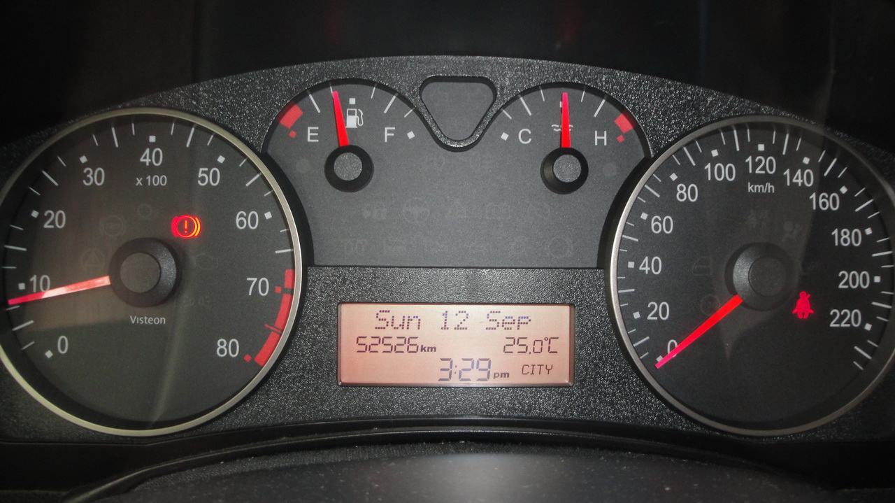

Well, changed the battery and still get random BRKE Light Failure on the dash. Really annoying, don't know what do do anymore.
Thing is, brake lamp is working just fine, with or without the error on the dash. What's wrong?
EDIT: I wanted to go downstairs to take a picture of the dash with the error on, started the engine, error gone. What about the 3 clean starts policy? :slayer:
Are you really sure some lamp hasn't burned out.. cause I used to get this message just the same way as you are.. fully random.. and as it turned out the two brakelights on my boot hatch were gone and I used to think they are just for decoration :) I replaced them and have never gotten the error message since..
Pretty sure man, I've checked them all over and over again. The lamp was always on when pressing the brakes and everything was working fine, just beeped the hell out of me each time I was starting the car.
I still think it's high resistance in one of the bulbs and will change both of them, just that it's my fathers car and it's now at the repair shop for a broken rocker cover (the cover on top of the camshaft). :) Mine doesn't get this fault.
