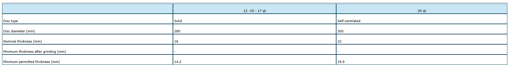

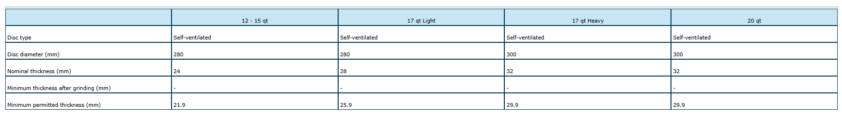

According to the official technical specs:
Front ones:
Rear ones:
The 1st line is some kind of payload, but depending on the body type. Calculating from the base van mass I think. So has nothing to do with the payload in the registration certificate. The qt stands for quintals. 17 qt is 1700 kgs.

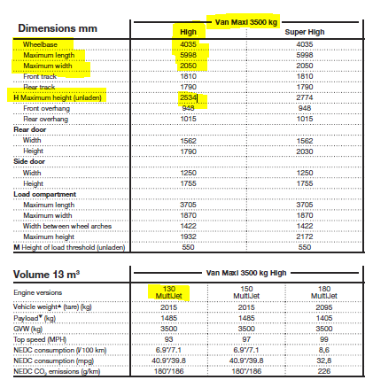

Looking at the specs of a similar model here:
and at the specs in the x290 catalogue from the download section I see that the van is most probably this one:
However this table says Payload 15 qt...
Which will probably be a Maxi (heavy) chassis L3H2.
Can you check the identification plate under the bonnet? It should give you the GVW in the first line just below the VIN. In my opinion should be 3500 kgs.
