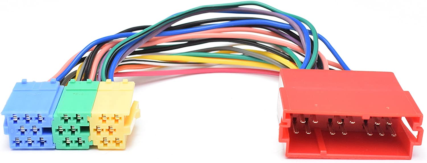

I will have to find another way… I think I’m going with one of these: BlueMusic Adaptor Bluetooth FIAT 500
get one of those, so come back and tell us how you got on, as with blue and me units failing all the time now, an alternative like this would be useful to many people
Received the Bluetooth receiver, but need an adaptor cable as the Fiat 500 with Blue and Me has a one piece plug.
Video Link:
All assembled and working great!
The device mimics a CD Changer, and immediately after connecting it, it's recognised.
It works by selecting CD Changer with the CD key (now the option is available).
The controls in the steering wheel work perfectly.
Sound is a bit low but not too bad.
The display in the radio is useless as the radio thinks it is playing CDs.
The install is easy and the tools to remove the radio are included.
To minimize any noises I removed the blue plug:
This is how it looks like:
