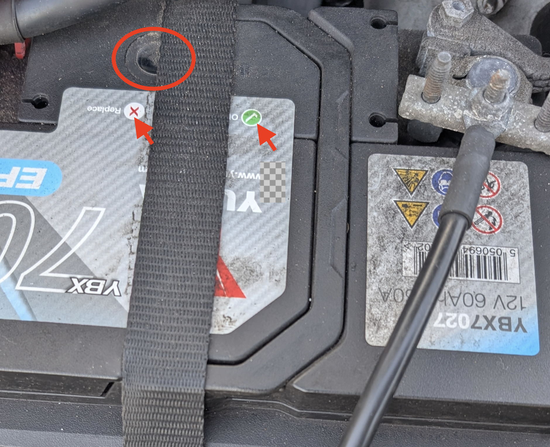

This is what's on the side of my battery.

It may or may not be the cause of your problems... but either way that's the wrong battery for the car :)
The correct one (for a Panda 1.2 without stop/start) is type 002: for example, these: https://www.tayna.co.uk/car-batteries/types/002r/
Usually, a failing battery shows as a series of other warnings first -- but things your car doesn't necessarily have: Stop/Start not available, issues with Hillholder or ESC, and ABS errors (you will have ABS). To get warnings related to seat belts and airbags first might suggest the issue is elsewhere? On the other hand, the battery sitting at 12.2volts shows it's not happy and maybe worth changing as the least expensive part that might solve the problem.

Just spotted: your battery has a built-in 'health check' window, circled in this copy of your photo. If you look into the clear plastic disc here you should see a floating green ball fully filling the clear tube. If it is not fully visible (there's a black area around it), or not visible at all, the battery is failing for has failed. The symbols, part covered by the battery hold-down strap, relate to this self-check window.
Battery looks fine I think...
