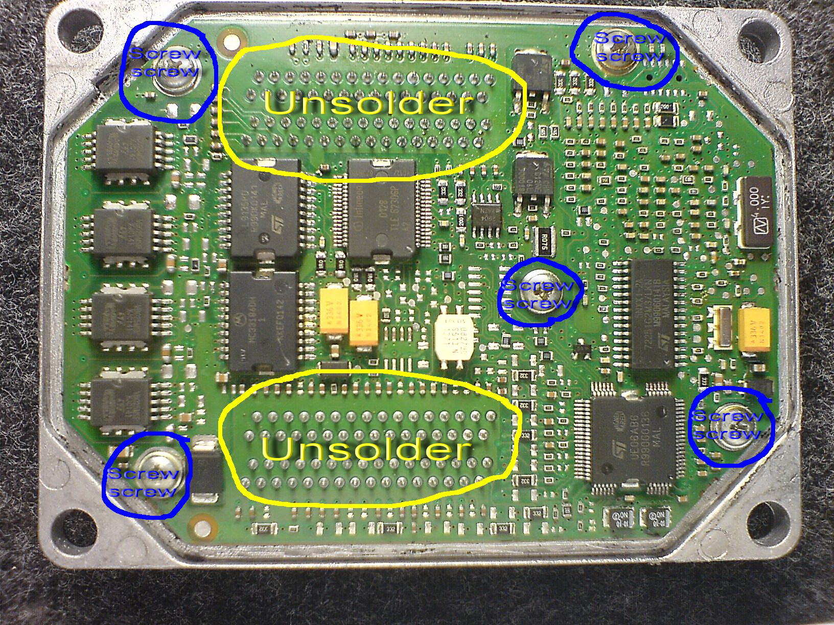

Reballing ECU processor

Of course, the poor connection or open circuit can be inside the ECU and that's where reballing comes in

First you could try to repair your old ecu.And that will 99 % solve your problem.In fiat garage they never do that.All they can do is to sell you new one for 800 euro.Repair is cost 200e here(Serbia) and car is like new.No more asr failure,security failure-loose connection in my stilo:slayer:No more any mistakes and beep,beep,beep:)
