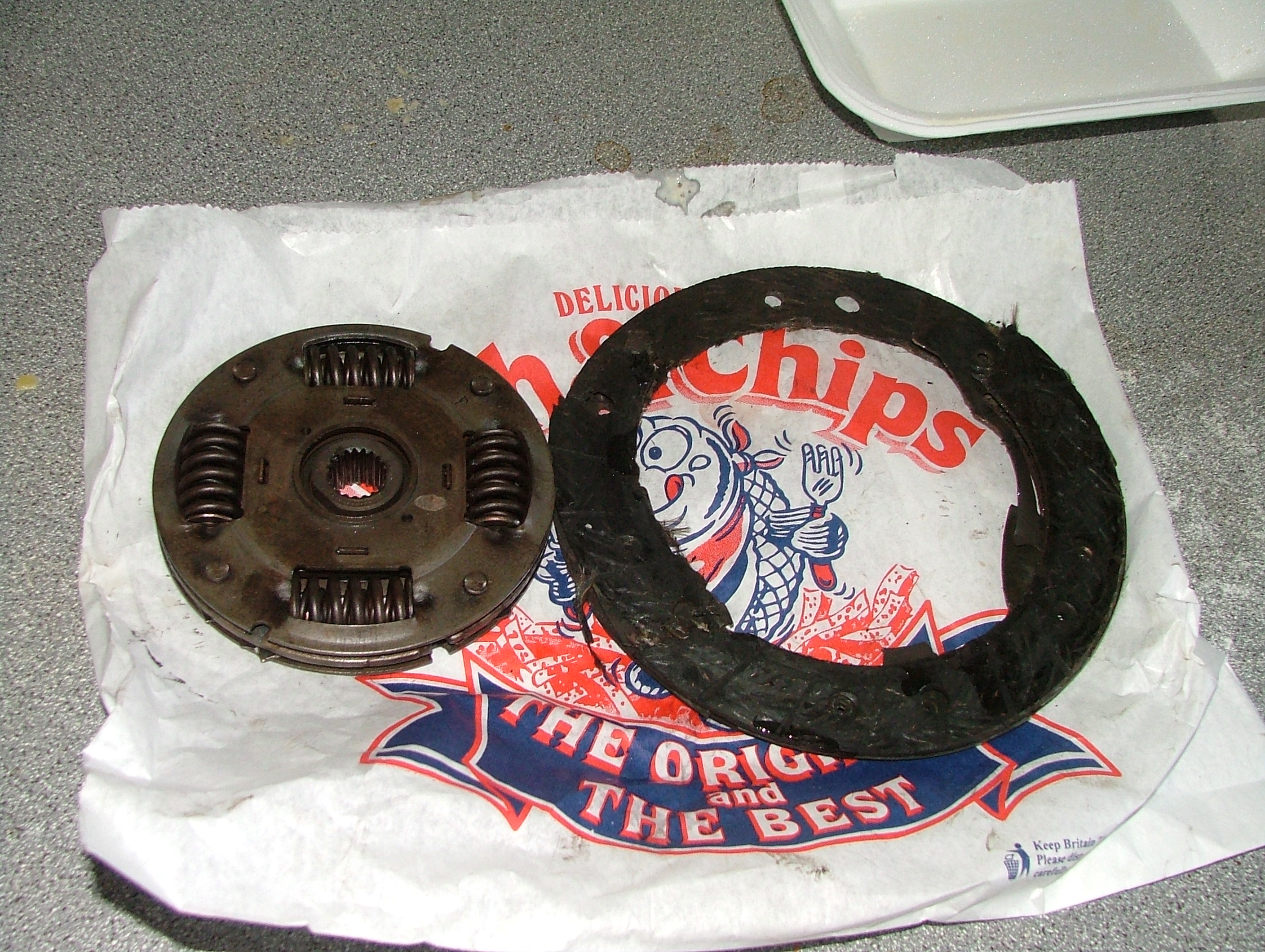

best way to fit that ring back on, super glue, 2 part epoxy resin or tiger seal?
on the plus side, the chips were nice :)
i'd go with duck tape or maybe no more nails lol
done a proper job on that!
no idea but atleast your playing on the safe side by fitting a different box.
