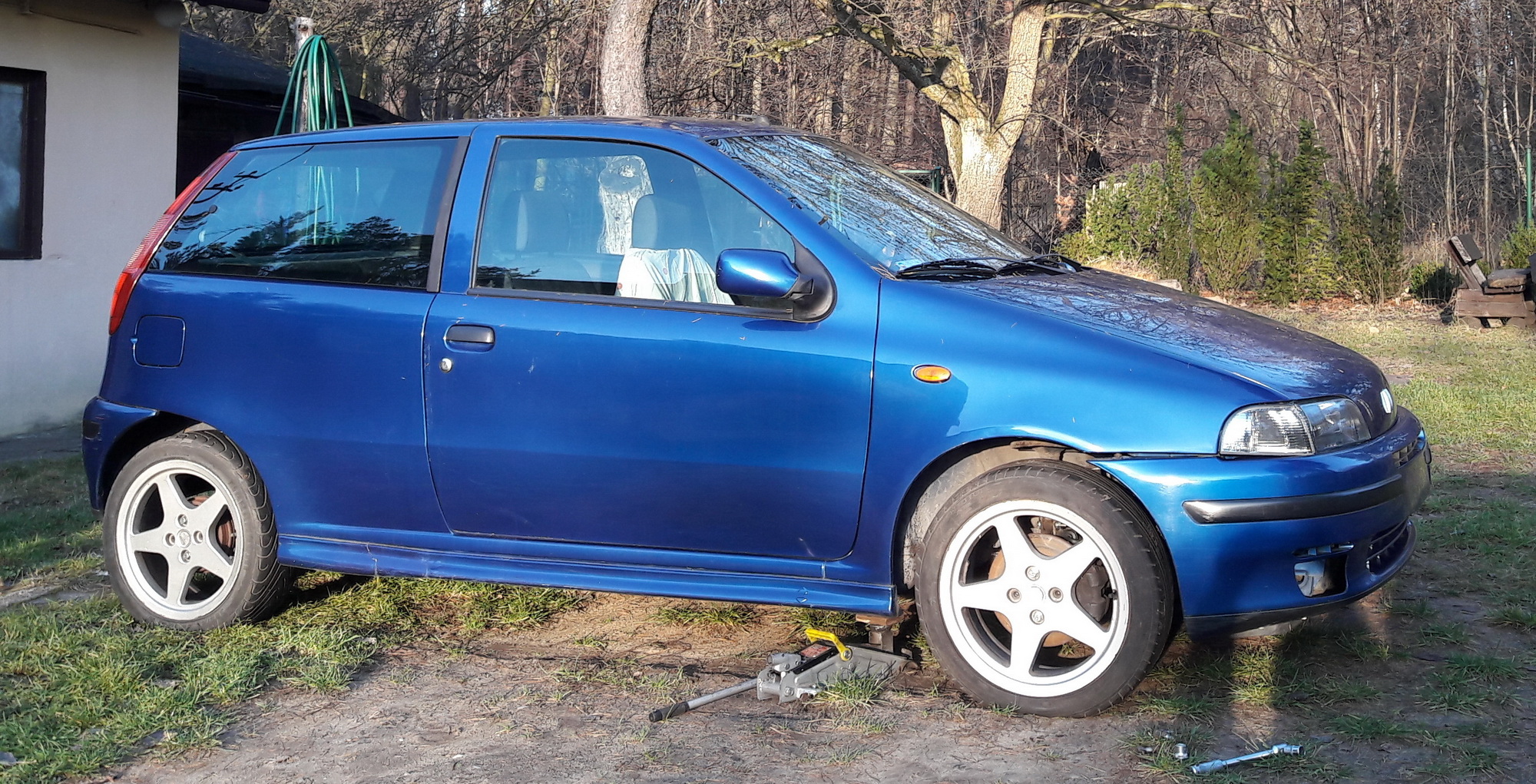

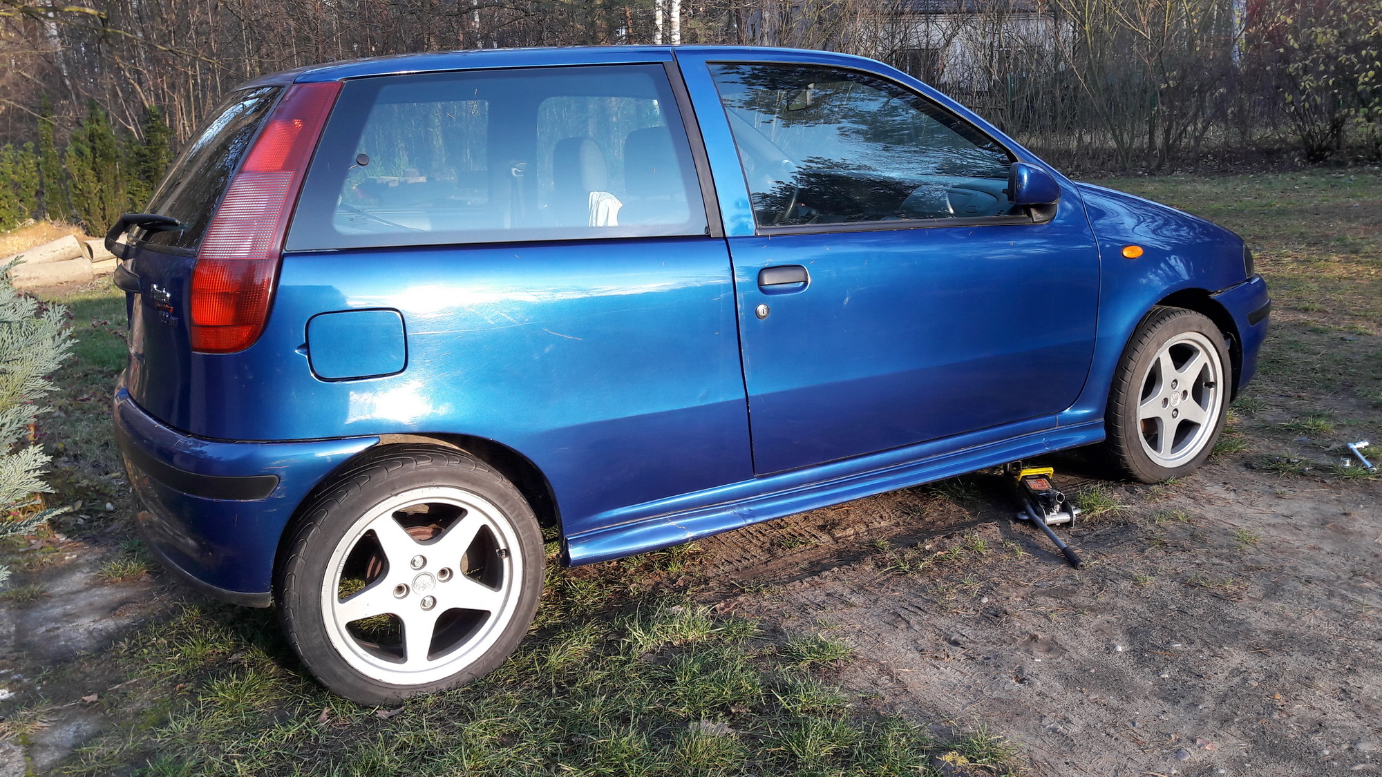

Hi,
I need to change the suspension in my Punto 1.4. I plan on using Bilstein B8's with Eibach Pro-Kit springs but I'm worried that I won't get rid of the front-higher-than-rear look. I checked the catalog and there are two kits available: E3025-140 for the 55 and E3013-240 for everything else. Allegedly they are both -30 mm but which kit will be lower at the front?
I don't want to slam the car, handling is more important for me but it will be nice to get rid of the comical high front look also. Maybe you know of a better spring kit than Eibach in that respect or maybe they don't have such problem at all?
