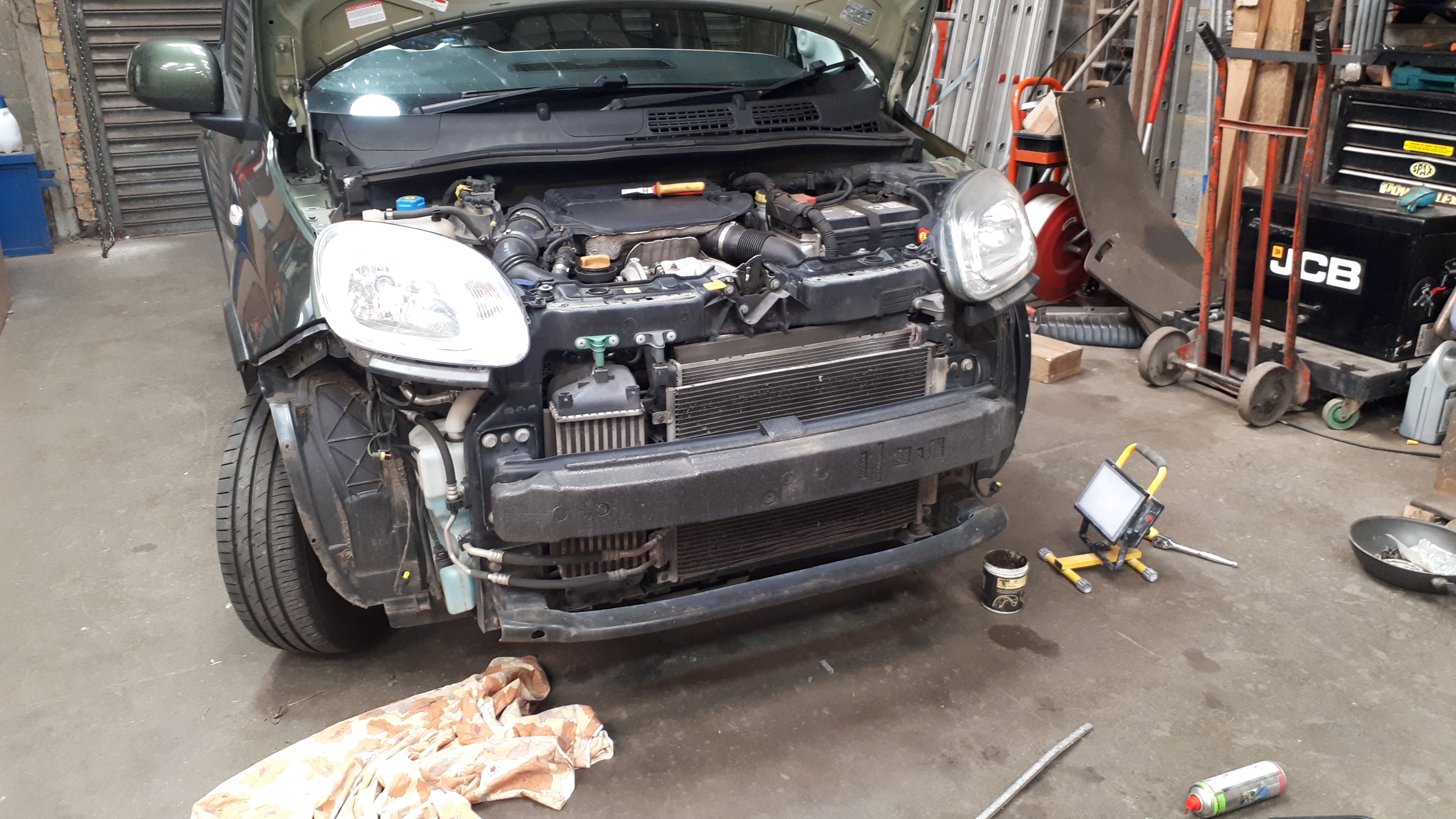

Well at long last I have got round to changing the trim on the front bumper, actually did it at the end of July, with a little help from my sons.
I will start by saying that this was a pain to do, you definitely need more than one pair of hands, a reasonable space to work, a soldering iron and an old quilt. The hardest thing was to get the bumper off in the first place, thought it would break before it came off, so much for the "gentle" tug, you have to yank it out. The other issue was the fact that the part I wanted to change is tucked behind another trim. We tried a stanley knife, a carbide burr on a drill and finally the soldering iron to release the old trim. The soldering iron was the way to go, melt the existing welds and pull the old trim away, then clean up the slots in the bumper with both soldering iron and the carbide burr.
Fitting the new trim was not easy, it would not tuck behind the large centre piece that easily and we did not want to release to many welds. You need to give enough play to get everything in place before you start re-welding. You also need another pair of hands to hold the parts in place whilst you melt the tabs to form the weld. We added some prolyprop welding rod as well for good measure. The corner trim went quite well, but the trim over the wheel arch sticks out a bit, it really needed a new one but we reused the original.
