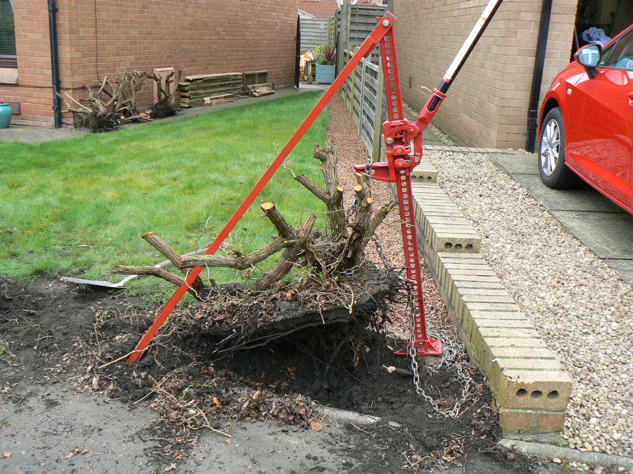

I decided to look for some way of applying a pull to the slug without having to dig away so much of the surrounding earth and decide to try a "Farm Jack" - I'd been looking for an excuse to buy one for years! In the end I decided to buy the best quality one I could find and bought this one, which was on an offer at the time: https://www.paddockspares.com/pm684-4ft-hi-lift-jack-all-cast.html and it's a really good and robust piece of kit with all the parts available separately if I ever break it.
The idea was to dig round the top of the slug until I could loop either a chain or my engine sling around it and then just pull it out. The first time I tried it I couldn't stop the jack falling over - the forces involved tend to pull the jack over and you just can't resist with the human body. so I welded up an "A" frame which you can see in some of the illustrations to follow. Now with the jack secure the concrete crumbled before any movement could be seen and it was then that I fully appreciated how much suction there is due to the slug being such a good fit into it's hole. Before my next attempt I procured (inherited) a very stout, 5 ft long, "podgering" bar and fell heir to a long length of 1 inch section Rebar one end of which I welded a piece of stout "T" section to and sharpened a chisel point on the other. Here is a picture of the "A" frame, Jack, Rebar, Podgering bar and chain:
So next I tried ramming one of the bars down the side of the slug and violently wiggled it about. Then did the same on the other side and, just for good measure, did the same on the sides at right angles to that (ie, loosened on 4 sides) Now with the chain wrapped round the top of the slug, and the slug itself loosened in the hole so there is no suction effect, the jack was able to pull the slug cleanly up out of the hole, leaving a nice clean hole, not much bigger than the slug, into which the new post and concrete can be dropped.
Just to illustrate the jack in action with it's "A" frame, here's some pictures of it being used to pull up my neighbour's front hedge (he cut the tops off first):

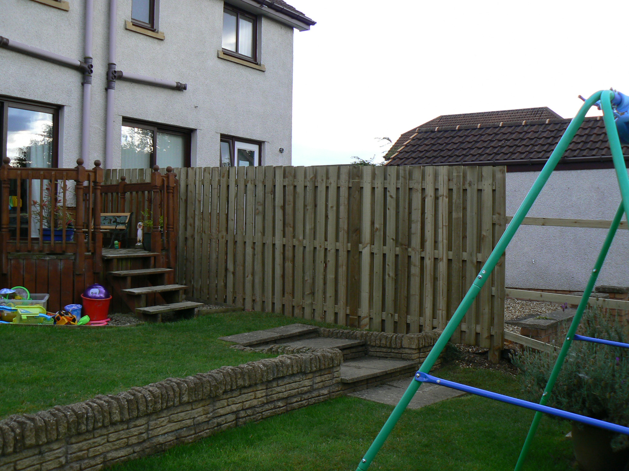

Here's some pics of the fencing I did at my older boys house shortly after he bought it.
We struck lucky with the preparation. The previous fencing was 3x3 inch posts holding up some really "nasty" very cheap panels. Starting at the house we pulled 3 concrete "slugs" from the ground and then realized that the centre distances on the new "scratch built" fence were going to be slightly longer than the 6 ft panels (dictated by the length of the horizontal spars) so we didn't need to dig up any of the other "slugs". That made things much easier. When I really got going I found I could dig one post hole in about 15 minutes or so depending on the ground and have the post centred and concreted in within another 15. Then a wee rest and on to the next. We had all the posts in and concreted with most of the spars installed on the first day and the rest of the spars and most of the vertical planks on the second. Completely finished, gravel raked back, turf relayed, and all tidied up before lunch on the third.
