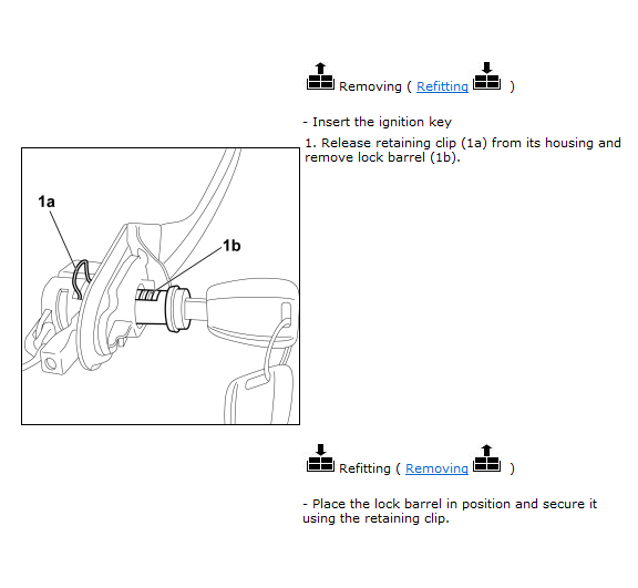

I have a broken drivers side door handle. Unlike the lucky people whose articulator was the only broken hardware, my complete handle assembly came out, leaving the small lock assembly in the door. I have the replacement part and my question is, does anyone know where I can find a video or how to take the old lock out and put it into the new handle, or has anyone had to do this? Thanks in advance for any info. I looked in the guides but did not see anything that addressed this particular problem.
It is the barrel that I need help with. I have scoured You Tube and found 2 videos on replacing the handle that are fine however neither address pulling out the lock mechanism and then putting it in the new door handle.

Not sure how, when it clearly states "This procedure only applies to Panda models. On 500 models, the lock cylinder appears to be integral with the handle - consult a Fiat dealer" :bang:.
Current generation Haynes manuals are all but useless, and IMO not worth the paper they're printed on.
The attached diagram may be more helpful.
