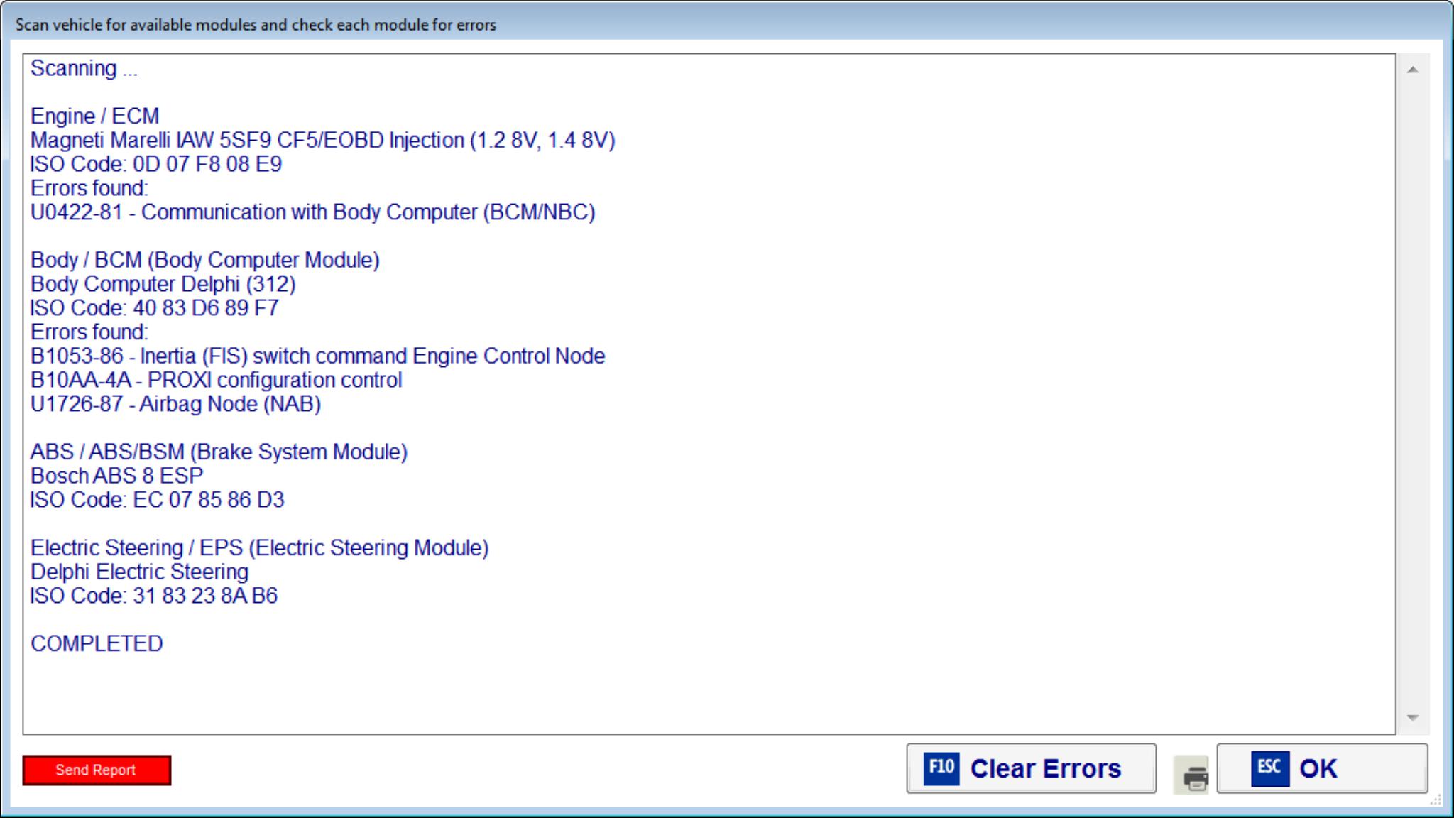

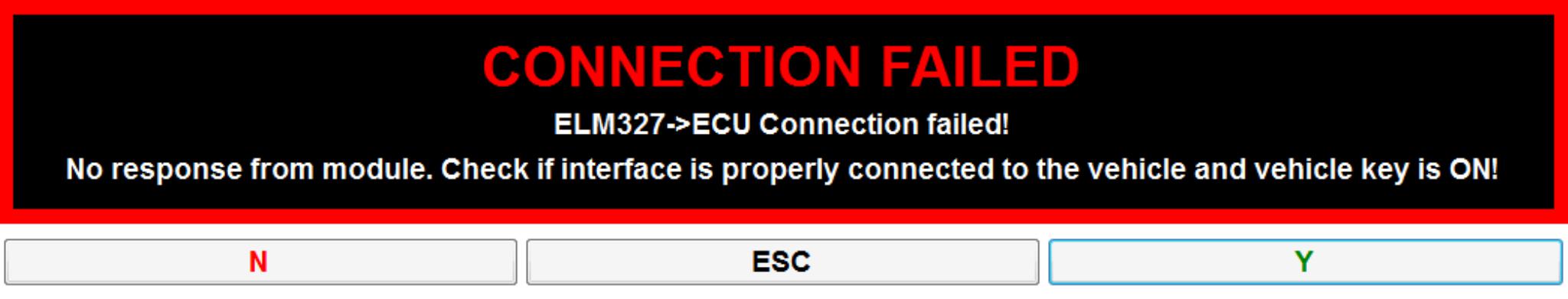

Brake light switch and OBD cables arrived today. Brake light switch has been fitted and has not fixed the issue.

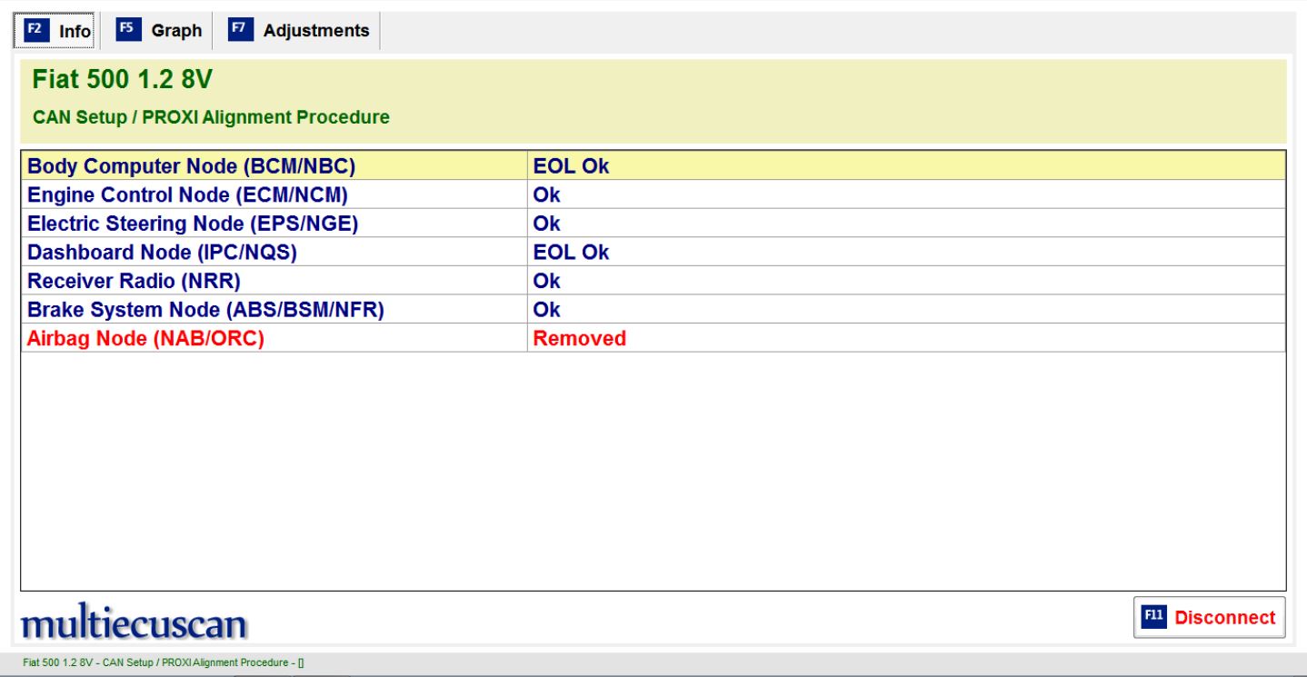

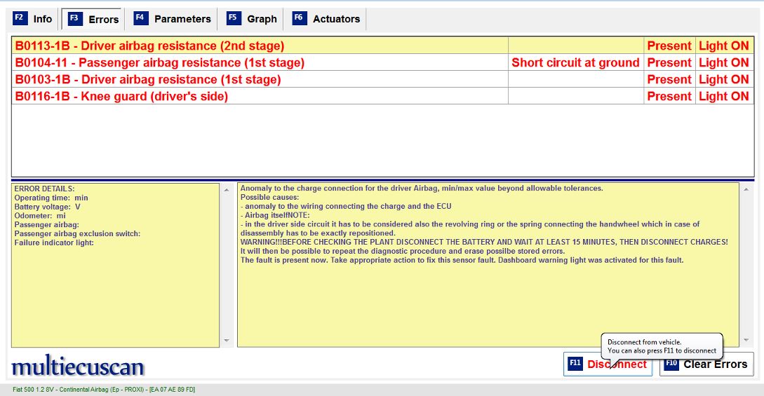

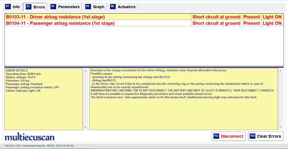

Connected the OBD cables and launched MES. Attached to this post are the screenshots, they seem to be fairly consistent with the other threads I've seen on here but if I'm reading it right the ECU is complaining of communication with the Body Computer, but then goes on to list errors on the Body Computer anyway?
The Connection Failed shot is from when I attempted to connect to the Airbag module with the yellow adapter cable attached. Anything else I can try?
ETA - added 4th picture showing the Proxy alignment screen (I didn't try it, but I read about seeing module status in there) - sure enough, Airbag Node is Removed but the Body Computer is alive and well.

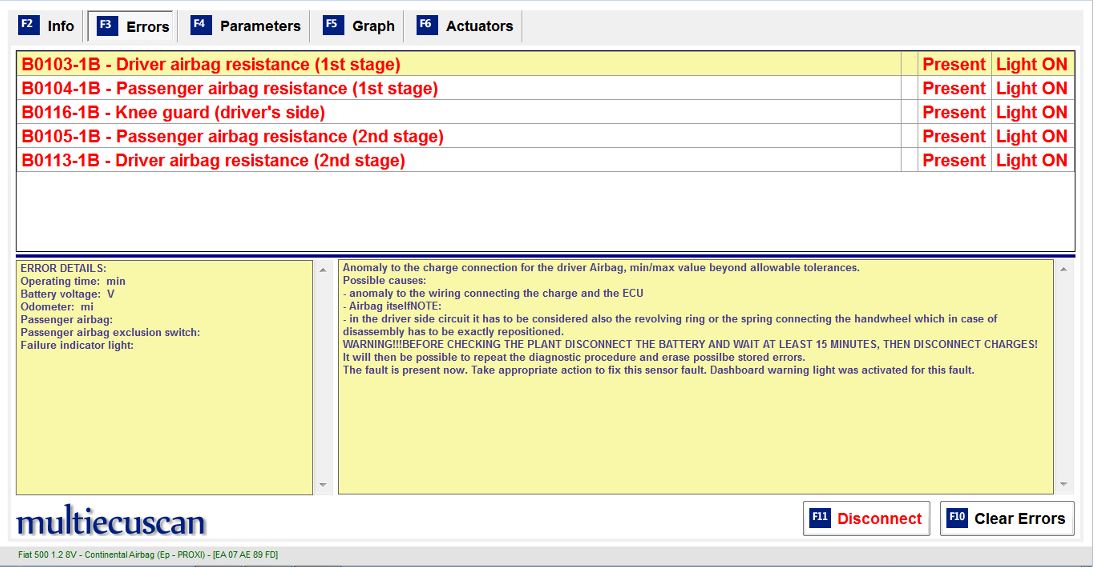

Received the airbag module back from the repair guy today. Installed and turned on the ignition, stop/start light is gone and no messages about fuel cutoff, but a beep and "airbag failure message" happens and both the airbag lights are still on.
Connected MES, Proxi alignment option tells me all modules are fine and the procedure is not needed. Connecting to the airbag module and scanning for codes gives me this screen :
B0103-11 and B0104-11. Anything I can try before I start removing trim and carpet looking for dodgy wiring? Is it possible these alarms are from the test procedure and they will clear down on their own? EDIT - I tried to clear them and they came back, so not likely.

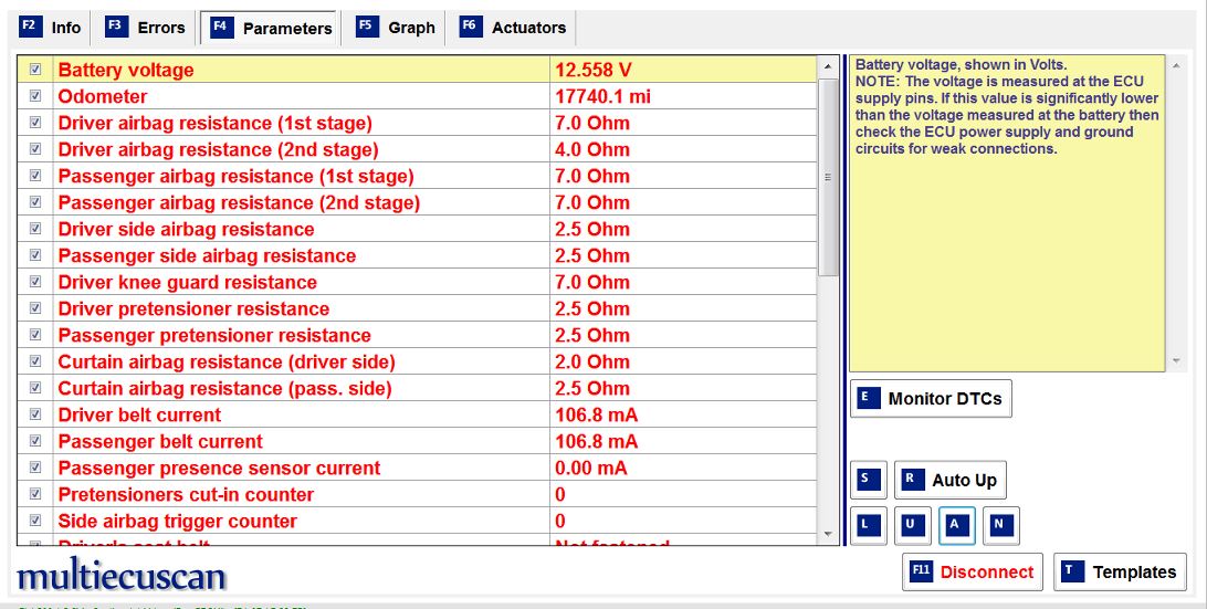

Having another play with MES and I managed to find the Parameters page of the airbag module, which shows the 1st stage resistance values to be very close to everything else. Does this look correct/incorrect to anyone?

I tried this today, not sure what to make of the results. Attached is a photo of my new patented airbag simulation tool, delivering about 3.5ohm each side. I removed the drivers airbag and connected both 1st and 2nd stage connectors to the tool and checked the resistance readouts on MES. 1st stage stayed at 2ohm and 2nd stage showed 3.5ohm. The same was true if I swapped 1st and 2nd stage connectors over. The strange thing is when disconnected, both stages showed 7ohm. So the 1st stage is reacting to being disconnected and is showing the same reading as the 2nd stage, but is shorting out as soon as it is connected to any form of resistance. Does that mean anything to anyone?

Hm - I would interpret this as the sensing being faulty when it shows 2 Ohms while connected to 3,5. If I understand you correctly, the 2nd stage shows 3.5 Ohms in both cases (which would be correct but also close to what it showed with the real airbag.)
If the 1st stage shows 2 Ohms - which it did with the real bag as well - it may have a sensing problem.
Can you add a few resistors and make it 2.5 Ohms on one side and then measure one way and swapped ?
When you say 7 Ohms while disconnected, that means all 4 wires open ? Not sure what the computer is supposed to show in an open circuit. Maybe that´s the max programmed value ??
Or there could also be an internal resistance of the measuring circuit of 7 Ohms that then shows the resistance of the parallel circuit (7 and 3 Ohms parallel makes approx. 2 Ohms. In that case the 2 Ohms would be the correct readout value, not the 3.5)). Unfortunately I could not find any details on how these things look like internally.
In any case make sure the connectors are low resistance so they don´t generate a faulty reading
And it is highly recommended not to measure the airbag resistance directly !
As you have the simulator set up, you might vary the resistance values and see which port registers any changes and which one doesn´t.
My overall suspicion would be that the airbag control module has an issue, though.
Yes correct, 1st stage shows 2ohms when connected to anything and the "short to ground" fault is present.
I brought it all the way down to 2.1ohms using lots of resistors (I only have 10ohm ones). Connected to the 2nd stage and that showed 2.5ohms. Connected it to the 1st stage and it showed 2ohms again. I also tried a single 10ohm resistor in each. The 2nd stage remains at 7ohms, the 1st stage goes to 2ohms. I did wonder if the MES software only goes down to 2ohms?
Yes, with all 4 open. If I disconnect either stage, that stage goes to 7ohms. I was assuming the same, that either it is some form of resistance in the overall circuit or the software maxes out at 7. With both stages disconnected and checking the fault codes on the module the "Short to ground" is replaced with a different code, meaning it is aware of the circuit being open and no longer shorted.
Too late, already checked it last week. Measured around 2ohms so won't be doing it again.
I hope not, the guy who reconditioned it seemed confident it passed his tests and he's already had it twice, I'd hate to have to send it to him a third time and ask for my money back!

Thank you very much for the training info. The pinout was exactly what I needed to further pinpoint the issue. Apologies in advance for the multiple images.
Firstly, I connected the power/canbus and driver/passenger 1st stage airbags up directly to the connector but via my external wires, just to prove the error is still there. I didn't have enough cables to wire 2nd stages at the same time, nor the knee guard / ECS, but hopefully this will still be relevant to pinpoint the problem.
Wired up like this :
Errors are as expected, 1st stage still shorted. 2nd stage and knee guard are open circuit :
And parameters :
Next I wired the driver and passenger 1st stage pins up to my dummy resistance, which is about 3.5 ohms.
EDIT : like this :
But, the errors are still there :
And parameters :
Just to prove it wasn't an old error (I am clearing them each time BTW) I disconnected the dummy resistances and the faults changed to open circuit ones :
Forgot to capture the parameters page here, doh!
Connected dummy resistance to drivers side only, 1st and 2nd stage. The 2nd stage error is gone meaning my dummy resistance has been accepted as an airbag :
And parameters :
Did the same on the passenger side 1st and 2nd stage, again no 2nd stage error for the resistance connection :
And parameters :
As the wiring harness has been eliminated from the circuit and I am connected directly (via some short cables) from the module to a known good resistance and I am still seeing the short circuit problems, doesn't this suggest the airbag module is the culprit? I'm leaning towards buying one from eBay and finding out ....
