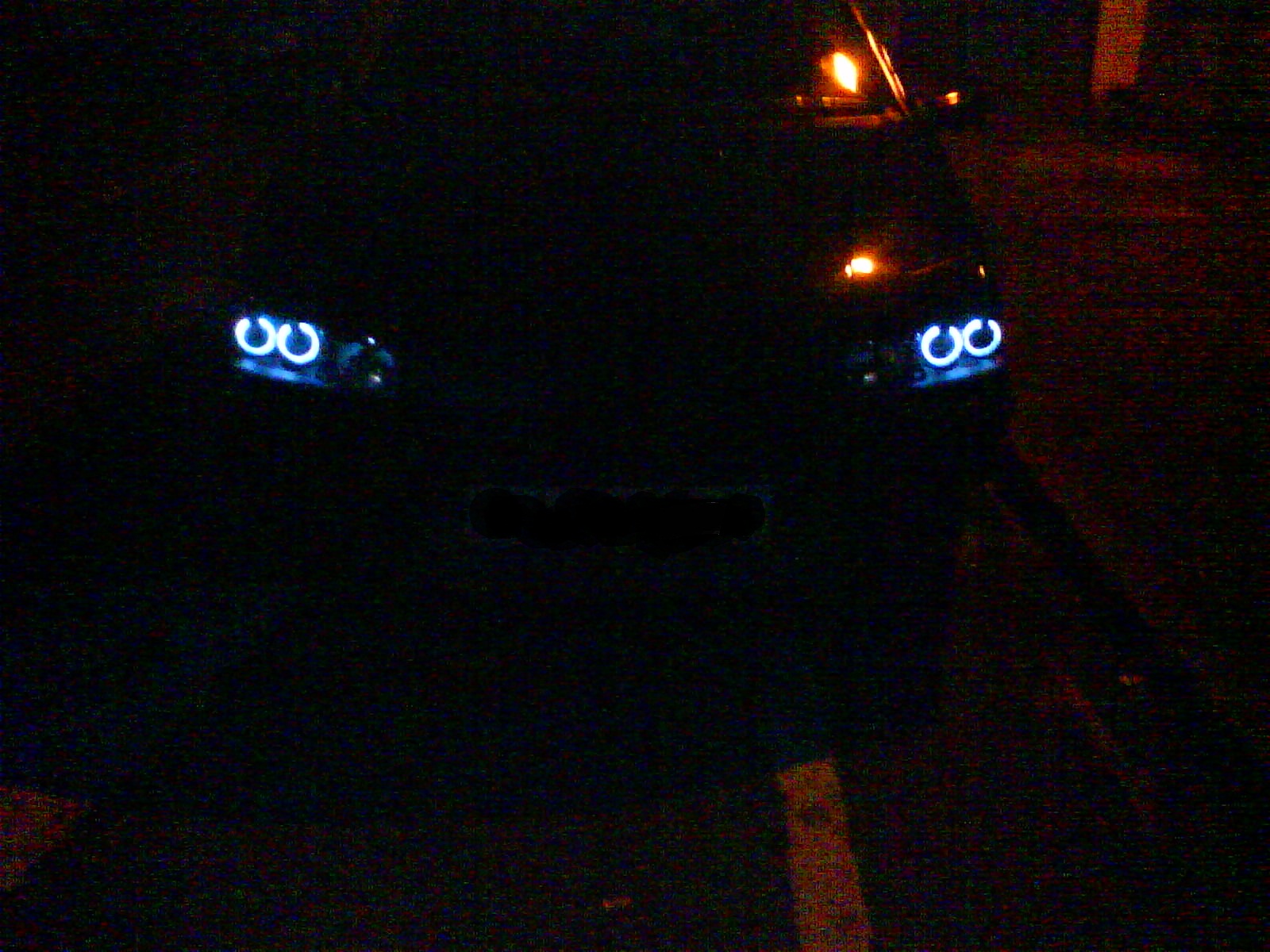

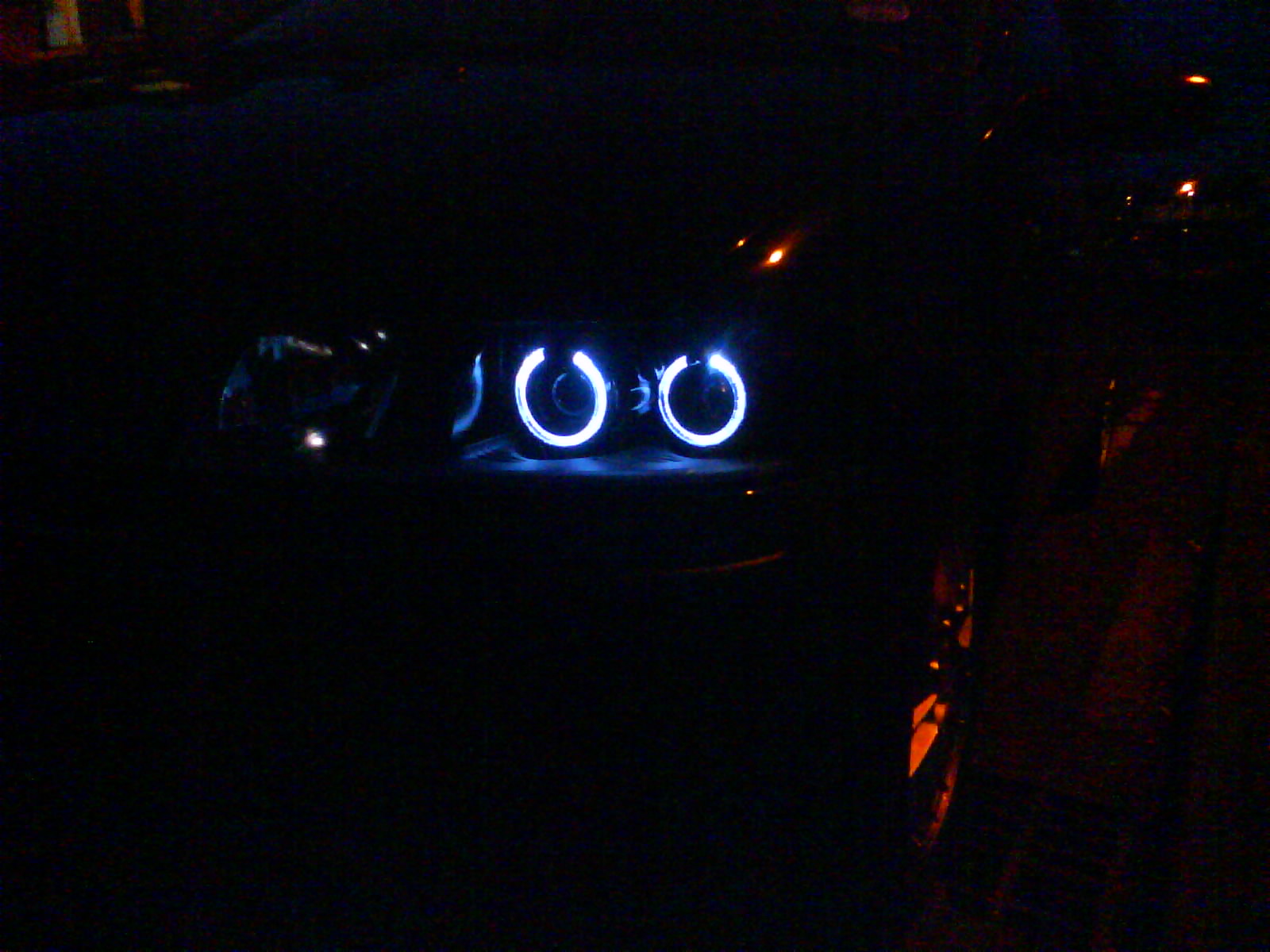

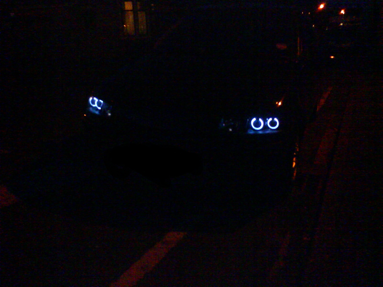

nah not bonded into the ends of the rinngs i just pushed them in they wer a tight fit then i heat shrink over them to make sure they wont slip out
i noticed that with parralell if i bang another bulb into the circuit then all the leds go a quite bit dimmer, so when i link to my sidelight wire wen the 501 sidelight bulb is activated my halos might go very dim lol
If you wire a bulb in series before the parallel LED's then you effectively share the available voltage across them, so yeah, it'll be a fair bit dimmer.
If you put it in parallel with the bulb then you should get the full voltage across them all, so should be no change in brightness.
If you just patch that onto the bulb wires it'll automatically be in parallel with the bulb!

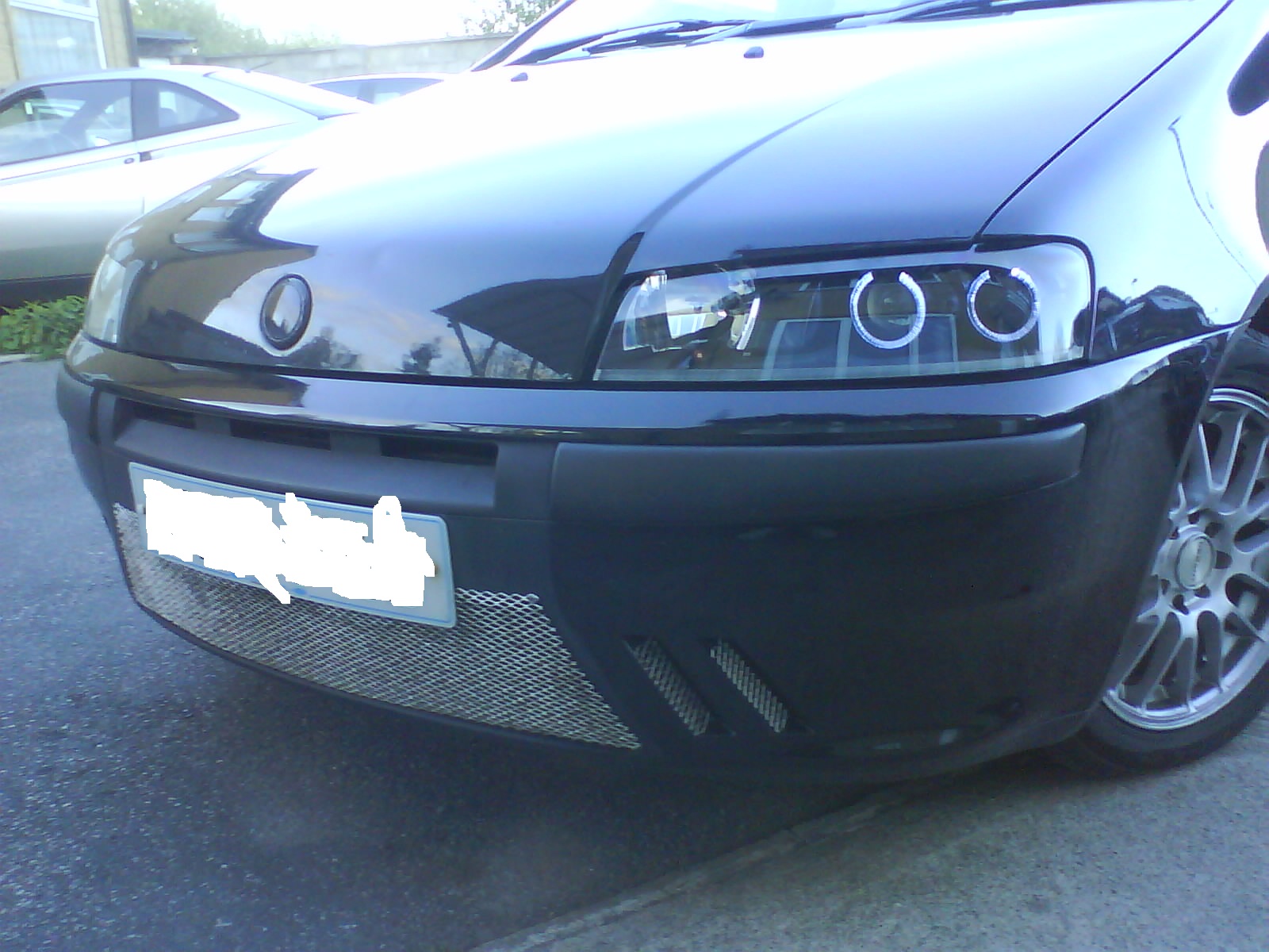

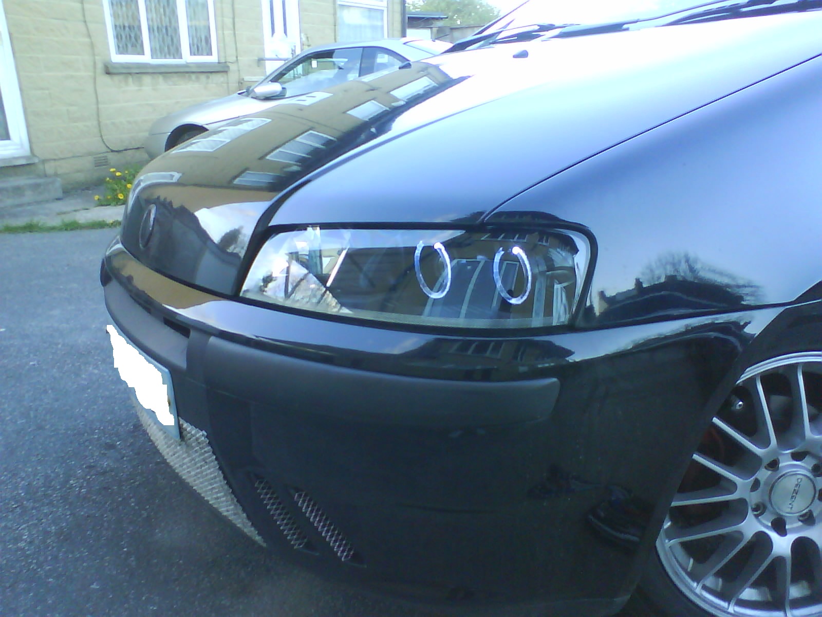

Can we see pics of how damaged your headlights are now? Since you've had to dremel them to get them apart? (y)
they dont get damaged all you can see is a rough line on top of the light when you open the bonnet
yeah mate just like a ruff whit line wher it use to join but no ruff edges as i thinly siliconed over the joint to smooth it out

Youve done a nice job with the halo's brin
cheers mate, took a hell of a lot of effort lol
