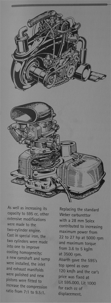

Oops - forgot about the 'standard' 595. Yep - you are right, it used a Solex C28PBJ (whatever that is ??) and ran a 9.2:1 CR for 27bhp @ 5000rpm.
One of my reference books is Greggio's 'Abarth, the man, the machines' published by Giorgio Nada. It's quite a large book, full of fascinating information and it covers all of the Abarths - Fiat, Simca, Porsche derived etc.
I've attached a couple of photos from that book. The conversion kit is similar to what I've done with my engine so I'm quite happy to believe that my rebuild is faithful to what could have been achieved at the time.
Regards,
Chris
