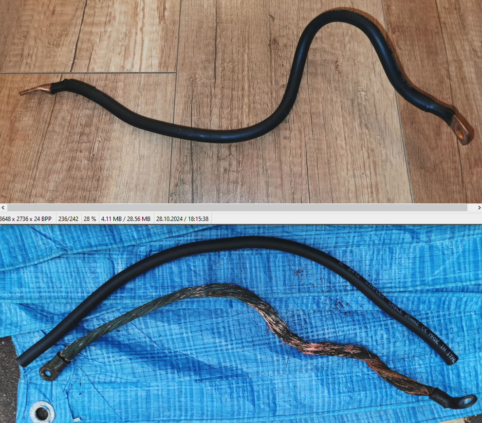

I'm replacing the earth straps with good quality copper welding wire. That's a photo from a previous thread when I showed how does it look. It's a non-FIAT car though.
