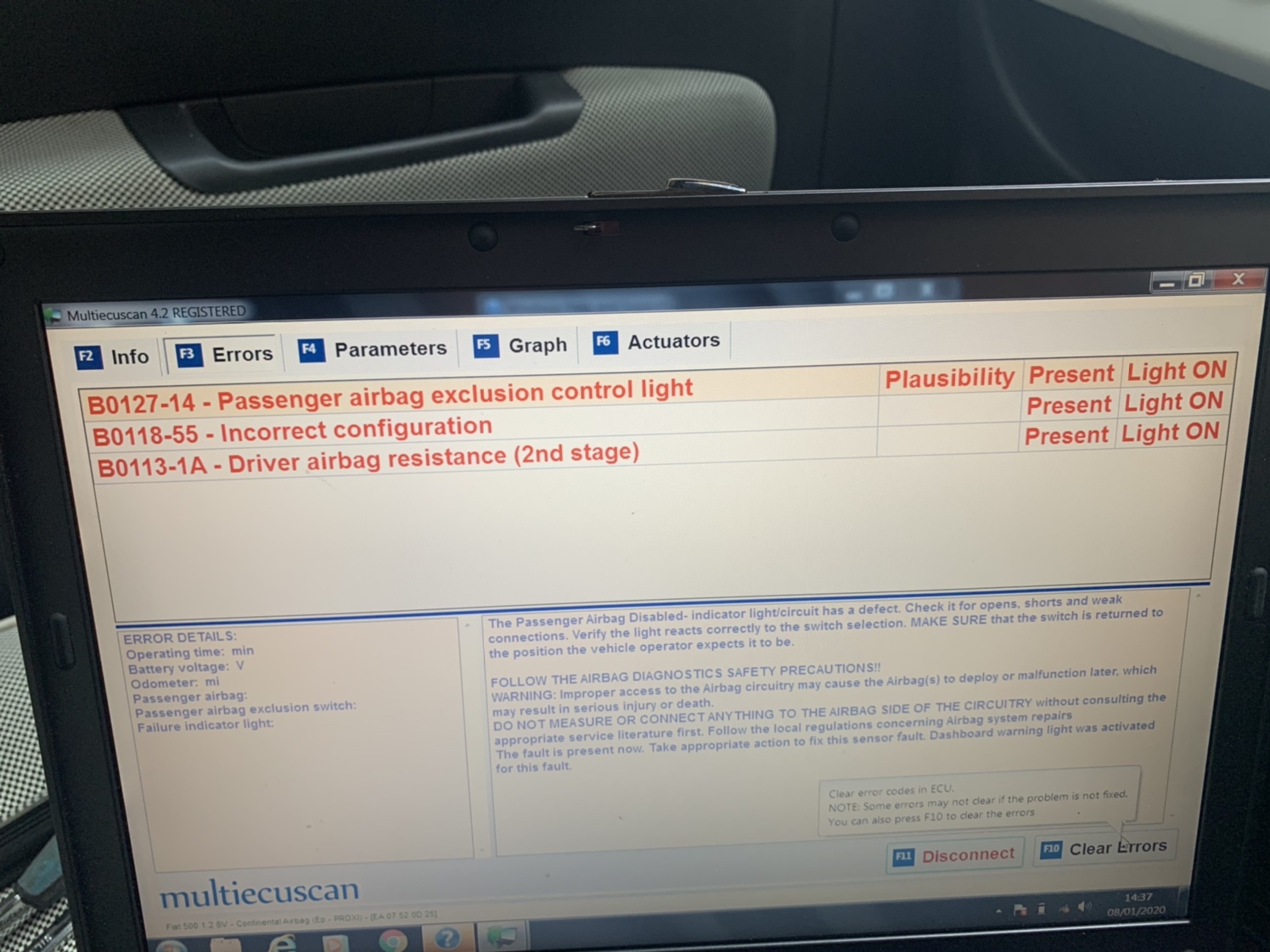

And onto the next problem. 2012 1.2 lounge airbag ECU removed was the message in MES. Airbag lights up on dash as well as others.
Got second hand ECU, fitted. Car sees it but I’ve got three errors throwing up which won’t clear.
Passenger airbag exclusion light. If I try to switch the airbag on at the Speedo it stays off.
Incorrect configuration. No idea on this. Proxy alignment fails with out of range error.
Driver airbag resistance (second stage). I have seen this before and seems to be the clock spring/squib.
Mileage is still flashing as the proxy alignment won’t work.
I have noticed that the Speedo has got the feint light fault so that probably needs changing so I’m wondering whether this has anything to do with it?
Will be changing Speedo and clock spring next week.
Thoughts?
Nobody had any thoughts but this is still ongoing.
Changed speedo today, no effect. Changed clock spring, it then got rid of everything but the passenger airbag switch light error. Then drivers airbag (first stage) came up.
The incorrect configuration seems to have gone.
Nightmare. It’s beaten me, first time ever. I’m at a loss as to what’s causing it. The only thing I can think of is the passenger airbag has a fault or one of the plugs is faulty. Not sure whether you can change the passenger airbag from underneath the dash when taking out the shelf or whether the whole dash needs to come out.

This is a previously repaired car and has been fine for two years or so. The four errors were there with original ECU and MES said ECU was disconnected so it’s obviously knackered. Plugged in new ECU, MES can see the new ECU but will not do a proxy alignment as it fails to write to it. Changed clock spring all went except for the passenger airbag one. Then drivers stage 1 came up too. Tried swapping back to old clock spring all errors back. Swapped back again, back to just the two.
