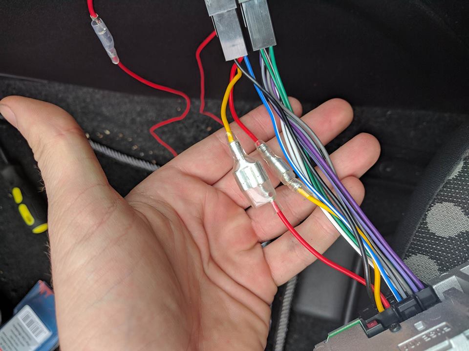

Just bought a Sony DSX-A400BT headunit and it wont power up?
I've bought an adapter and spliced the larger red cable from the adapter into the ciggy lighter but still no power??
No fuses are blown, just a very confused me.
Pictures below;
1) picture of the sony headunit cables
2) cables from the sony headunit
3) the adapter red cable going into the ciggy lighter
4) the adapter going into the Punto Headunit cables.
thanks!!

Coming out of back of head unit any idea why there is a red wire connected to yellow wire and yellow to red?
Wires from back of head unit the two single wire connectors, connect red to red and yellow to yellow.
i'll find the adapater i have and will link it as i think thats whats causing the problems!
Just changed the red to red and yellow to yellow.

Your car already has a standard iso lol.
Remove the autoleads harness, and connect the sony one to your cars standard iso, also if it doesnt power on, join red and yellow together on sony harness as the fiats are permanent live on stereo iso harness... not switched so memory feed and switched live go to permanent feed, usually u can swap the bullet connectors and bridge them :)
