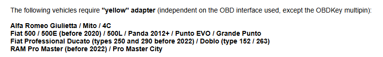

You need a generic elm327 ver 1.3 or above
You can pay a little extra and get one that's WiFi as well that will work with an iPhone as well
You also will need an adapter, as per instruction above, I believe this is the correct one but I haven't double checked it
Brilliant, thanks for the help. Looks like its a yellow adapter required in this case, I'll get those on order.

It looks to me as if the adaptor is no longer needed unless I have missed read something

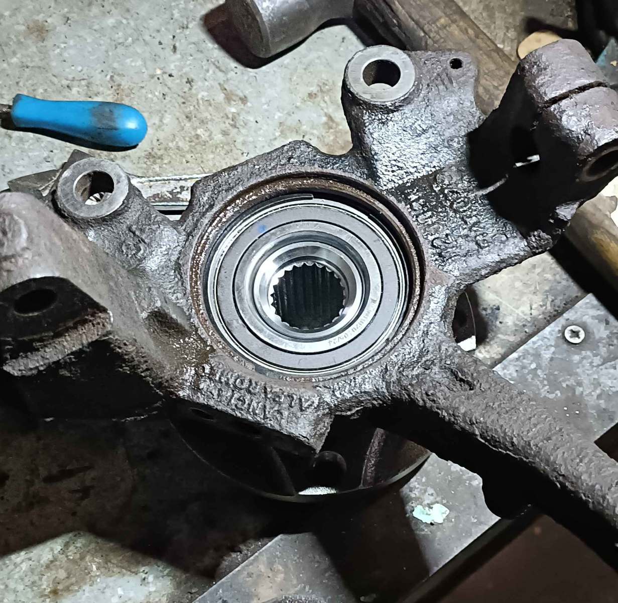

Having a think and looking back at photos I took before assembly, I think I've realised my mistake. A very silly one, but I do let myself off slightly given its my first time ever dealing with wheel bearings or ABS sensors...
I'll leave a photo here, should be easy to see the error.
I likely won't be able get round to dealing with it until the weekend, but I'm quite confident I'll be able to sort it.
Circlip in way of abs sender? ;)
