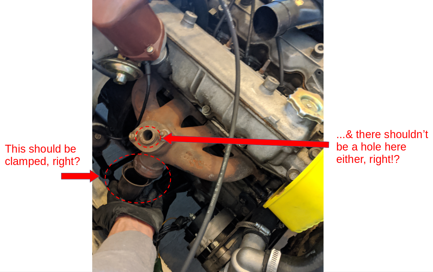

Since you all got me looking closely at the exhaust I also notice that there is nothing holding the exhaust pipe to the engine. The pipe is only loosely pressed against the engine, and it's easy to move aside with bare hands. Surely there should be a clamp there, right!? See photo below.
And finally, the exhaust connection to the engine has a hole in it that blows exhaust with force while the engine is running. I'll guess that there shouldn't be a hole here, right? Immediately before I bought the car a bunch of emissions compliance gear was (hastily) removed by the former owner. I wonder whether this hole was left this way by mistake?
I'm just a little puzzled by this post. With the downpipe actually detached from the manifold, like this picture shows, the noise must have been deafening? Have you been driving it around like this? If so I'm surprised you've not been pulled over by the police!
No, I haven't been driving the car because I was aware that something was wrong with it. You're right that it was very loud! 😬 The short trip where the clamp fell off was for diagnostic purposes as I was trying to better understand the symptoms.

Until you get a proper solution to the blanking of the top exhaust outlet port then just be careful. I'm not saying you stuffed a rag in it but that manifold port will have lovely combustion flames present and any material not capable of securing them could catch fire and give you additional problems.
Yup, it will need to be a metal blanking plate of some sort. I'm very puzzled by that port. The manifold looks unusual in this respect. Where the downpipe fits, I mean the joint where the clamp fell off and let the exhaust pipe fall away from the manifold, looks as you would expect but the port/hole/whatever you want to call it, in the top of the manifold is very strange. I'm wondering if it's an early attempt at exhaust gas recirculation due to American regulations - which we wouldn't have seen over this side of the pond? It would be interesting to examine the inlet manifold to see if there is any kind of corresponding porting in it.

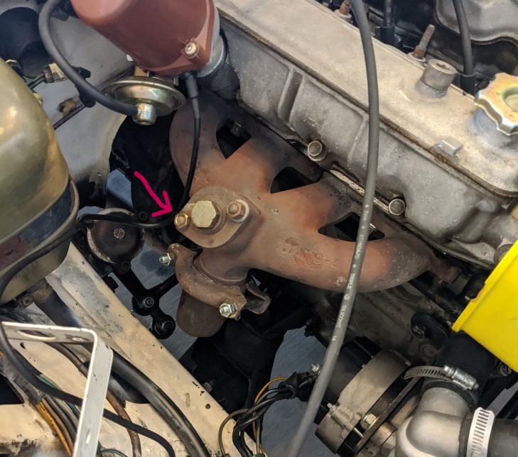

I got the clamp reinstalled! While working my wife came to check on me & I complained about missing the plug for the exhaust port. I showed her a photo, she looked in the engine bay & nonchalantly declared "here it is" and pulled it out of that dark cavity in the photo below the exhaust pipe!!! It must have unscrewed itself, fallen, & gotten stuck? Very strange. I'm extremely lucky it remained in the engine bay, & doubly lucky that she noticed it!!

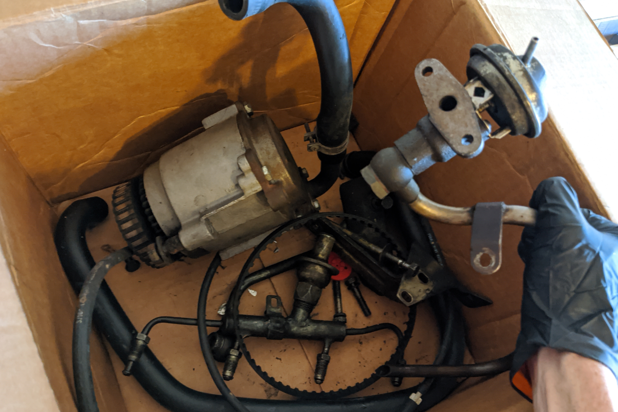

Yes, it's definitely something to pass emissions in America. The emissions compliance gear was installed in the '90s & the prior owner hastily removed it before selling me the car this summer. They gave me all of the gear in a box (photo below). The part I'm holding in the upper-right of the photo I believe mates to the hole in the exhaust manifold. I think that the pump in the box is a smog pump like this one.

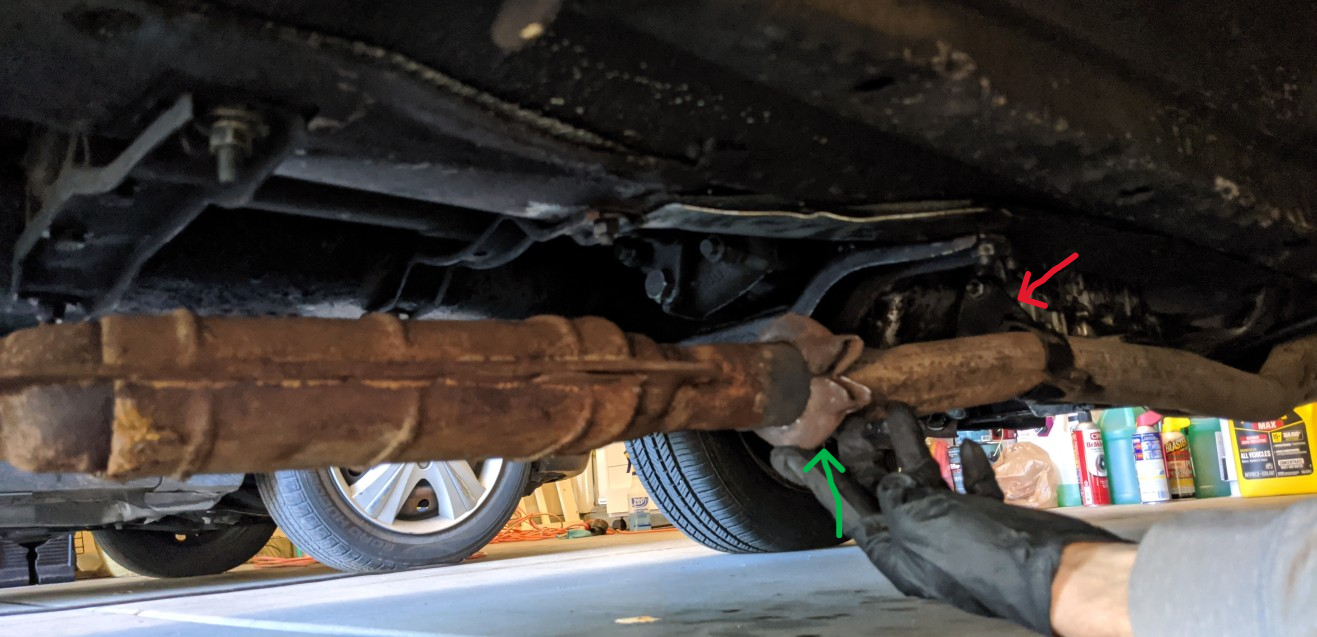

The exhaust pipe clamp (arrowed in green) is usually fitted where the exhaust pipe connects to the exhaust manifold. The usual exhaust pipe clamps elsewhere on the exhaust system are usually 'D' shaped clamps with one bolt and nut or aftermarket 'U' shaped clamps (U bolt plus a saddle and 2 nuts).
The usual way (on classic Fiats) of connecting the various pipes, mufflers etc. in the exhaust system is by slip connections, where each pipe fits inside a belled-out (expanded)section on the next pipe and is then secured by a D or U shaped clamp. Of course it's always possible that someone may have altered things from the norm.
The bracket (arrowed in red) is the support bracket connecting the exhaust pipe to the rear of the transmission - it reduces the stress on the exhaust pipe to manifold connection and also will prevent the front exhaust pipe from dropping to the ground should the exhaust manifold clamp become detached (as happened to your car).
Ah yes, Smog pumps. Something they thankfully never got round to over here - Exhaust gas recirculation is quite bad enough thank you!
Thanks for pointing this out. You're right that I had this wrong (as evidenced in the photo). I've got the clamp moved to the exhaust manifold-exhaust pipe connection under the hood. That leaves the pipe connection unsecured, so I'll find myself a D or U shaped clamp for that connection. Thanks!
