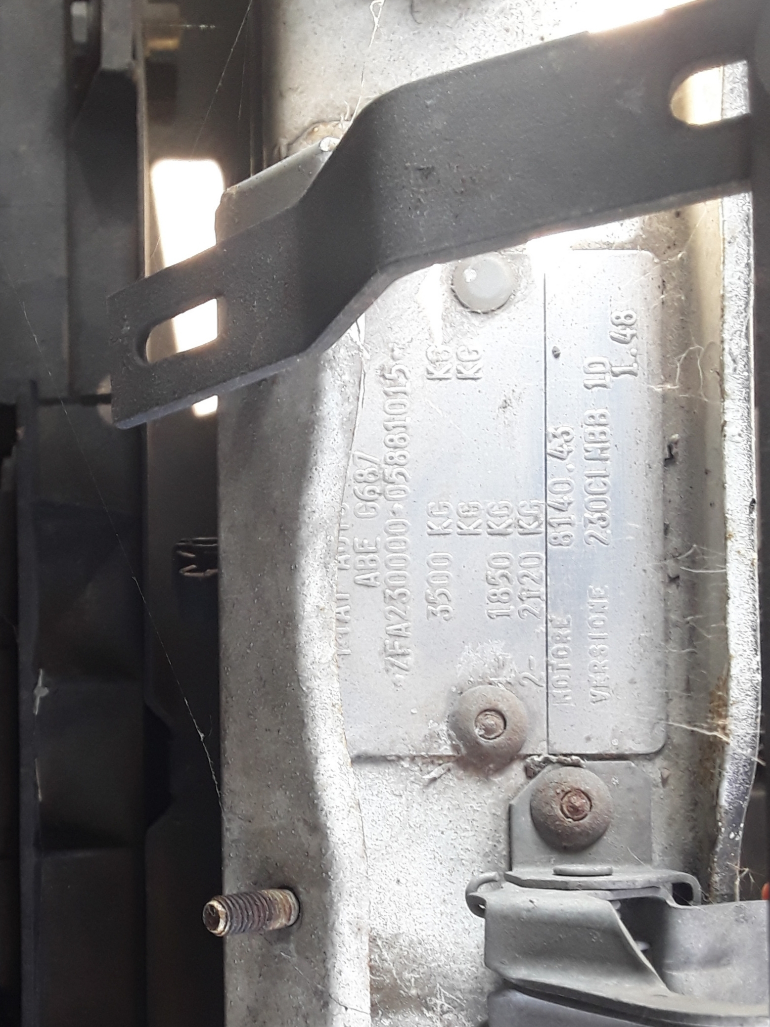

I think engine no reads 230CLMBB 1D 1.48

Good job you included the Chassis plate.
The Engine Series is the the 8140.43 bit:)
Which in hind sight I see was in the title. Duh!
