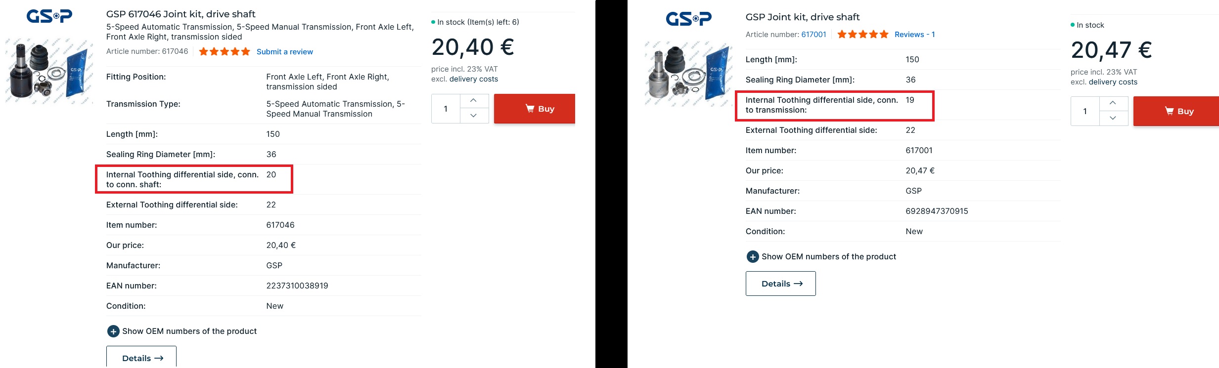

That 617046 number provided by Koalar does show up as a match for the 169 (but listed as a Ford part on Autodoc) and states 20 splines, so I guess that's the part I needed. Thanks guys👍
I guess 617046 (pre-2010, 20 splines) and 617001 (post-2020, 19 splines) are both covered by OEM number 55183134?
Which might explain how I got caught out.
O well, it's only 20 quid, I've made more expensive mistakes :) Just annoying I had to take everything apart to find out

Number of splines on the driveshaft seems to be the main difference, but the tripod / spider was also a different size, so the internals of the shaft are different
All the dimensions are given in the GSP catalogue
Which can be downloaded here
That's better then link works

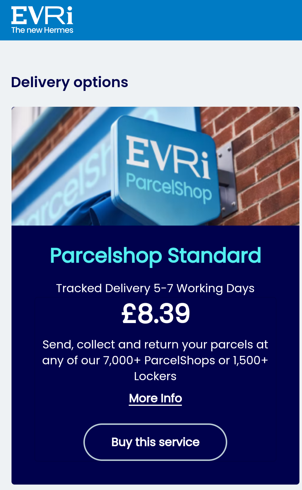

Thank you koalar, we don't have Evri here, best I could find was An Post 20.70EUR so I'd be 30c out of pocket 😭
I did think of offering it on here, but again it'd probably be cheaper for those in the UK to buy a new one than pay postage.
