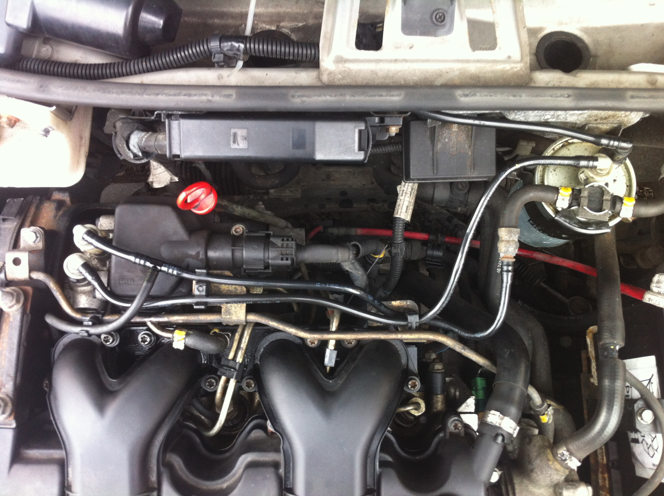

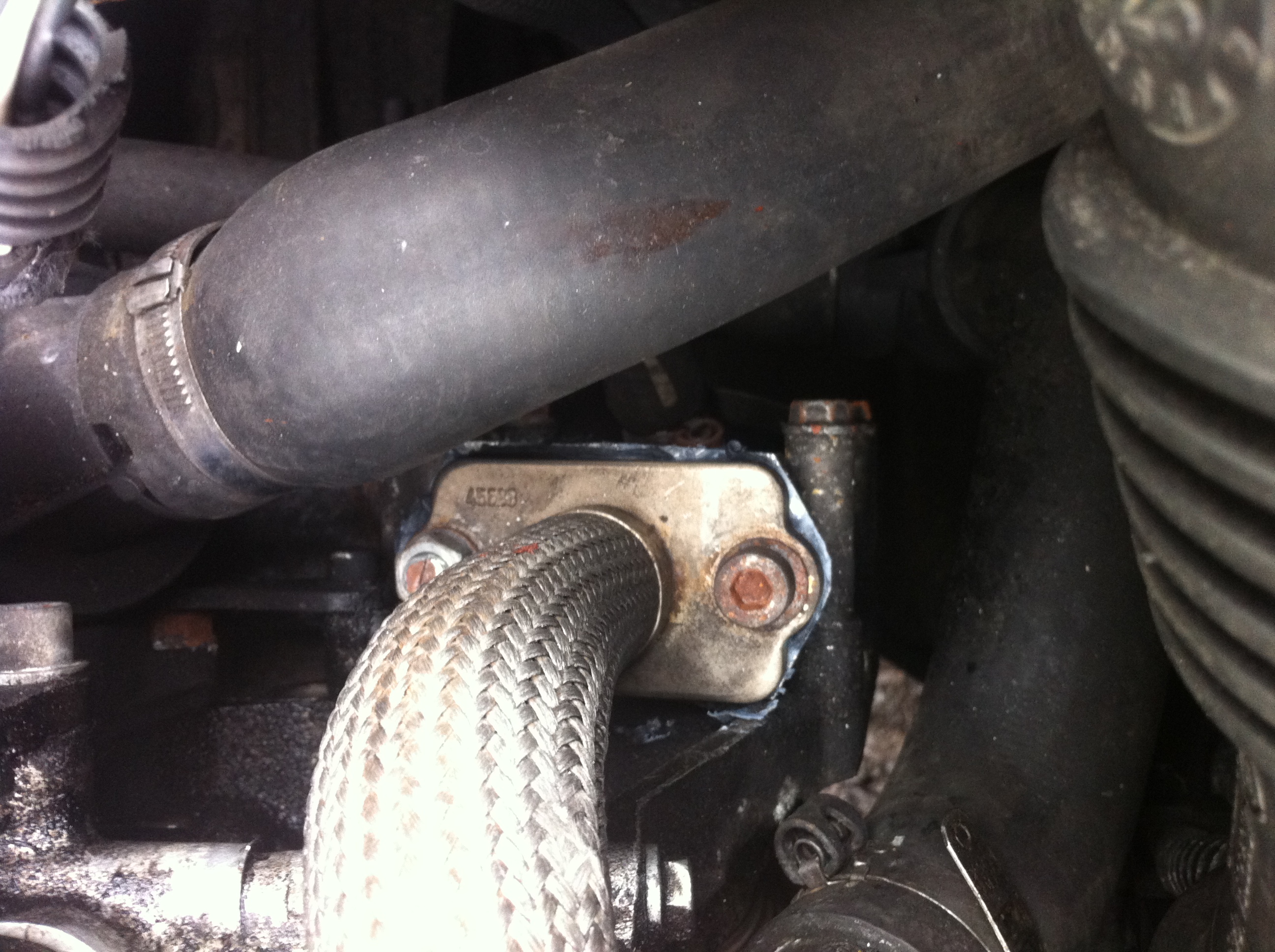

Egr valve is blanked off mate. I think. Going to laptop now and post pics. Cheers. Speak later.
update dannyboy.
Have checked etc like you mentioned seems ok.
Question is am I in the right place ? As you can see from the pics this sensor you mention with the electrical connection and vacuum that goes round the back of the engine . My vacuum doesnt. It stops at right hand end of the engine into a t join with 1" pipes ??? Is this correct.
Also on packing up to come in to the laptop I noticed quite a distinctive noise coming from the area of the pump..
Sound like a tappets noise but a lot finer and a lot faster like a brrrrrrrrr sound. metal on metal. sound like its at the cambelt end of the pump ???????? Could be way off but might be something. What do you think ? Have you heard this before ?
Also on another note have you got a model and maybe a selection of years that this engine was also installed in so i can phone around scrap yards for quotes on a pump.If that is the problem. Is it the same in a TD etc.
Your help is much appreciated mate and I am very grateful. Cheers Tony.:worship:

Cheers mate. Checked sensor by air filter. Seems ok move flap by hand and I can hear relay clicking so not broke off. Anyway of checking movement with engine running ? Flap is fully open at moment ? Where is this throttle chamber you mention mate ? Really obliged for your help in this.
The flap should only close when under vacuum and the engine is warm. If it's open now and moves freely, it's a good sign. Only way of testing is to watch it with the engine running and ensure it's staying open normally. Throttle chamber is the flap unit. ;)
update dannyboy.
I'm doing most of this from memory, so some things are a little hazy. The pipe linking to the brake servo pump hose sounds right.
With the ignition on, the ECU will be energising the solenoids in the pump, so you will hear an electrical buzzing from the unit, plus other items in the engine bay.
Like I say, the 1.9d wasn't a popular engine with only the mk2 Punto and Doblo using it as far as I know, and was replaced by the 1.3 jtd in '03. It's a Lucas pump, but I doubt it's the same as the older TD engines. I tried finding the part number via ePer at the top of the forum, but it's not working at the minute. Failing that you can ask your local Dealer for the number and try local breakers or diesel pump specialists.
Thanks for all your help mate. Really appreciated. Just don't know what else I can do at the moment. Do you think it's the pump playing up ? I'm leaning that way at the moment.
I'm going to go to my local garage tomorrow and have it plugged in properly to be on the safe side. If he can fit me in I'll update you tomorrow after work. Cheers bud.
The Rotor position problem is well known to be down to the pump internals, though why the throttle flap was listed as faulty I can't be sure- just make certain it's open with the engine idling.
