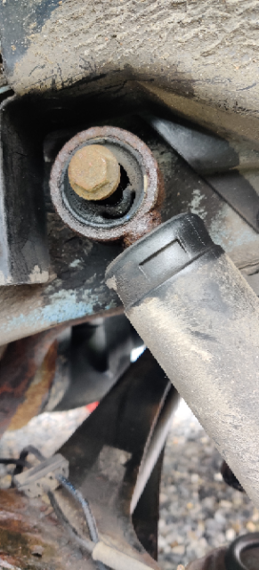

Mine are rusty as always not not adrift - what about the rubber stopper does that kook decent? It's done 137k miles. Springs are not broken. Should I buy new shocks anyway after that mileage? Thanks for for your help. It's been many years since I've underneath a car!

would you change the shocks?
Why not right, if you are going to change the bushings then do the shocks as well, they are not that expensive and you will save on labor cost.

Have a look at the tops of the shocks and see if they look like this before I changed them on my daughters fiat 500
Once the rubber inserts delaminate from the surrounding metal, it's an MOT fail.
Fortunately changing the rear shocks is one of the easiest jobs on the car. Surprisingly, the bolts usually come out without fuss, even on a 10+ yr old car. Note the top & bottom bolts are completely different sizes, so even the most incompetent mechanic can't get this one wrong.
So if you're doing it yourself there should be no nasty surprises, and if you're paying someone else to do it, it shouldn't cost a lot.
