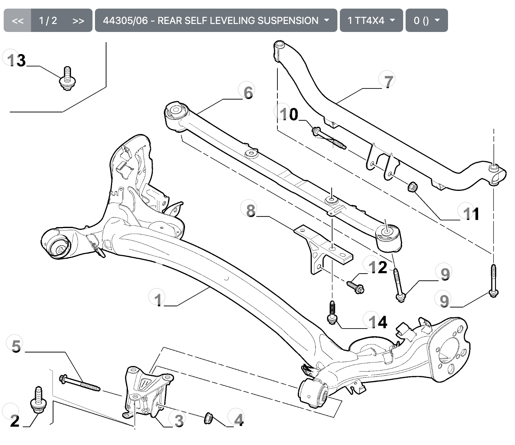

Evening all, long time no see, currently back in the fold with Panda number 4.
2013 1.3 multijet 4x4. Bought from a dealer with a 30 day warranty that has 6 days to go. Thought I'd better get up on the ramps and check underneath for diff leaks etc, now that I have several hundred miles on it. The first thing I spotted was a broken bracket on the rear subframe, hmmm I think to myself " should this model have a rear anti roll bar?" doing a quick check indicated that rear anti roll bars were indeed a thing on this model. This is particularly galling because I knew sub frame rot was an issue on these and made a point of asking the dealer to confirm that it had been checked before I travelled two hours to see it.
My question is were all 4x4's of this vintage fitted with rear anti roll bars ? Because when I phone tomorrow to complain, I don't want them trying to weasel out of it by saying they were an option and you don't need it. My view is that if the factory fitted them to all cars, that they have supplied a vehicle that doesn't meet the spec that it left the factory with, and I want a fix or a refund.

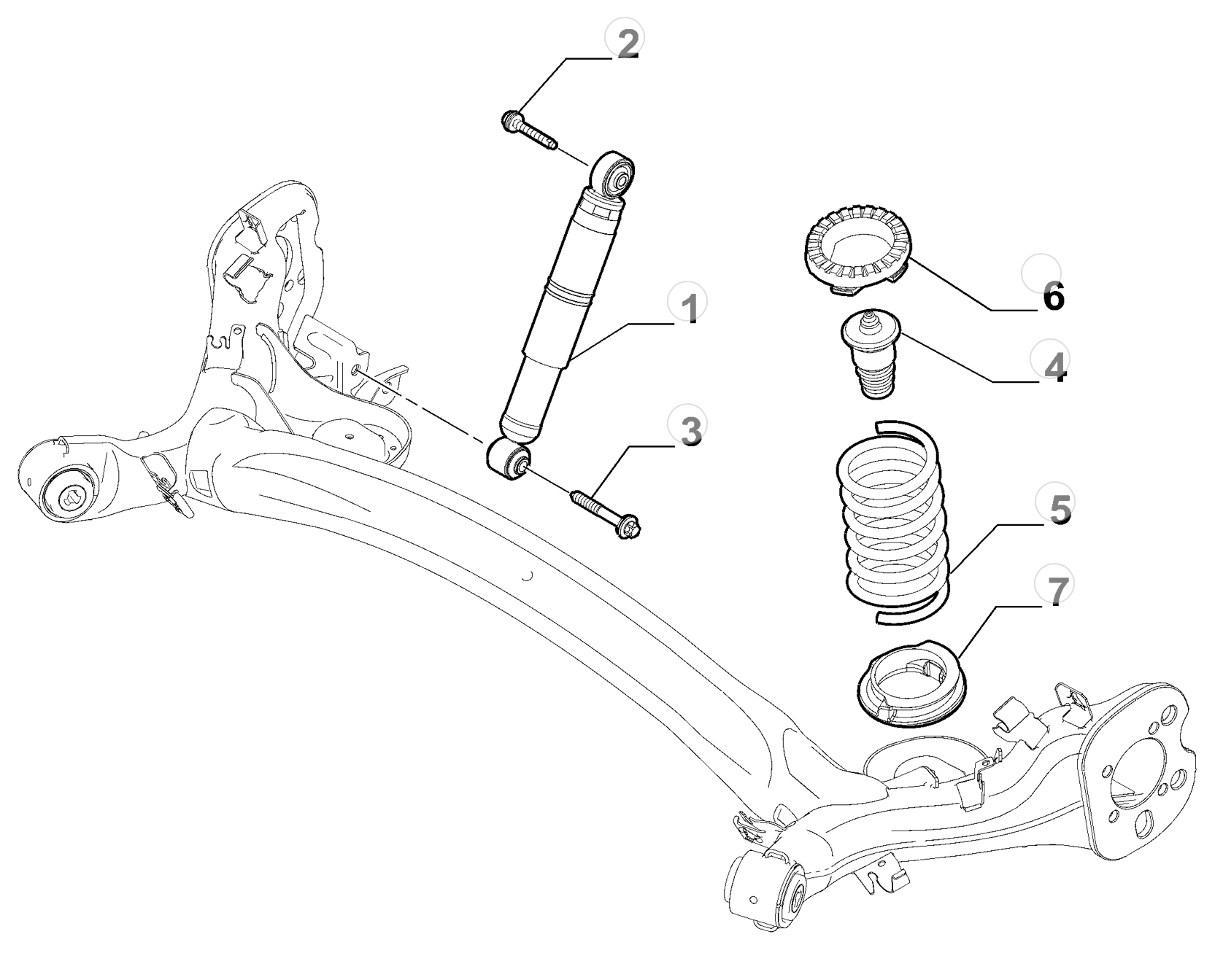

On the bottom of the forum banner you've got the ePER link. In general it's the FIAT spare catalogue, but with the help of the VIN you can also decode what options have been installed in the car at the factory :)
Sometimes finding the option description can be tricky, but internet is usually very helpful :D
Then, when you search ePER with the VIN, it shows only the parts that were fitted at the factory to your vehicle:
So finding the category where the roll bar should be shall tell you the thruth :D
Search window is top left of the screen.

I’ll have to check but I’m pretty sure there are no antiroll bars on any (312) Panda? The 2WD cars have a v-section beam that connects between the suspension arms at either side, and that torsion beam acts as an anti roll bar. The 4x4 uses a different beam which is a closed tube, so stronger but still acts as a torsion beam. Because it’s a closed tube rather than (effectively) a bit of angle iron, it also resists rust a little better. There is no rear subframe.
But I’ll take a look… and no doubt prove myself wrong!

Right, I can see where I'm going wrong here, thanks for clarifying, I've had 141's and 169's before and assumed that subsequent years were all the same mechanically the examples I was looking at were around 2008.
Also I put my vin in per as suggested and it's not showing arb's, so other than a missing bump stop and the mystery torn off bracket, less cause for complaint than I thought.

Thanks, checked eper against my vin and not showing arb, so looks like I'm worrying unnecessarily 👍
