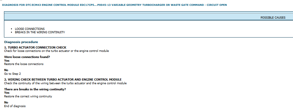

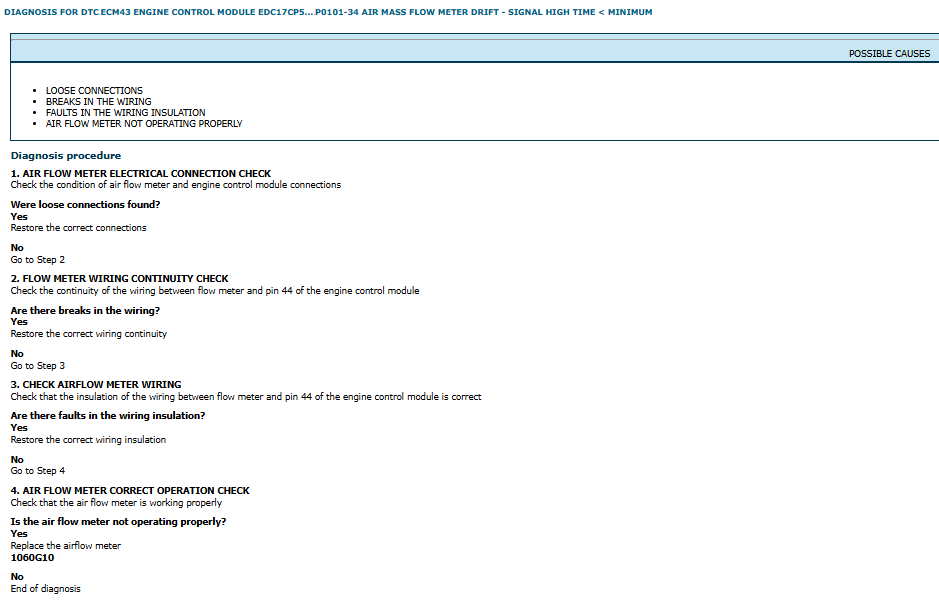

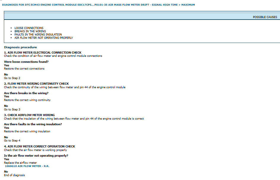

Here's what seems the closest to me for the Bosch EDC17CP52 injection:
P0045-13:
P0101-34 / P0101-35:

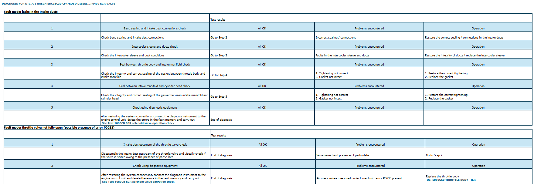

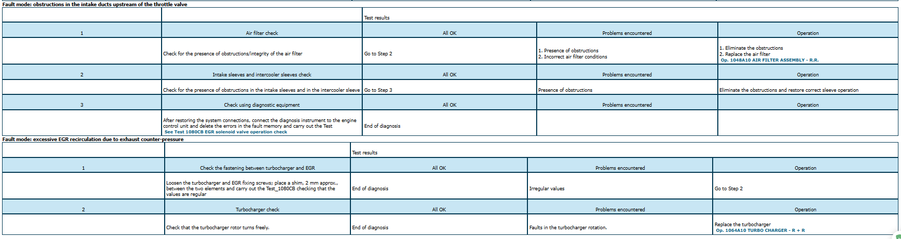

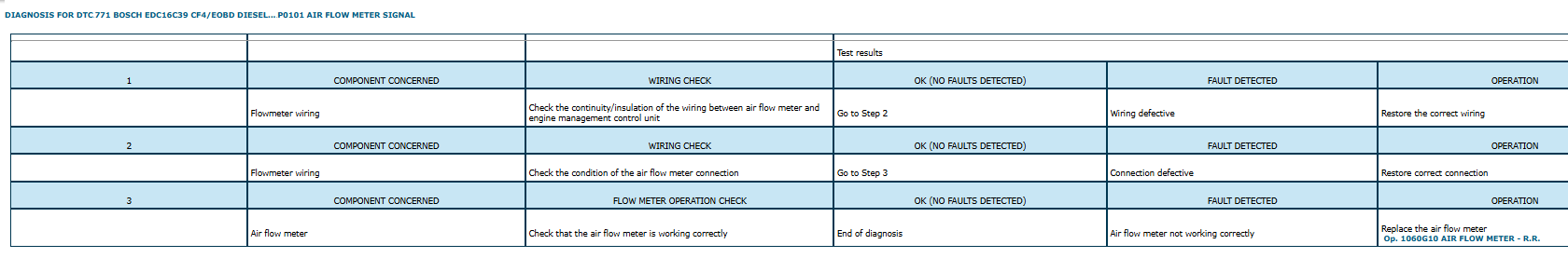

These ones are for another injection Bosch EDC16C39, no idea which one is on your van:
P0101:
P0402 the last one seems to be the closest:
P0045-13:
P0101:
