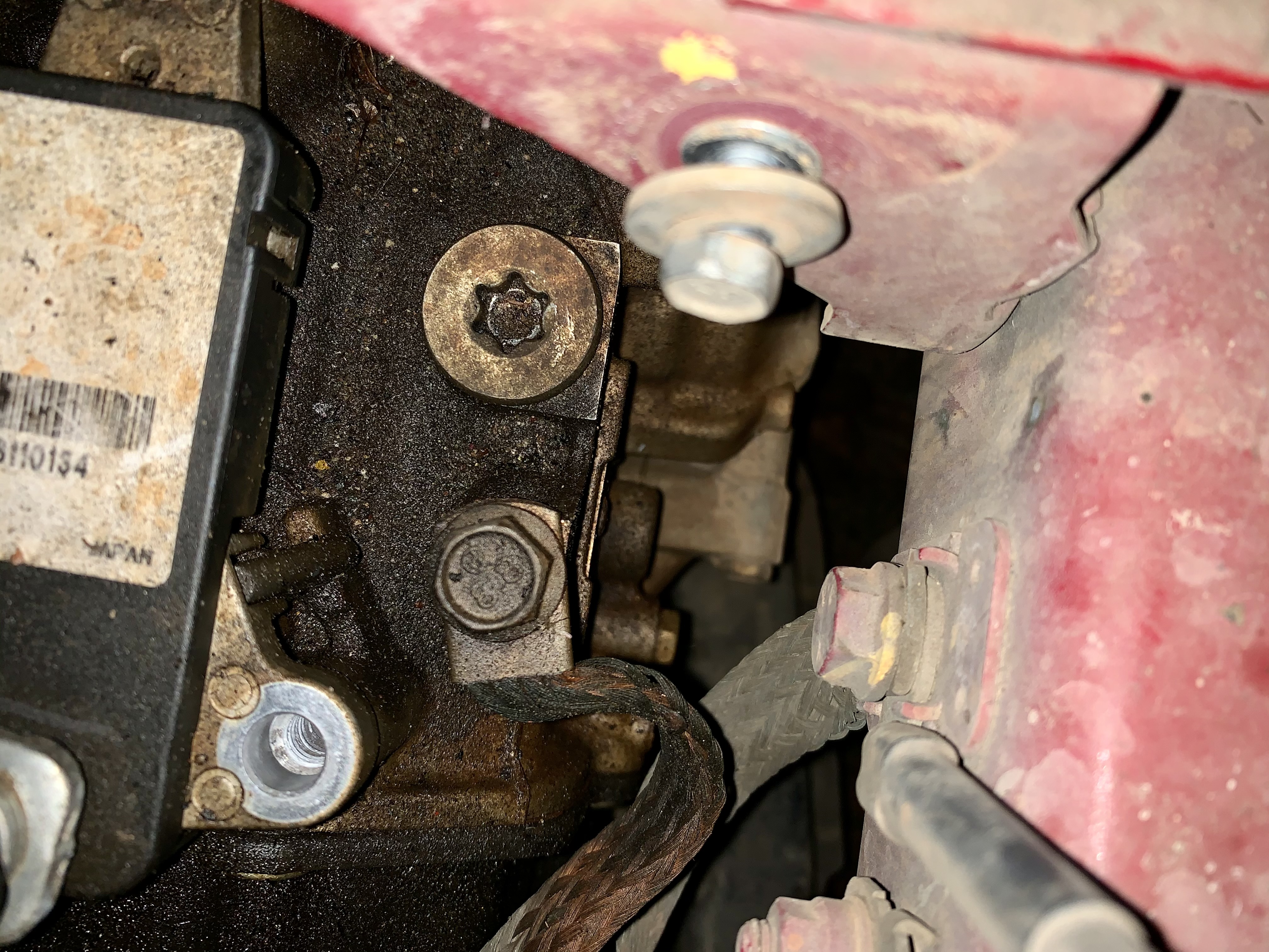

I did a second transmission flush after the last one a year ago, refilled all good, but then I removed Torx55 plug on driver's side of car slightly forward from where the automatic transmission level / drain plus is. About three table spoons of some type of fluid came out only. What came out? What does this fluid support? It seems the car has the e.lectro hydraulic shifter and doesn't need gear oil or hydraulic fluid, but it would be weird for this to be just some sort of over flow for something? Oil level is perfect after oil change last week too, and yes the car is leveled at this point before I started the service. Any help as to what this actually does would be helpful, there is small 12 mm bolt just up perpendicular to the Torx 55 plug too, when I took it out just a few drips came out too. Again, any help would be great, or am I done, lol.

Alright, I've had her on the ramps level for a few days after thanksgiving. I traced the brake lines, but nothing to the transmission area housing on drivers side. So slept a winter's day or two on it, so the battery (driver's side too) sits on top of the transmission gear shifter bushing (changed that cheap piece of plastic crap almost a year ago after it left me stranded) area where it looks like the select o magic (I'm calling it, lol) box sits attached to the same area as the physical cable that runs from the shifter inside the car. On the bottom of the car as mentioned before is where I found the torx 55 drain plug that yielded a small amount of fluid when I drained it when this began, so after thinking logically that the / a fill plug (or separate small reservoir) not attached to the brake reservoir would / should be near the area where the drain plug is I pulled the battery, and then began loosening the select o magic box and cable running to the shifter (where the cheap designed bushing is). Those were 3 each 12 and 13 mm bolts, I had one hiding underneath the small plate on the cable shifter and left it until the next day, then I decided to pull this small but in the way wire bracket (1 10 mm bolt) and what did I find underneath, but a torx 55 fill plug it would seem. So this is where I am at, I will do a more detailed video when I am done to help folks but I just now need to put something in there with the drain plug open is the plan and see if it what it appears. Here is a pic of the top side and I just need to figure out if it is the GL4-70 75 gear oil or brake fluid, I am leaning towards the gear oil as there does appear to be some reference information to the "dry clutch" but without any good information other than "the green vanper" I have to take my time and let patience have her perfect work of killing problems, lol. Oh, and just drive my truck in the meantime and "burning that gasoline", lol. Here is a pic to maybe help someone in the meantime too.

Thanks for the input brother, well the green vanper put me on the path of systems it could be, but like I said in the first post, I knew it wasn't oil or transmission fluid (because I have serviced both twice now in two years since I have had the little pop 500), but logically I am betting that if I pour fluid in the top hole (aka fill plug hole) ( I'm thinking I will use a light weight hydraulic oil with the bottom drain plug open) the fluid will just come out the bottom.
There was only about three tablespoons of fluid that came out of the torx55 drain plug when I opened it, but it was darker from I would think years of use, but it was not oil or transmission fluid. The chances of the same torx55 plug being used on the top side of the same system is high (at least it would be for good engineering, lol ), but we will see. To your point though, without good documentation / access to components that need maintenance (service) from our friends at FIAT, I am not sure what it is, but it's not the engine or the transmission, but looks to be just the shifter area on the drivers side so whatever they call it Dualogic, Conformatic Selespeed (per green vanper), and my name "select o magic" , lol , we will get to the bottom of it without a drawing and without tearing it up. It would make sense logically as well that the transmission would have a sub area and covering protecting the shifter which is really all that is going on, which has glorified some device or subsystem that now moves the linkage for the transmission to know what gear you want. Don't you guys think that if we were making a car, and system, and subsystem off of that, that we would use similar bolts for the drain and fill plugs especially when they are in proximity to the sub system running the select o magic shifting when using non automatic mode of transmission? So until then I will try to find more information on fluids and amounts needed for service, but like I told the green vanper the dealers in the states are not much help. I will hopefully get to it soon, but I appreciate y'all's input. Thanks

Thanks brother, no I am not aware of anything on this setup, lol. Some say no gearbox on automatic transmission w/ Duallogic (aka select o magic, lol) and some say yes it has one, but if I can just fluid service what I emptied I will be further along, but it would make sense / be logical that it would be a gearbox setup since fluid did come out and if you logically breakdown the picture, that fill plug sits to the right and towards the back of the car and slightly away from the box with the wiring harness ( robot aka Duallogic , select o magic) going into it that and appears to the physical shifter linkage right next to the shift linkage running to the gear shifter inside the car ( which controls the automatic transmission selection, D, N, or reverse). It would make sense the slight right to left movement on the shifter would route to the wiring harness selection setup (aka duallogic). I found a Redline 70w - 75 gear oil locally but will run the light hydraulic oil test, but it logically makes sense it has some sort of gear box even if it is not a true manual transmission setup with clutch and gearbox. I will keep plowing on it but will do more complete picture and video setup once I do the fluid drip test on it and finish with fluid fill. Maybe it was low to begin with, but it would make sense it should take at least a quart maybe two of fluid, which will probably be te 70w -75 gear oil. I appreciate the thoughts for sure.
DuaLogic on European cars is a standard gearbox and clutch, same as manual transmission cars, plus the DuaLogic robot bolted on top, uses hydraulics to operate the clutch and select gears.

Thanks so much to all ya'll. Ok, here's what I did today. I pulled the drain plug on driver's side, and again a little fluid came out, but this time since I did the transmission refresh on the fluid, it was more red, so I torqued it down, torqued the fill plug I found on the top side down, went ahead and cleaned up the main ground under the main control box / battery holder and some other ground just above it, reinstalled the wire harness, put the main control box / battery holder back in and hooked everything back up (main wiring harnesses) there, cleaned up the battery terminals, took it off the level setup, and fired it up. Shifted three times through the gearing before moving after a good warmup and took it for a test drive and all is good! So if it helps anyone it is tied / some sort of torque converter overflow drain area it appears. I did not put any fluid in the top fill plug so maybe that is dualogic and automatic gearbox fill, but where that drains I will save for another day when I get a blue print of the transmission systems as a whole, lol. All is good for a while with fresh oil, refreshed transmission fluid, and a new wix air filter, :cool: . I may do the plugs soon but may wait till summer and another air filter change since it appears I will have to remove that upper air intake plastic setup to get to the plug holes. I usually just change plugs on most of my car and inspect wires and coil packs but I am open to advice on these little Italian gems. Hope ya'll have a good morning since it's evening here now.
