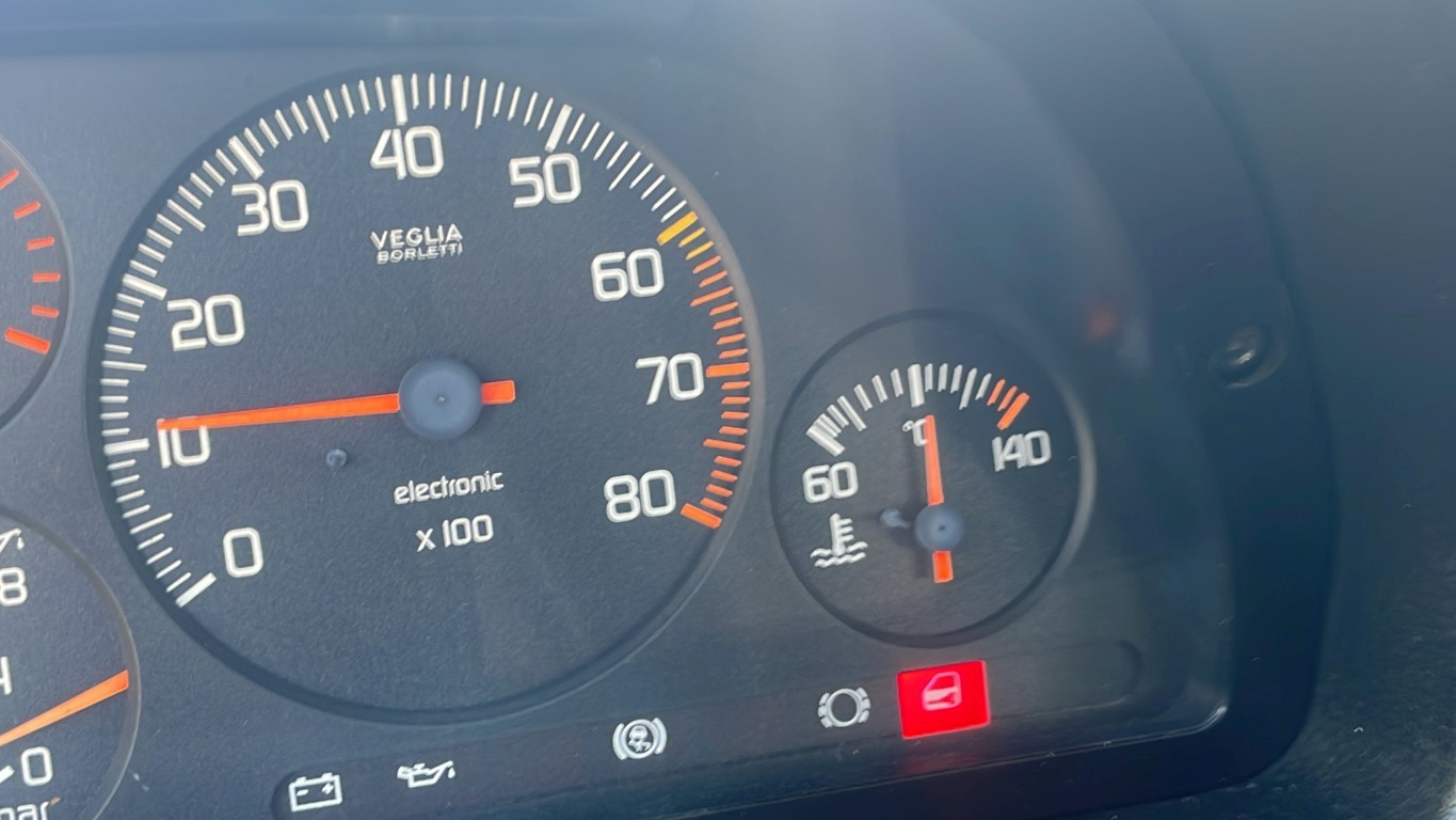

Just a brief update. Overheating is over, apparently. The impeller from the water pump somehow broke loose, and depending on temperature it was more or less noticeable. Anyhow, we made a thin bushing, put a pin through the impeller and shaft and got the car working again. It now works great! Pic shows as high as I got the marker after almost an hour of use.
I am sooooo happy! haha
What it does now, and I can really live with it, is that the temperature needle drops briskly when revving the engine a bit hard. At close to 4500 rpm and under acceleration, the needle drops quickly to about half the regular temperature, shakes a bit, and then comes up again. My mechanic already check on grounds and whatever he could think of.
Oh, well.... old cars. I guess I will have to learn to live with it.
