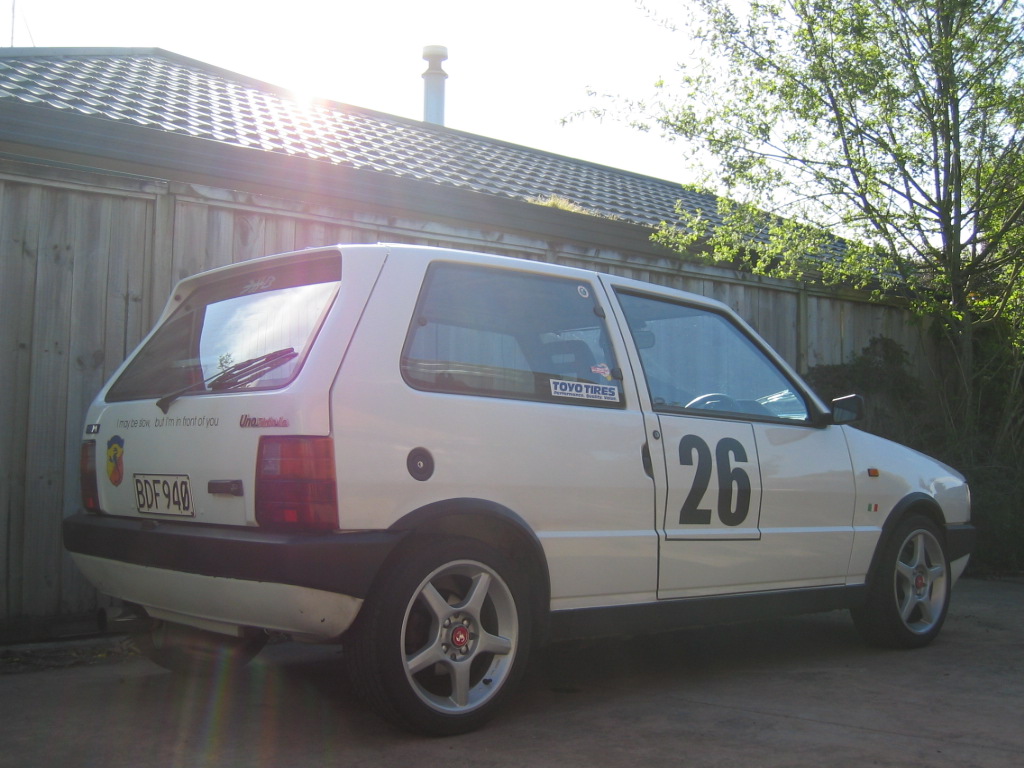

I have 15s on my Uno Turbo. I think it drove better with the 13s on (more grip), but it looks better with the 15s. 7" rim, 195/45 tyres. They have the right rolling diameter (speedo is dead-on) and just clear the wheelarches and gearbox.
Funnily enough all three of my cars (shown below) have 15" wheels - but look at the apparent size differences! On the Punto, the wheels look tiny, like 13s. On the Uno, the wheels look massive, like 17s. On the 164, they look just right (y)
-Alex

The low profile/small sidewalls on my Uno have made the steering feel sharper, but the reality is that (probably due to the heavy wheels and wider, shorter contact patch), I get less grip than before. When it lets go, it's really sudden. There is an increased risk of aquaplaning with wider tyres in the wet. All in all, you have to be vigilant. It also comes down to how new/expensive the tyres are. Old/cheap tyres have hard rubber that makes the problems worse.
-Alex
