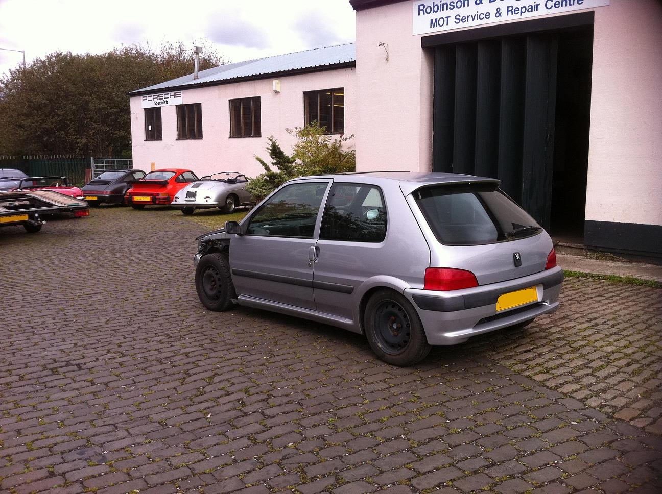

So today i got a big update and a step forward. I drove from Preston, Lancs to Kelso, Scotland to pick up a Silver Gti Rolling Shell. It needs my Engine, Gearbox, Front Brakes, Interior and maybe a few other bits n bobs.
We went in 'The Venga Bus'. A TD5 Defender with Disco Transfer and Few other select mods, absolute monster, and it flys Barely noticed the trailer behind.
So once we arrived i straped up the car and of we went through the scottish country side. Absolutely stunning.
After a few stops along the way......
and 350 miles give or take i ended up home. Gave her a good wash down before it went completely dark....
Tried to get most of the algae, dirt, tree crap and bird crap of the car, going to give it a better wash in the week and also going to remove lots of the panels etc to give it a good going over.

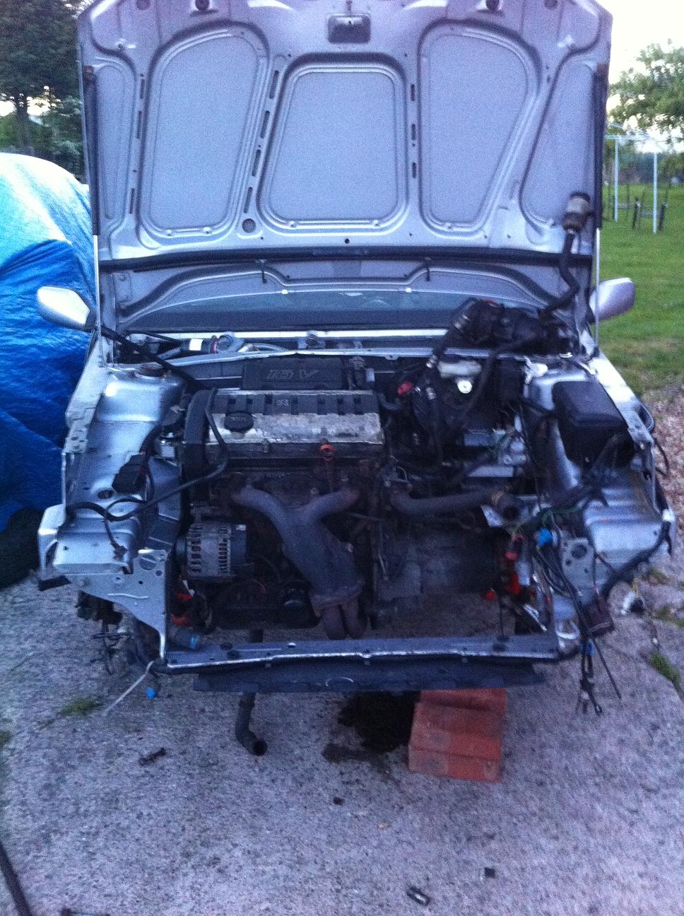

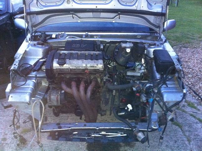

Well i got down to some more work, got some help from a friend which gave me a bit of s hove on the moral side to get more done.
All the cooling pipes connected up apart from rad
Most the electrics connected up (battery still to go)
Power steering connected up, needs fluid still and i also got other little bits n bobs done

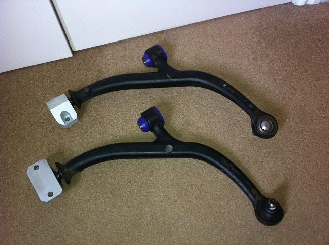

Still got to transfer the brakes over and rebuild the wishbones which i am struggling badly with :(

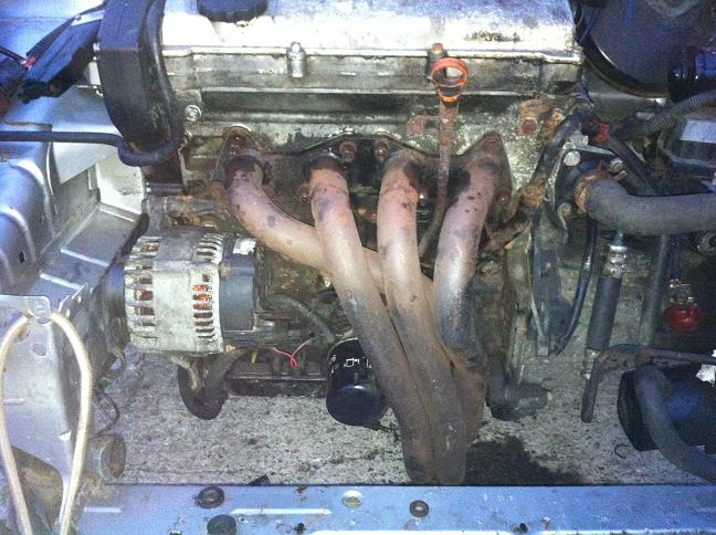

Ohh i also put on my 4-2-1 Manifold & test fitted my Kam Exhaust ;)

Spoox Motorsport Competition Front Wishbone Rear Mounts - Bought
Powerflex Uprated Front Wishbone Front Bushes - Bought

Took the wishbones to a local garage who stripped and rebuilt them for me. They look absolutely awesome.
Got a chance to fit them inbetween the rain as well. Unfortunately the ball joints are slightly out, so need to sort em, anyone got any ideas?

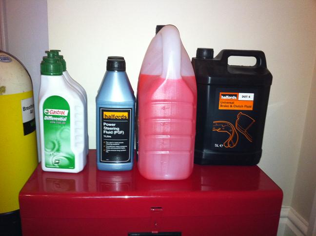

Also been to halfords. The brake fluid is temporary, want to get some race spec stuff in a few months for it!

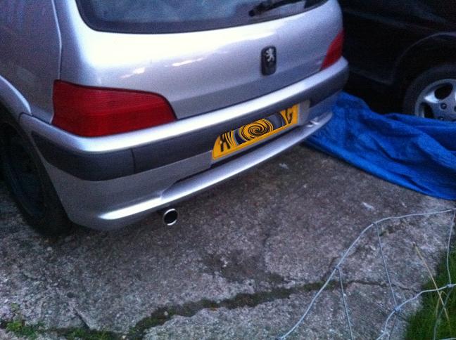

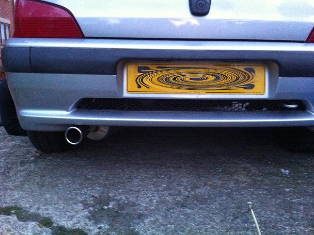

Since the weekend the exhaust has been fitted and finished and most is done apart from the brakes which should be done by the weekend! So hopefully picking it up over the weekend to getit back home :D.
Looking forward to hearing the kam racing exhaust inparticular.... more updates to come....
