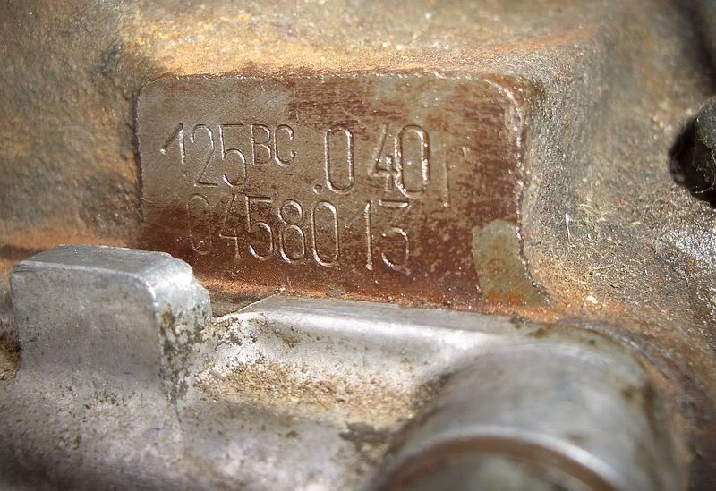

First what is the Engine Series number as this will aid identification. It may be on the chassis plate.:)
