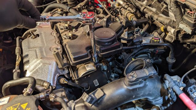

1. Remove the engine beauty cover: 10mm bolts

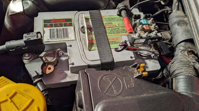

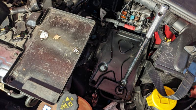

2. Remove the battery: 10mm nuts on terminals and 13mm nut low

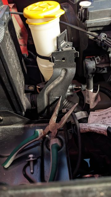

Take out liner and remove13mm bolts securing the battery tray
3. Slip off plastic clips securing washer bottle & negative battery terminal; remove battery tray

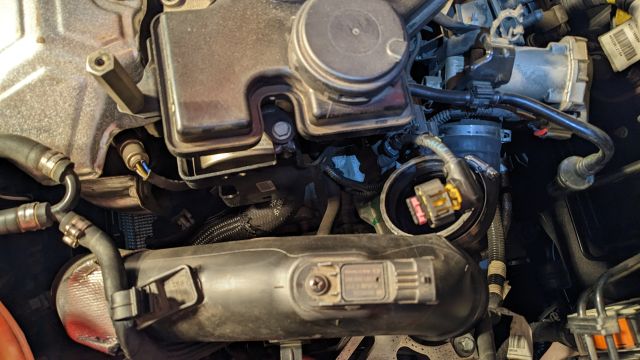

4. Remove the low nut securing rigid pipe (1) in front of the engine.
5. I didn’t need to loosen the lower clamp, but you could if you wanted to disconnect the hose from the rigid air pipe (2) above.
6. Remove the upper rigid pipe bracket fixing screw (1).
7. Disconnect the air pressure sensor electrical connector (1).
8. Loosen the clamp and remove the rigid pipe (2) if you did step #6 above; otherwise just disconnect where this clamp was and push pipe out of the way

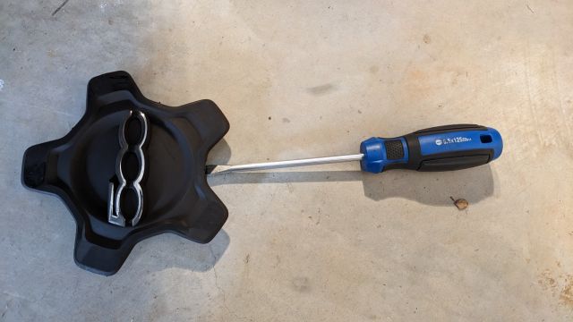

18. Pop off 500X wheel nut cover with flat screwdriver.

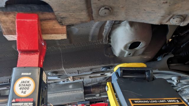

19. Loosen wheel nuts (17mm socket) on air filter side. Chock back wheels. Raise the front of the car. Place on jack stands.

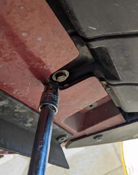

22. Remove the belly pan by undoing four 10mm bolts and 2 Torx T20 screws on the wheel guard under the battery side.

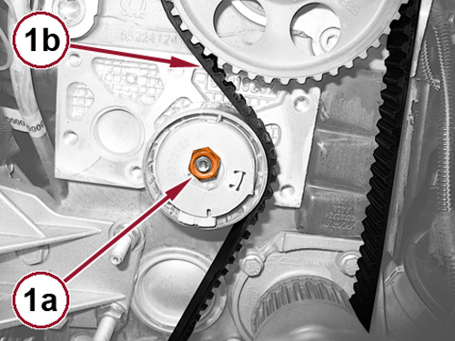

31. Loosen the nut (1a) of the tensioner and remove the timing belt (1b). This is a specialty nut so don’t loose it.

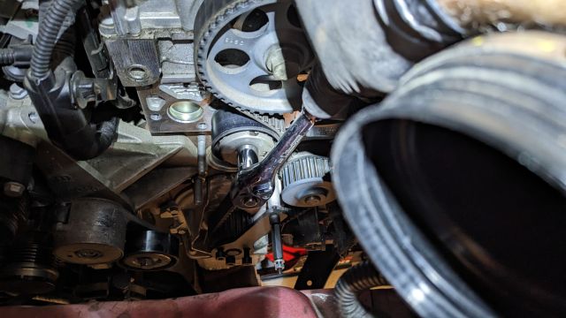

33. Put bucket under the water pump. Undo three 10mm bolts and one 10mm nut. Pull off water pump.
