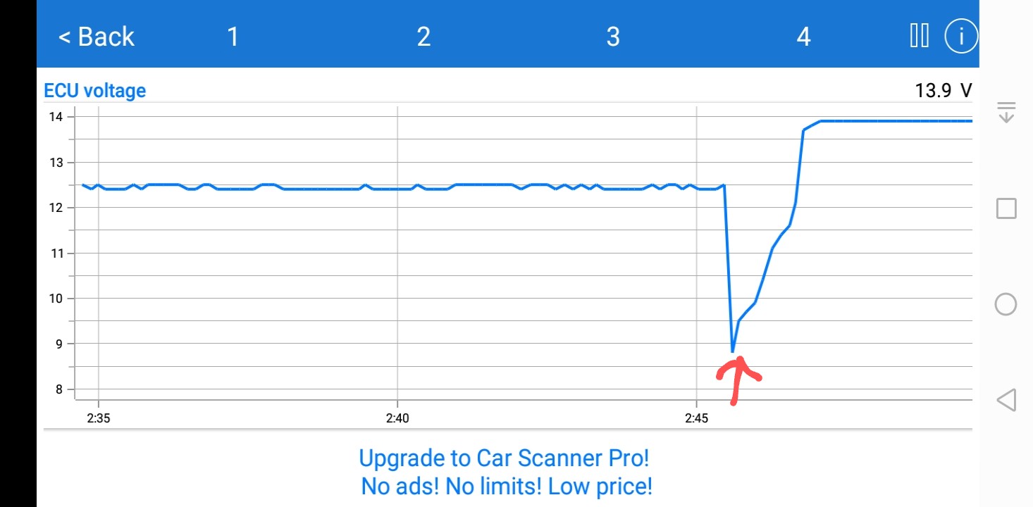

Where (and how) were you measuring the voltage?
Engine ECU via scantool
You can't measure it with a multimeter
Before the starter start turning, it's almost a dead short

What I've learned from that post then is that without enough V 'somewhere' the tacho won't display but the engine will start. You mention that if the BCU sees low V it will reset the clock. Your car will start with no tacho display. You use Scan Tool (?). Will MES give m the same graph?
We have the tacho not moving, and on this occasion the clock has not reset. (Did previously, dying battery).
I can see from the wiring diagram that the ECU and BCU have different paths to the battery. I've never taken the positive battery terminal apart to clean it. That might be giving ok V to the BCU, less to the ECU.
All of that said though, your car starts with low V, ours doesn't.

Yes the BSI fails first at around 6.5V
The ECU fails a little lower, but not much, maybe a volt or so, sensors need 5V
First job, is while it's failing measure the RPM and voltage at the ECU
