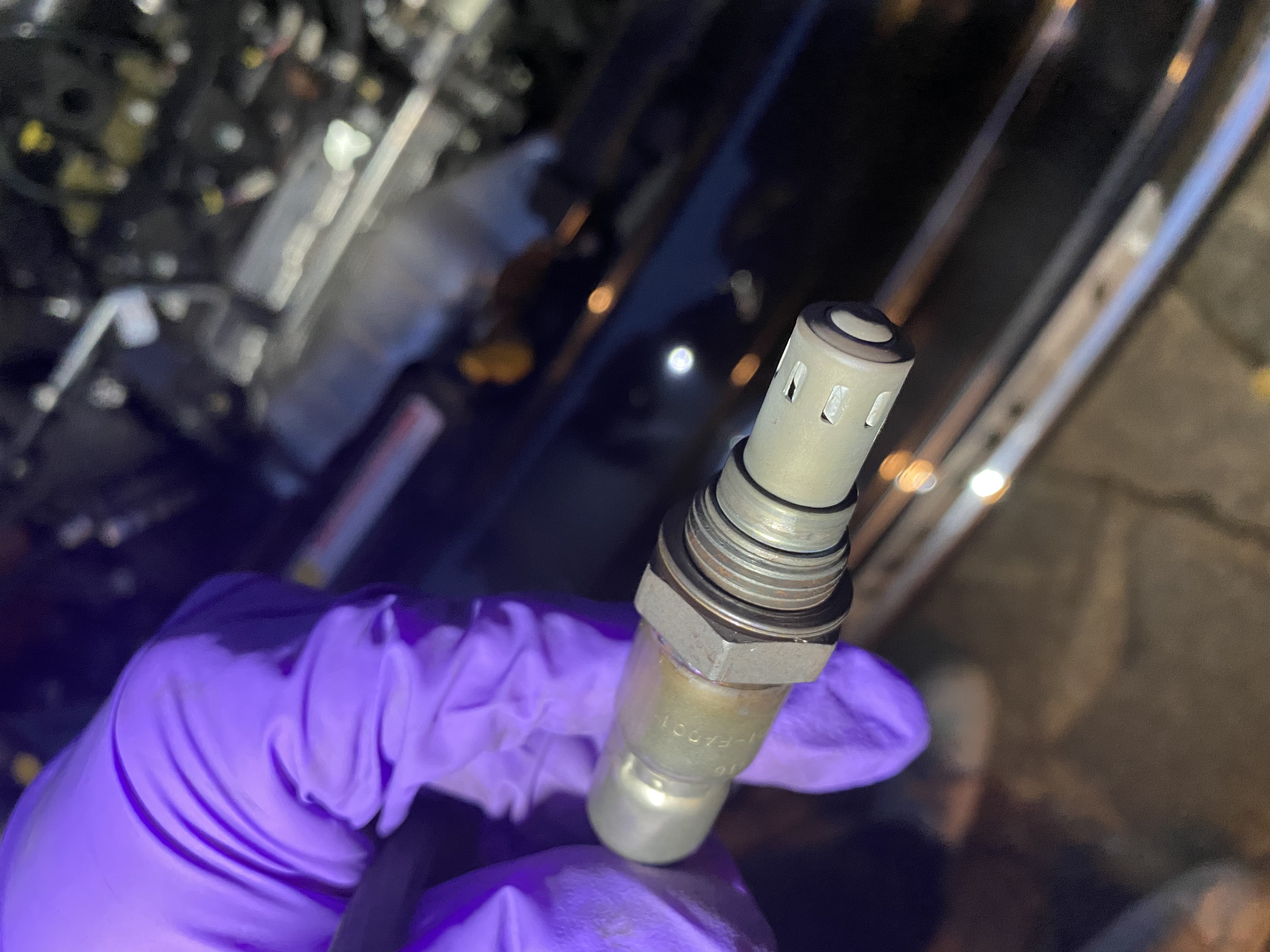

On researching it mentions high omissions due to o2 sensor which I presume is another name for lumber?
I get that some cars are not fuel economic but my Audi TT 245bhp 1.6 done better MPG than this lol
Took the sensor out, should it be this dirty?

At @18k its very similar to our panda.. not yet run in.. so could be tight
A sooty exhaust is caused my too much furl passing through the motor..
This can have several causes :
A bad sensor .. telling the ECU it needs more fuel
A 'cold engine'.. needs more fuel
An air leak.. the sensor sees air .. and adds fuel attempting to maintain the correct Lambda ratio
Get that sensor clean.. brake cleaner spray is ok on the metal dome.. just be careful with the witing.. and make sure it goes in tight.. you need an airtight seal ;)

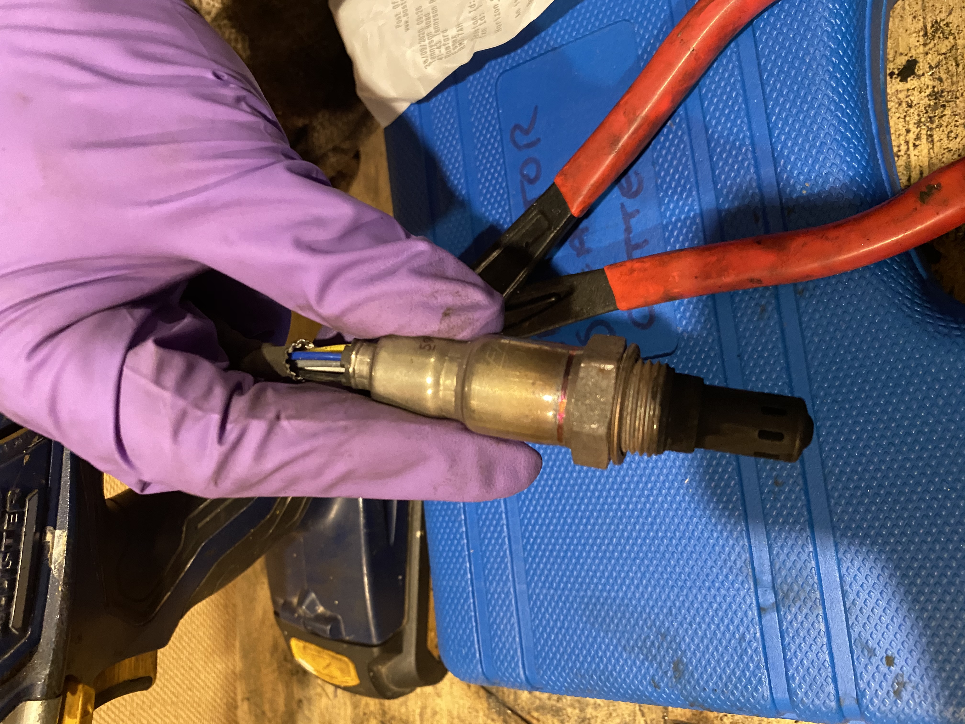

His gave it a clean... and I have just screen shot and sent it to him what you posted above ? I started it up and it runs lol, I’ll soon find out on my way into work tomorrow morning? Lol

It’s all been reset as the battery was taken out to un clip the sensor. This morning on my way into work the average MPG was flicking between 27MP to the 60MPG.... once it’s levelled off will be interesting to see if a clean has made a difference, and work out if there is another issue to cause it to over fuel - I’m hoping this has done the trick ?*♀️
Thought I would give an update so far since the sensor has been clean. It’s showing around 46.6MPG and so far got 157 miles to half a tank of petrol!!
