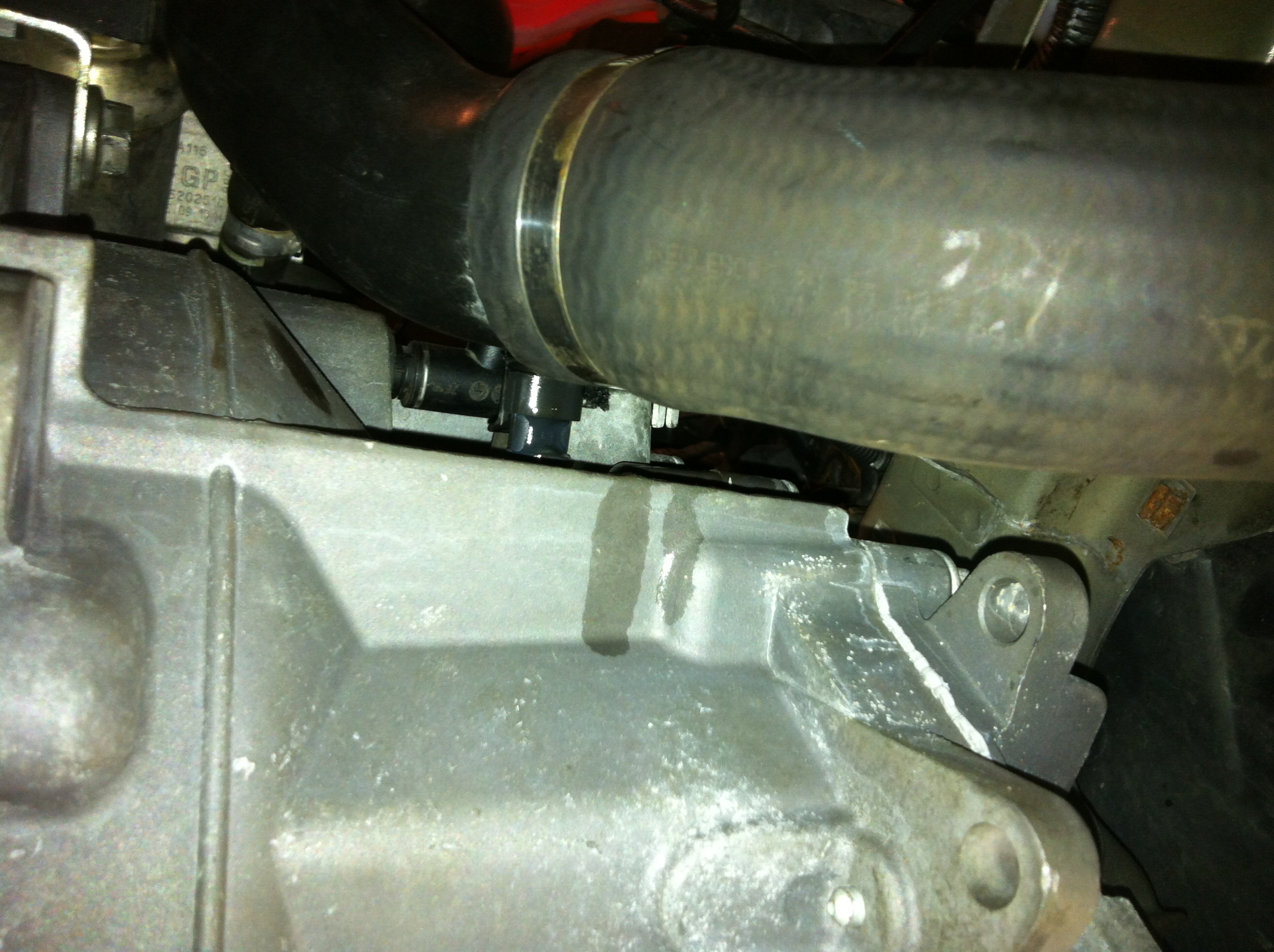

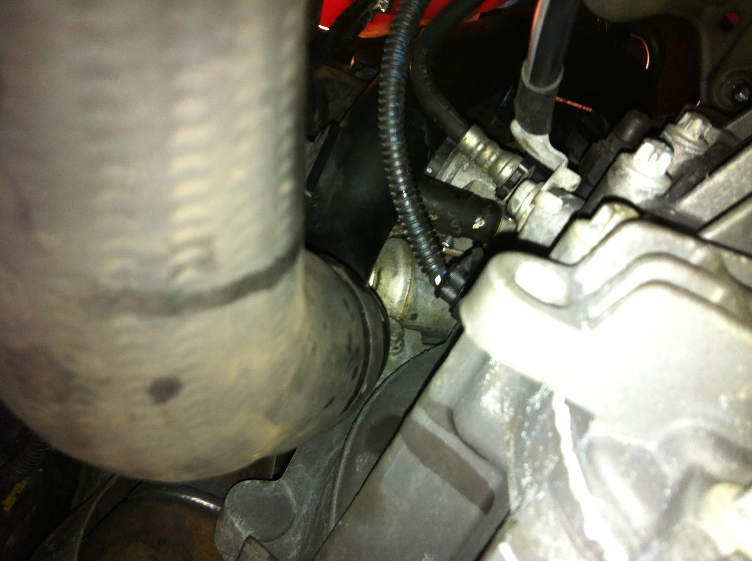

When you look up you can see the reverse switch on the front of the gearbox. It's in an awfull place behind the intercooler pipe.
I removed the intercooler pipe to get to it.

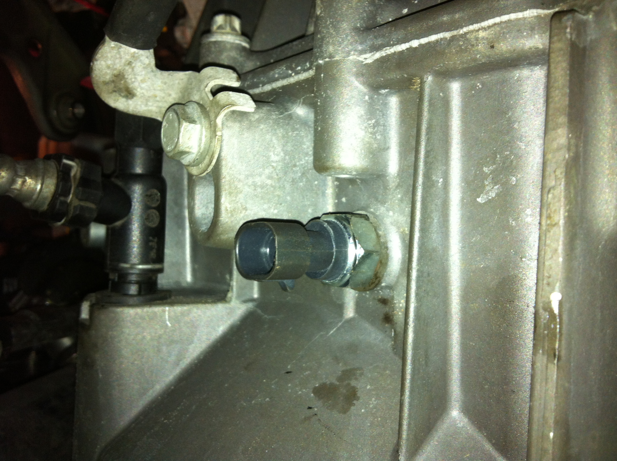

Remove the old sensor
Unplug the plug and remove the old sensor.
Mine was original and I had to use a 22mm wrench.

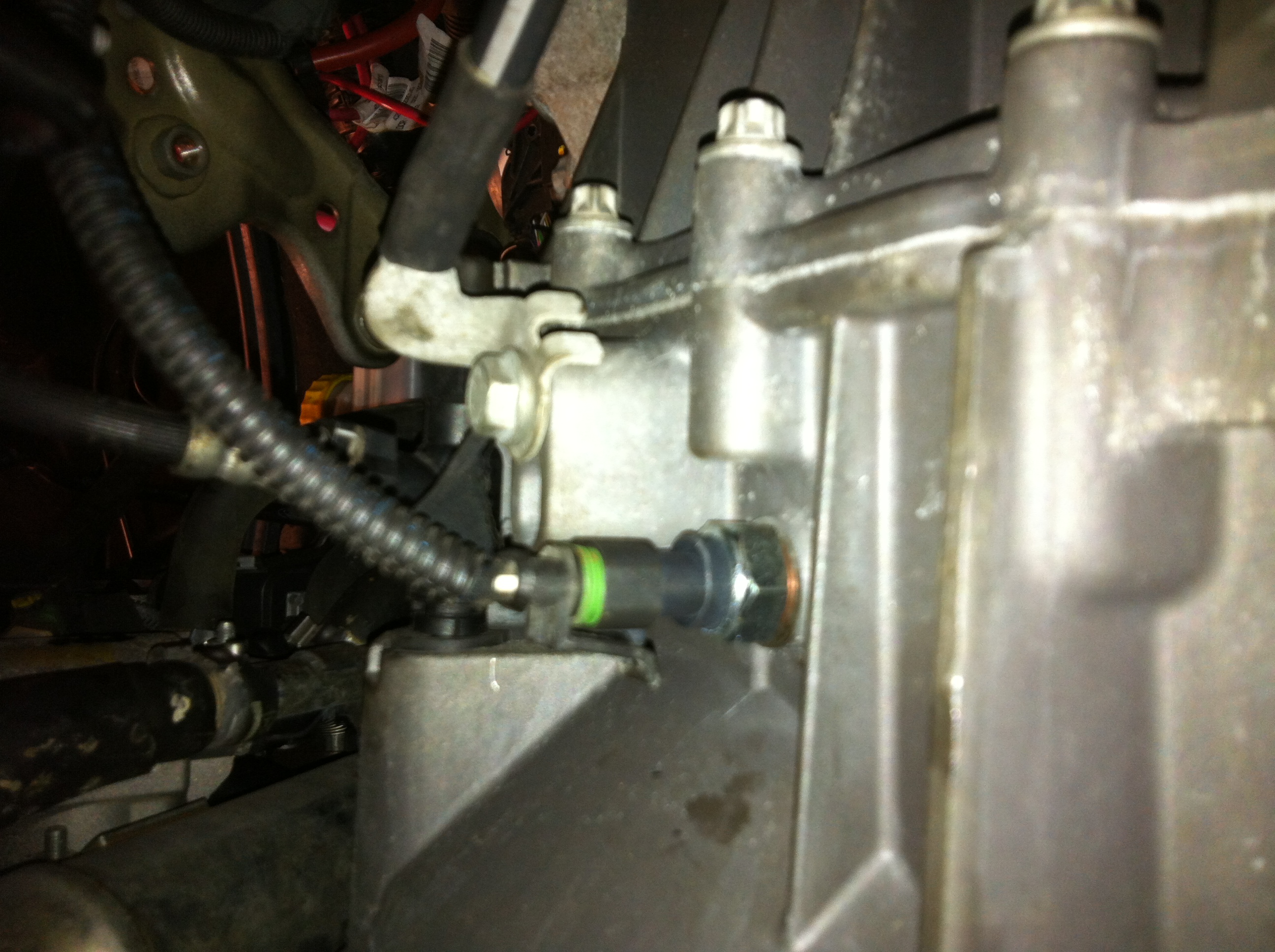

After that place the new sensor, the new one I had needed a 19mm wrench.
Apply some electronic spray and plug the cable.

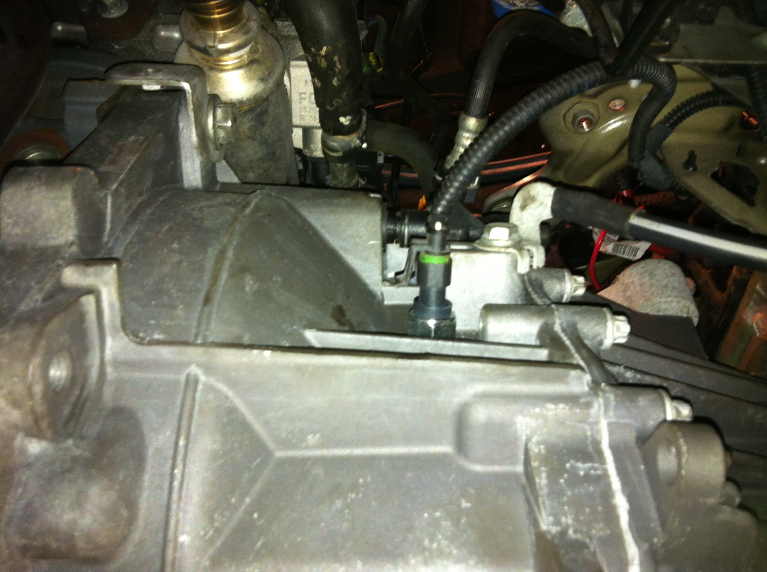

Finished
Put the intercooler pipe back in place and put the tray back underneath the engine.
And your done.
Check if your systems work.
If you had a fault it probably has to be cleared before verything works.
