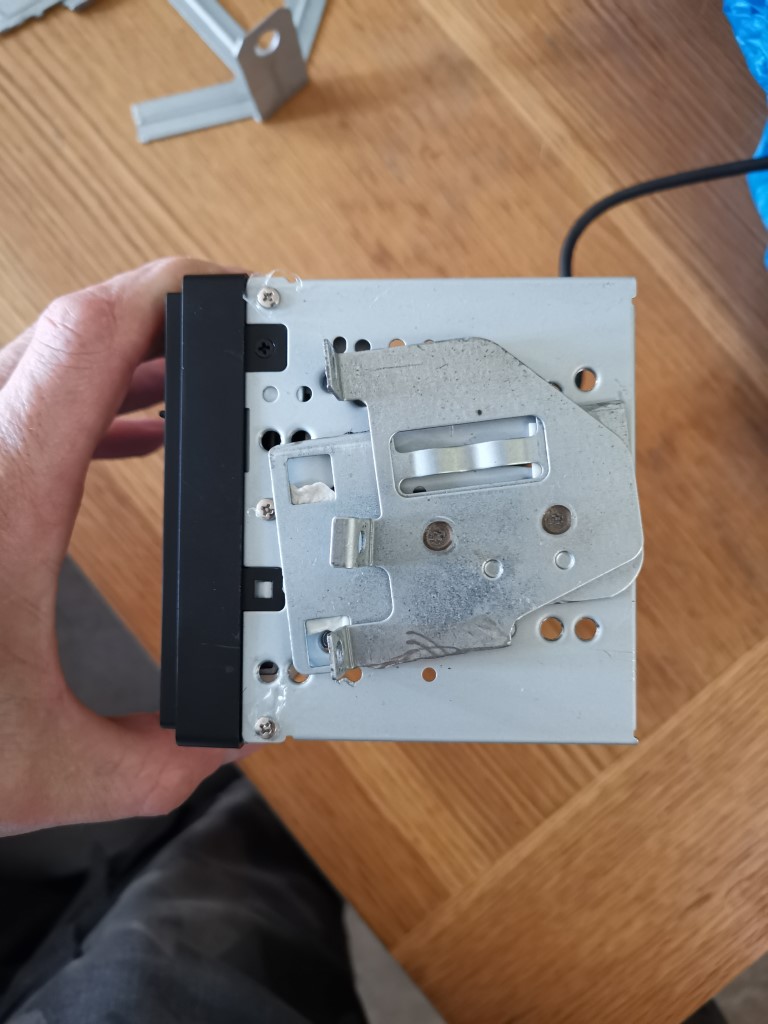

The main issue was holding the unit in the dash, a quick search online suggested that Chinese Headunits such as the ATOTO are not the same size as "proper" Double Din Units, and so there were no guarantee of fitting properly.
So, my solution was to "modify" the OEM cage and use the mounting locations from the original stereo.
By "modify" I mean hack off all the bits apart from the mounting plates that screwed into the dash.
Then, using some mounting foam pads, I trail fitted the position of the plates and offered the unit into the dash, this was a lengthy process of trail and error, but we got there. Once I was happy, I clamped the plates together with vice grip pliers and drilled holes for blots to mount it securely.
Bolts fitted and tightened.
Thankfully nothing moved and it fitted like the OEM stereo with the 4 screws. It is really solid.
