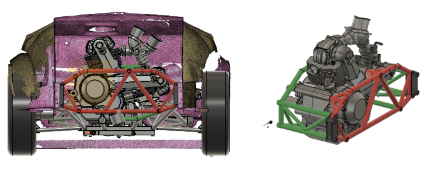

Engine Frame
I ended up redesigning to engine frame, adjusting the position of the engine so I don't need a belt tensioner and modifying the frame so I have access to the engine bolts on either side of the rear panel. New parts were designed and printed to verify measurements on the engine and the Fiat's frame, then I had the tubes laser cut and routed out a tacking jig. Once I was happy with how everything fit, I welded it out and cross my fingers. It fit!
Overall, I'm pretty happy with this aesthetic of this frame and how it pays tribute to the classic Ducati trellis frames! I still need to finish welding out the frame, add the last engine mount, gusset everything, oh and build the rest of the engine frame, but this rear section, making sure everything lined up between Fiat's frame and the Ducati's engine mounts was the highest risk. Glad this all seems to fit up nicely.

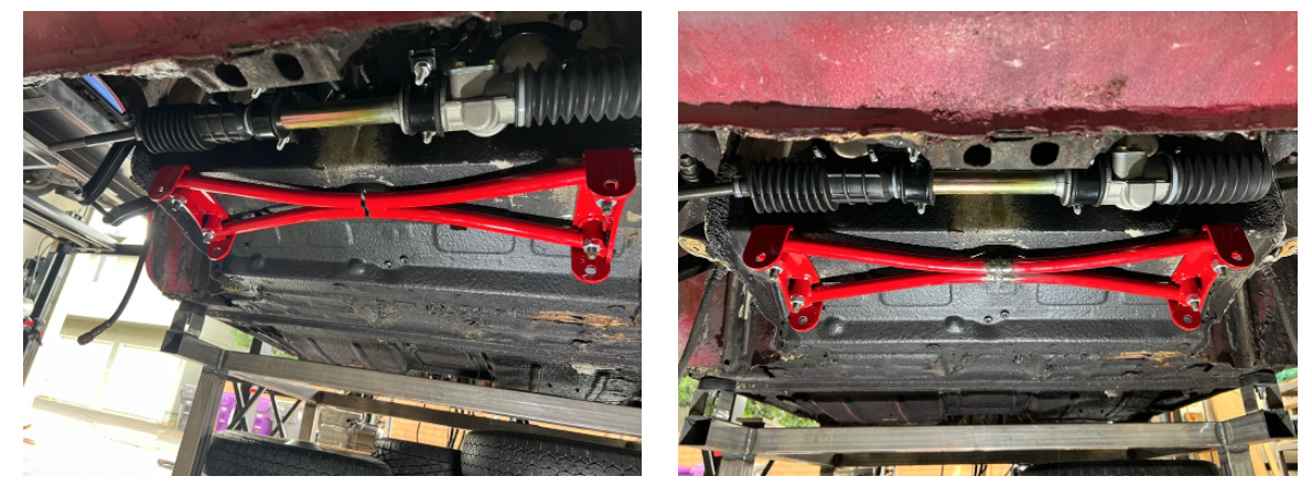

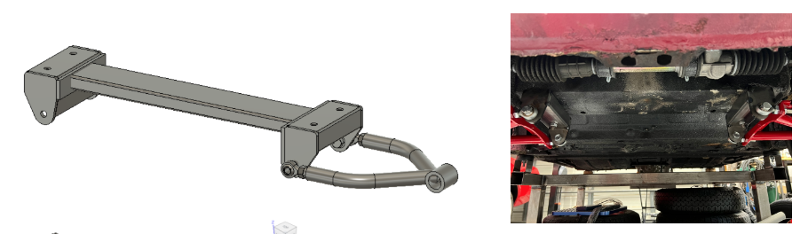

Last time I realized that there had been some funky front end repair work that resulted in my suspension mounts being off. Upon further investigation, it does appear that the driver suspension points are shifted about 1/4" to the outside, when compared to the passenger. I tried to take this difference up with shimming and adjusting the control arms, but although I could get the static alignment correct, the camber changes were very different between the two sides. Also, I wasn't super happy with the design of those control arms and that they contact the support frame under full bump, SO, I've decided to make a new suspension mounting structure, lower control arms, and modify the upper control arms to fit the bigger tires with this messed up body. :oops:
I made asymmetric lower mounts to correct for the difference in mounting positions and to allow for lower and longer lower control arms, give me a better roll center height and camber control for the new wheel size. The lower structure is pretty simple, so I can remake that once I fix the suspension mounts.
Mounting the coil overs to the wheel well gave me some concern, so I built a test rig to see how much load I could put into the shock tower before yielding the structure. I got up to 800 lbF with less than .015" of deflection and decided it shouldn't be a problem keeping the stock structure as is without added re-enforcement. Also, the MrFiat coilovers didn't seem to be of the best quality and were limiting my total droop travel, so I ordered some GAZ shocks. Excited to see the difference!
I also finished up the steering, modification of the brake pedal for clearance, and added a spacer to the pedal assembly to give the master cylinder a bit more room.

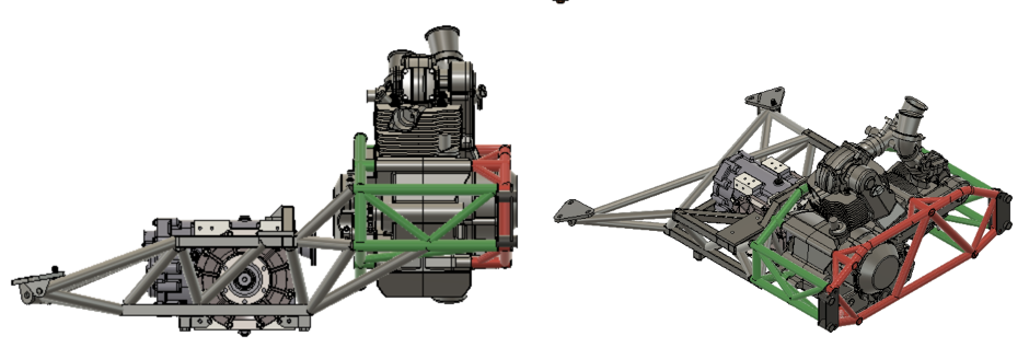

The Elite MX200 differential/reversing gearbox arrived so I built a simple jig to hold the engine and diff with respect to each other so I could put it in the car and make sure everything lined up the way I had hopped. As expected, I needed to change things around a bit to ensure I had acceptable CV angles, spacing between the engine and differential for the correct belt length, and to make sure I had good clearance to the engine lid (decided I want the option to keep the engine completely concealed)

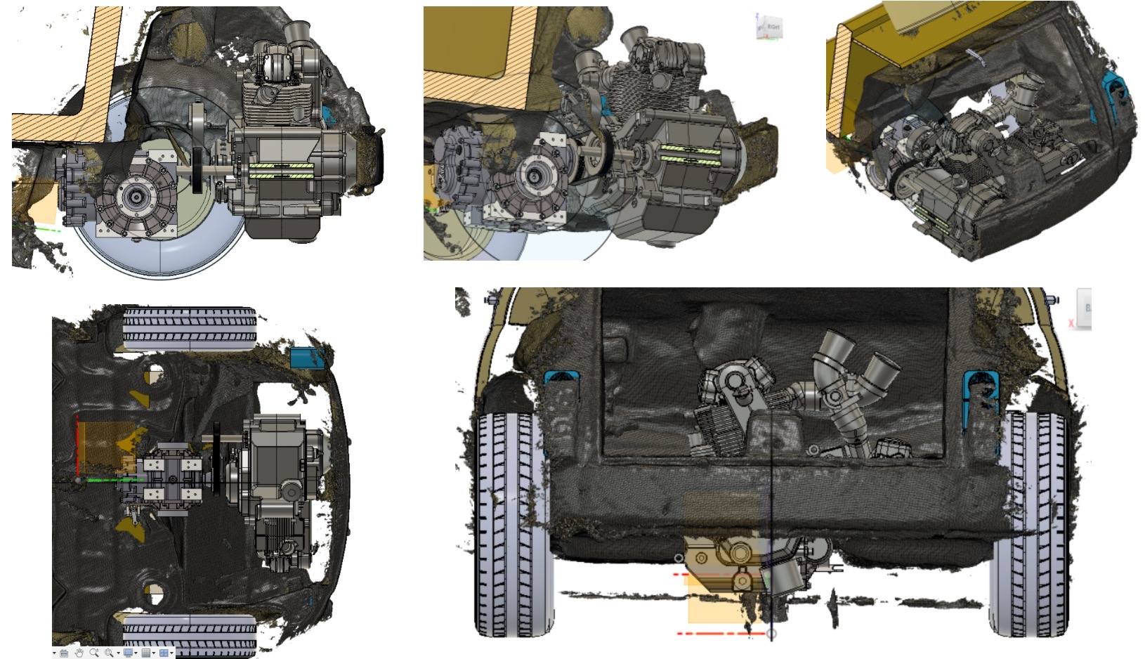

After I was happy with the rough position of everything, it was time for another scan and to get heavy into the design work.
The frame needed to connect to the vehicle at 4 points: two forward lower swing arm mounts, and the two rear engine panel mounts. The frame not only needed to hold the engine, differential, and belt drive assembly, but it also needed to contain my suspension mounting locations, and look cool!
I started with the engine portion of the frame. With the motor being lifted from a Ducati, I wanted to retain the same "trellis" look of those bikes. I also wanted to have the option to run this car without the engine lid and panel, primarily help evacuate heat out of the engine bay during aggressive driving events, but also to look awesome. The frame is actually two parts (shown in green and red) that way the engine can actually be removed without cutting it out of the frame!
Next was to figure out the frame around the diff, and suspension pickup points. After doing some quick and dirty suspension sketches, I realized I could package a double wishbone suspension, which I used to set my nodal constraints. Then it was a matter of connecting the dots in a side/elevation view, then in bottom/top/plan view. I wanted to give the diff some adjustment since hitting the two drive axis will be extremely important, so I have incorporated slots and shims accordingly.
After I was fairly happy with that design, it was time to tie everything together, adjust, repeat! After quite a few iterations, I ended up with a design that I can make work. I've now ordered the laser jet sheet metal parts tubing so hopefully I can start fabricating next week!

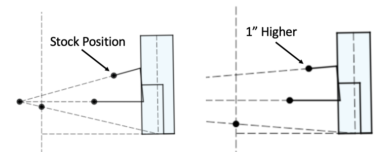

I was happy with the geometry of this setup, especially compared to stock, but after playing around with the geometry in CAD, I realized it can really benefit from a higher inboard upper ball joint mount, resulting in much less camber change, a longer instant center, and therefore a lower roll center height. So, I'll probably also add these suspension relocation brackets, since it should help the suspension even more.

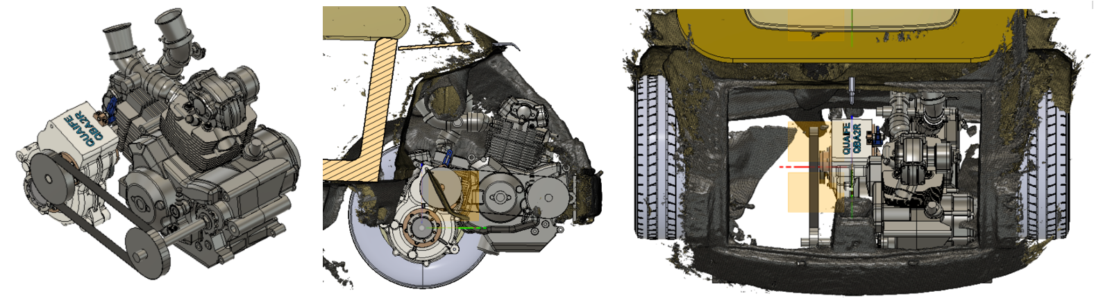

I started to weigh the pros and cons of each solution, moving things around in CAD to see what packaged the best, making some wood templates to check fit and even buying a blown motor to put in the car and see what would actually work. After a pseudo–Design Review with my buddies, we decided that the Elite differential gave me the most options, packaged the best (especially from a chassis design side) and would deliver on the aesthetics potential of the engine bay.
So, there you go, I ordered the Elite option, which should hopefully arrive in January. In the meantime, I can focus on the front suspension, tearing down the donor bike, and designing the rear frame!

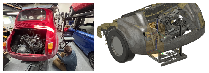

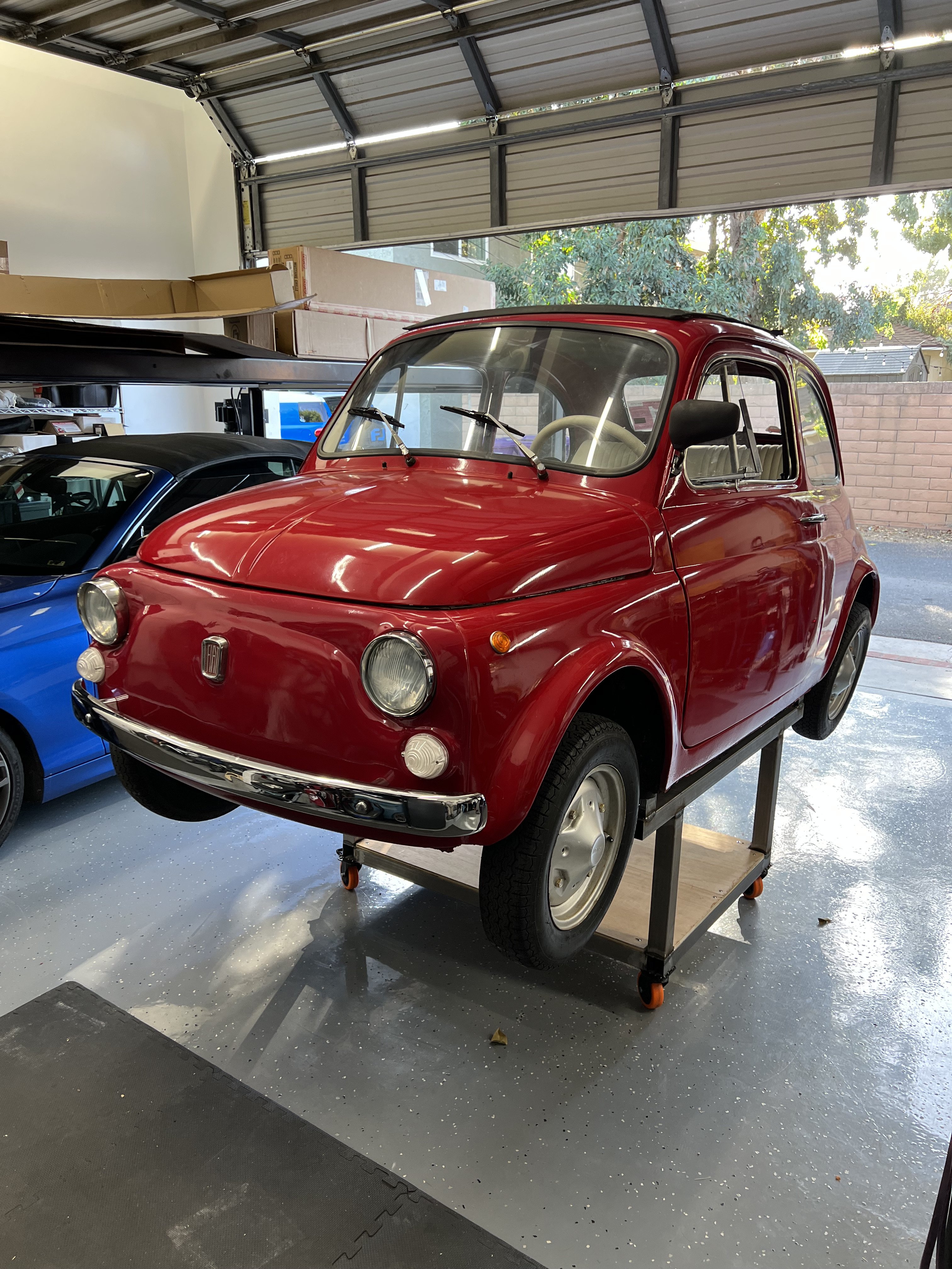

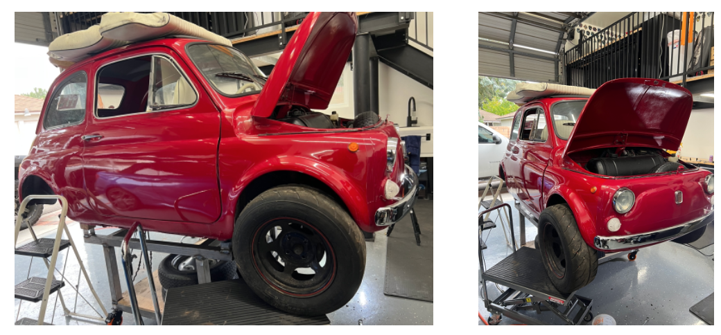

Before I started teardown, I needed to make a cart for the car. This would allow me to move the body around the garage and elevate the car enough to work under. However, I couldn't go too tall, or I wouldn't be able to get the car under the mezzanine. After a few measurements, I ordered some Amazon bits, picked up some steel, and whipped up this little guy.
I measured corner-weights with and without me so I would have a good baseline for the project and something to keep in mind as I was adding and removing components. Then it was time to lift the car onto the cart, which totally was not sketchy or scary at all.

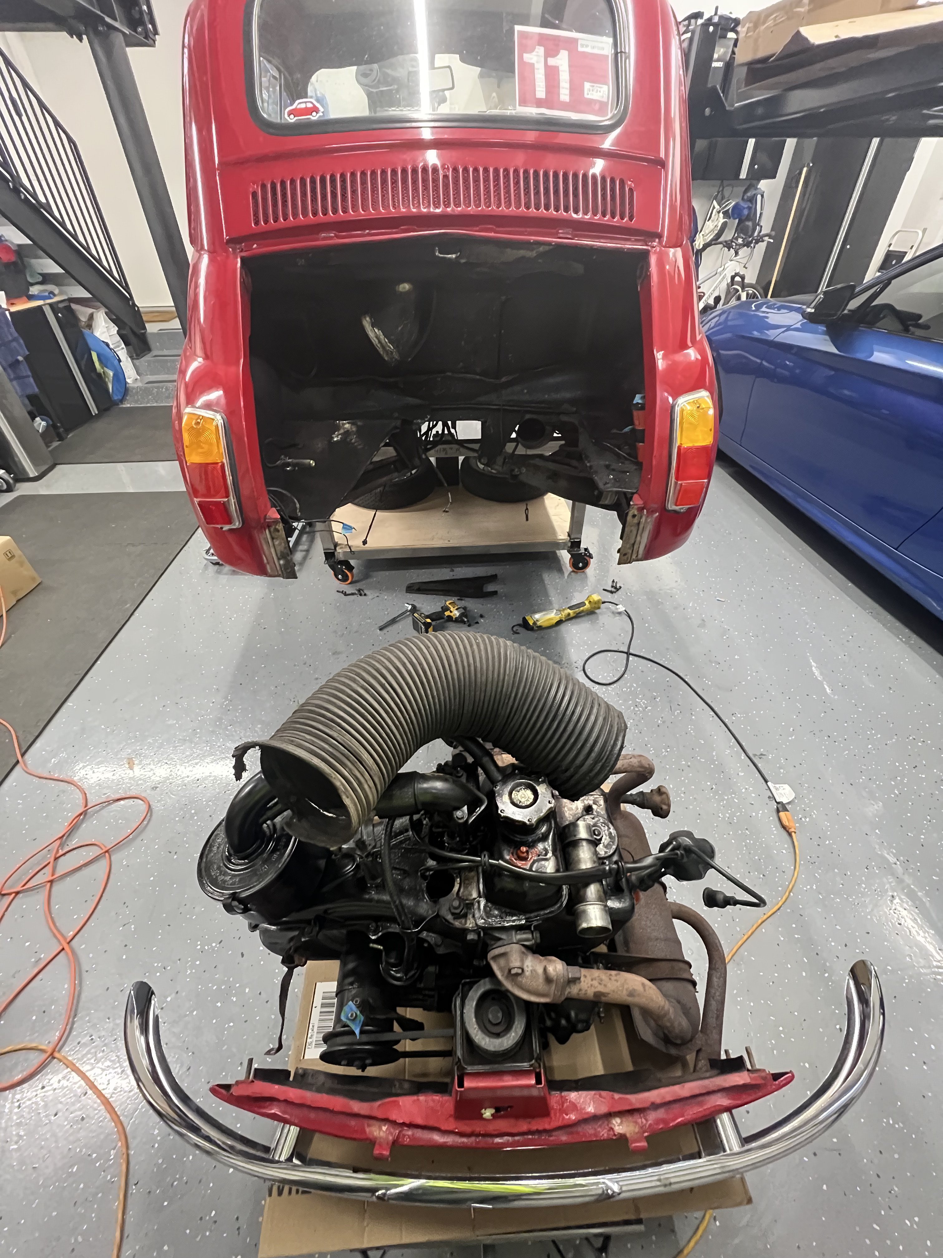

With Francesca on her new set of legs, it was time to remove the engine and suspension

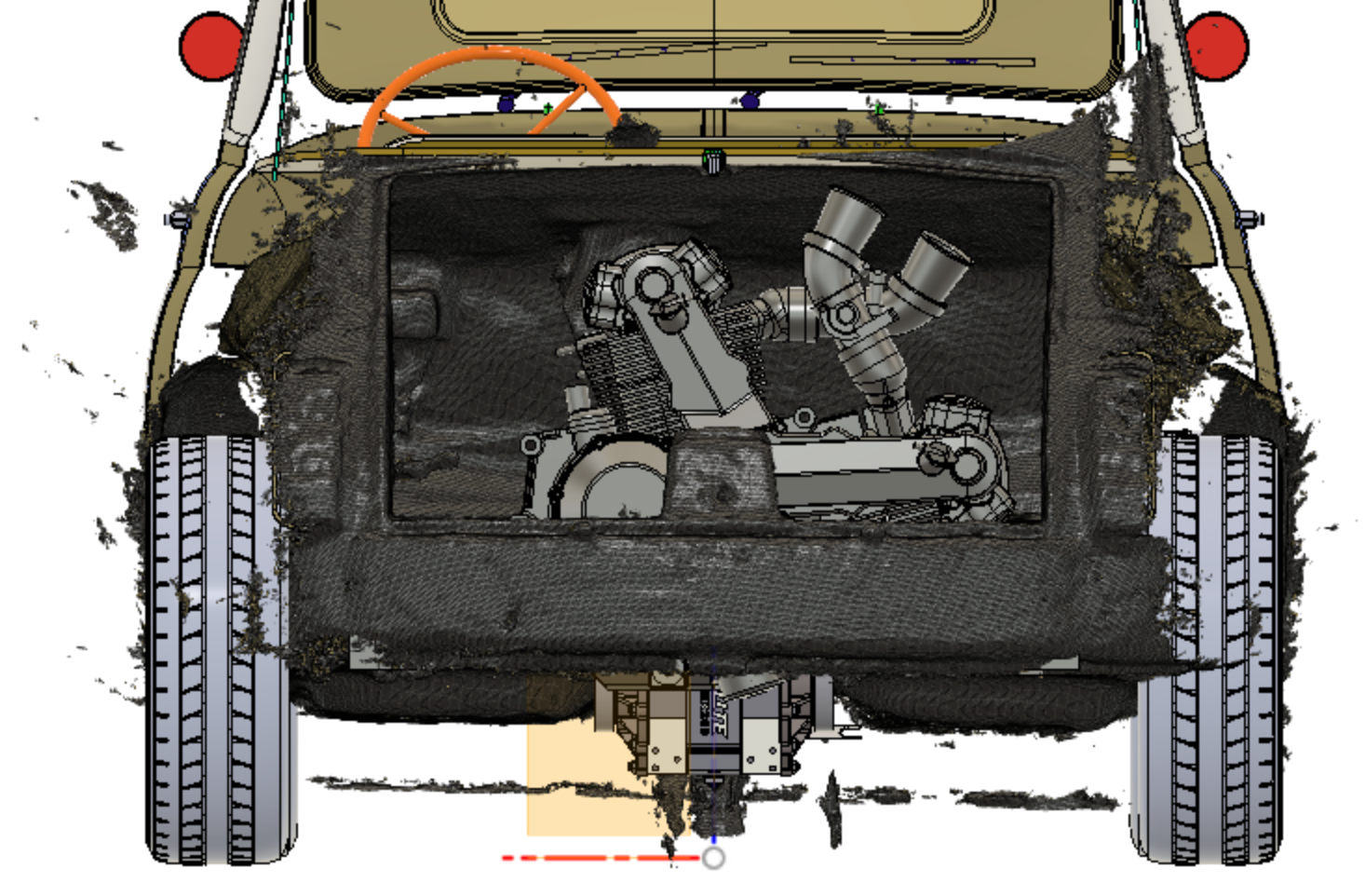

With all the major components out of the way, I had a buddy come over to 3D scan the engine compartment so I could start trying to figure out how I would package the motor.
Now the design work can begin!
