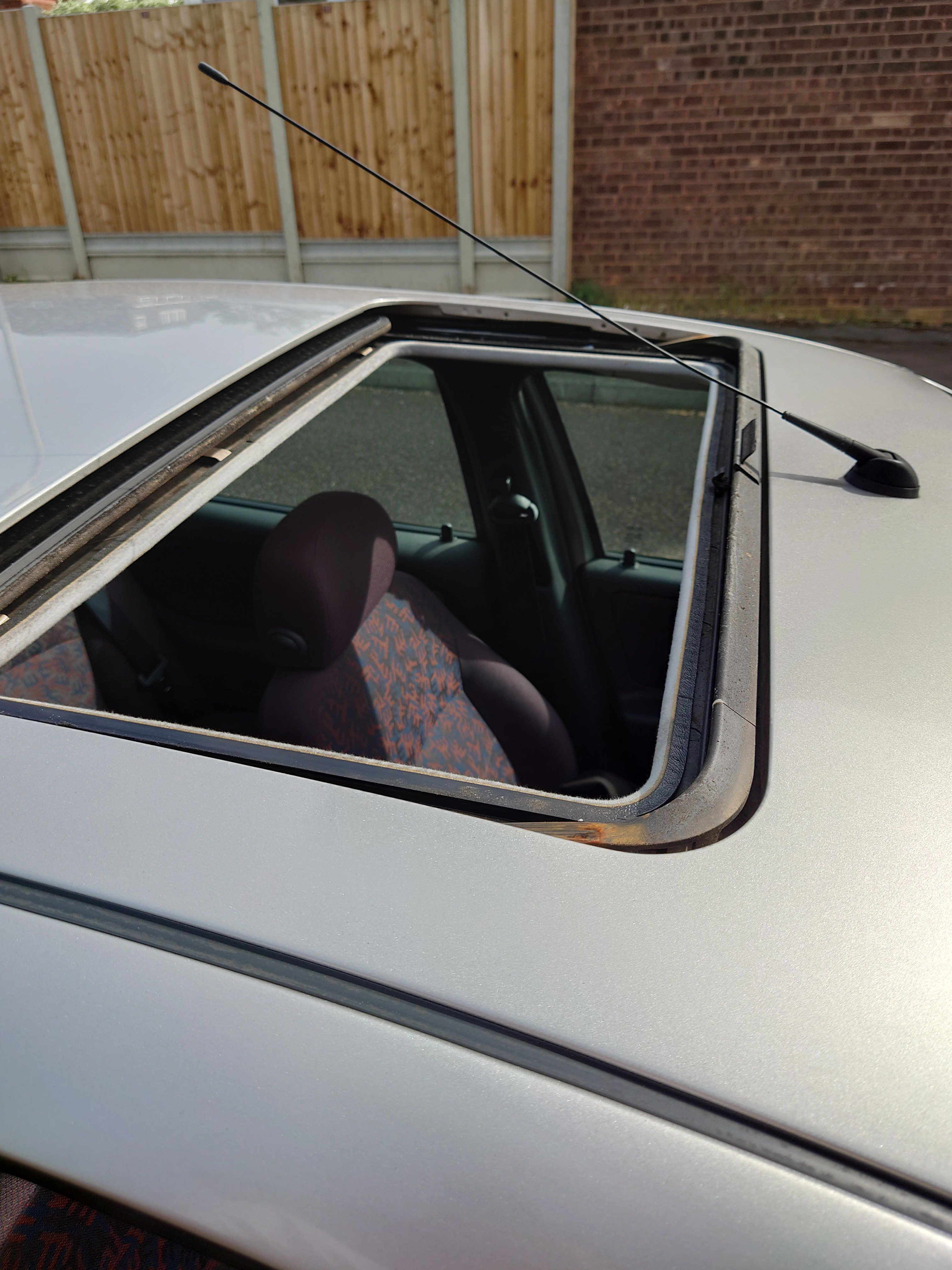

Finally managed to sort my sunroof, lots of silicon grease forced into the runners followed by copious amounts of rocking it back and forth on the motor until it eventually agreed to open, its been flawless since!
In exchange for having a working sunroof the wipers no longer park at all, so I have no intermittent function and I have to carefully time when I turn them off... its not convenient...

Secondly on trying to inspect my sunroof leak I found it doesn't open anyway, it tilts up no problem and it will tilt downwards ready to slide back but it doesn't budge even a millimetre after 'squatting' down, there's no motor noise or relay clicking so it doesn't seem likes it even attempting to move further.

Sunroof still leaks so seems it was not the aerial, I don't really want to silicone it shut so I will need to look more closely at it.
