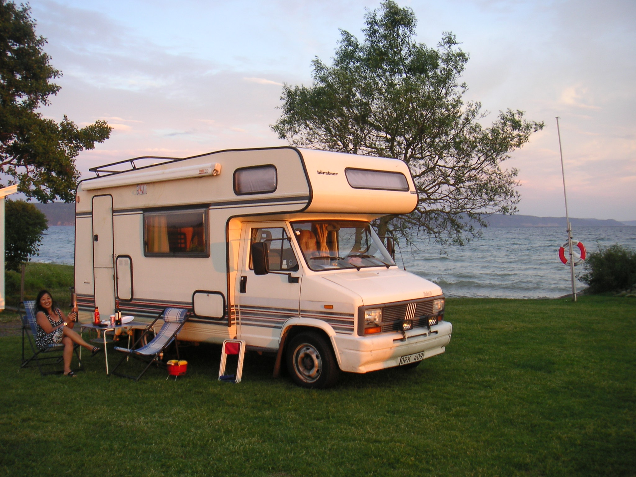

- Intercooler added to the right of the radiator using custom piping.
- 5th gear ratio increased to 45/33 gear (+5% ratio from original 43/33)
- Huge solar panel on the roof 2x260W. Epever MPPT charger.
- 2x6V 240Ah battery mounted under passenger seat, serving both as starter and camping power source.
- Original gas fridge replaced with 130l 12V Vitrifrigo C130 fridge with 20l freezer box
- Stainless wheel sides
- LED strip for exterior light
- Roof hatch replaced with one with integrated fan, with thermostat.
- Super-silent 12V fan installed under sleeping compartment roof vent.
